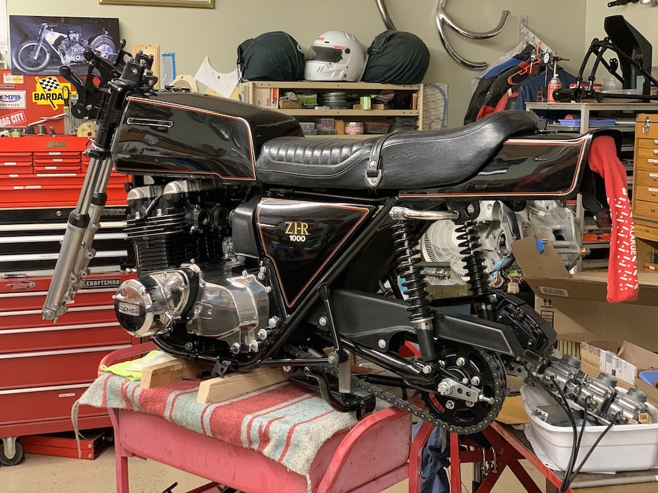

A little bit of pre-assembly.

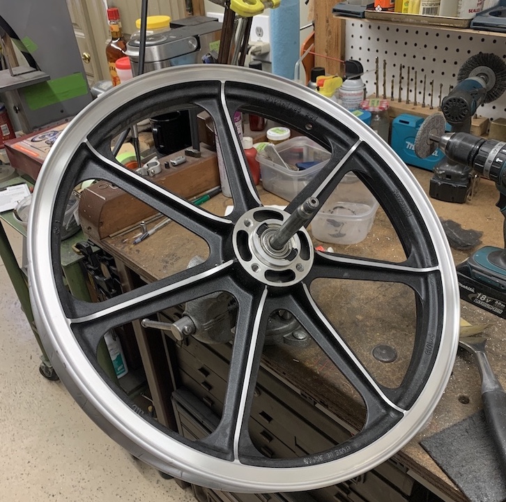

I had a heck of a time getting the old Michelin tire off the rim then spent some time cleaning, polishing and coating the polished areas with ShineSEAL which should keep them looking nice.

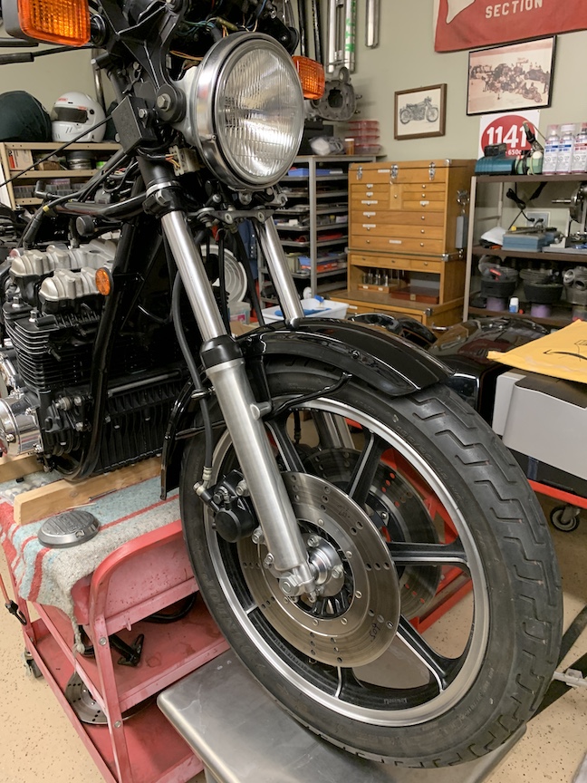

Spent some time rebuilding the forks just to be on the 'clean' side of things. When it came time to install the front wheel, it wouldn't go. I thought 'here we go again, bent triple trees or bent forks. I removed the lower tubes and measured between the upper tubes at the tree and again at the bottom and the difference was less than .007". I loosened each fork tube and rotated them until the difference was .003". I reassembled the forks but the wheel was still .080" too wide to fit correctly. No help after doing a bit of research so I removed .080" off the spacer and it's finished.
Front wh.JPG (283.32 KiB) Viewed 75213 times
I finally installed the fairing thought I was finished with the front end only to find the headlight doesn't light up. Here we go...again. ;)

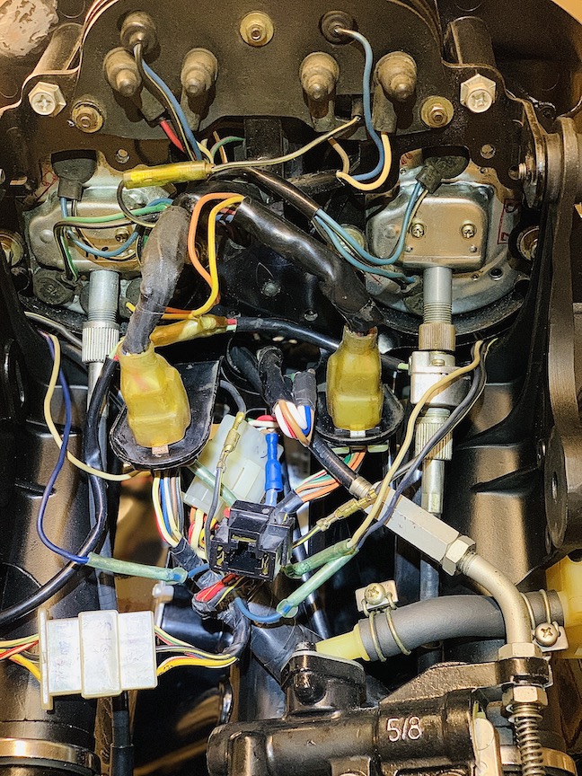

Well that wasn't so bad. With the fairing off again I found a loose connection. I'm amazed it all works as well as it does.

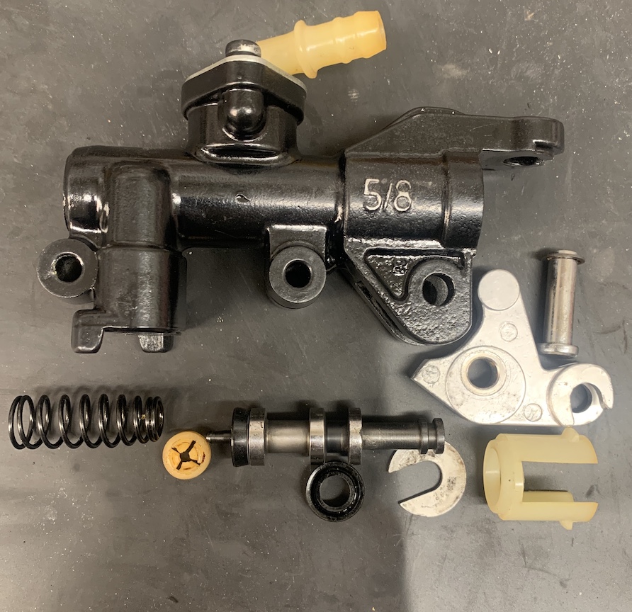

The brake bleeding didn't go so well. After a couple of attempts I started again checking the master cylinder for blockage. This master cylinder was a one year only for the Z1Rs and corrosion has destroyed most of them. I bored and sleeved it back to size but couldn't find a rebuild kit so used the cups from a kit that was similar. As it turns out I drilled the larger hole from the reservoir to the piston but failed to drill the .020" hole in front of the pressure cup. That did the trick and the brakes now work great.

Glad you found the loose connector. Especially older bikes connectors are usually first thing I inspect. But with all of those…
Curious if you bored the master with mill or lathe. Seems could be easier to hold in the mill?
Posts: 649
Re: Z1R BUILD
Postby John H » Sun Dec 15, 2024 2:01 pm
Both master cylinders were bored in the mill. The sleeve was a snug fit as I didn't want brake fluid going around it causing a leak.

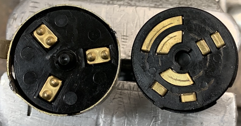

Postby John H » Thu Jan 09, 2025 9:35 pm
The headlamp started working intermittently and finally stopped completely. I kept thinking it was a connection but eventually it turned out to be the ignition switch. It had two contacts that were worn such that they were making contact on the bakelite body instead of the brass. I found a used one on ebay but decided to work with what I have. I may eventually find an oem replacement.
