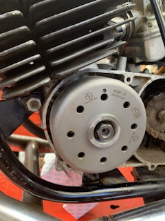

Postby Lotus54 » Thu May 09, 2024 6:44 am
New flywheel/stator mounted and timed
Posts: 640
Re: Benelli 250 2C
Postby John H » Thu May 09, 2024 9:07 pm
Interesting that some other bikes attached these rotors without a key. The Z1R is the same and it causes real problems as the starter clutch bolts to the rotor.
