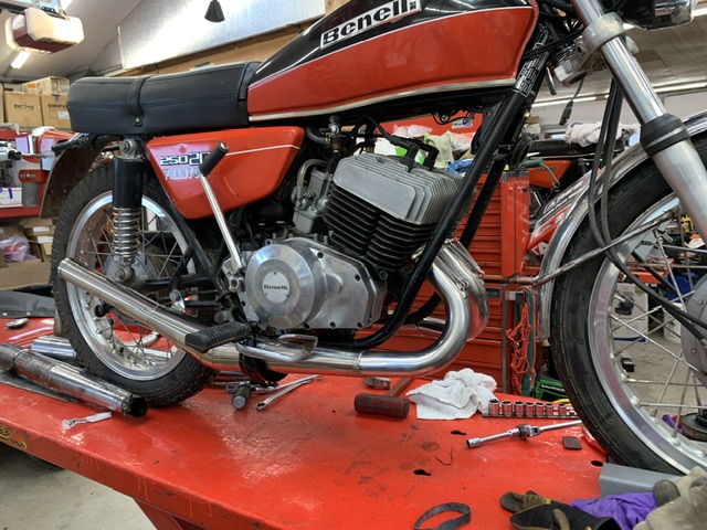

Postby Lotus54 » Fri Apr 12, 2024 10:25 am
Foolishly blew $$ on some new exhaust pipes.
Louder than stock, but not too loud. Sure look nice! I have not had a chance to ride it more than around the block to see how they perform.
