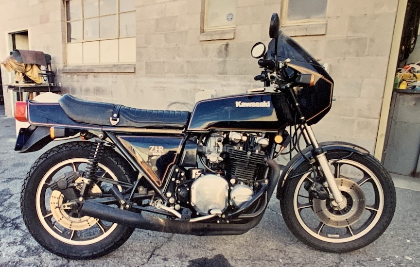

After 33 years it's time to give my 78 Z1R a new life. It's not going to be a 10 restoration but will be nicely done up when it's finished. Not much to explain but will try to make it interesting for those who enjoyed the Kawasaki 4's. My first of several was a 72. Probably the last will be this Z1R. So here we go. :D

I didn't think much about all the different versions of the Z1R when I purchased this one, so after searching for brake rebuilding kits I find that there were several versions. Starting in late 77 with the 1978 Z1R D1 model there were several minor parts variations. Some changes were to improve the bike while others were requirements to meet vehicle standards of other countries. Of course, the most popular of all was the 78 silver model. By 79 the Z1R emission std' required a new head and air box along with a choice of Ebony black paint. Another change was a 19" front wheel which improved handling.
As it turns out, My bike is titled as a 78. The motor has not id stamped numbers and the paint schemes is 1979 Ebony 'black'.
Well, you can see where I'm going with this build. It may be some kind of a transition bike, then again it may just be a bitsa bike. We'll see.

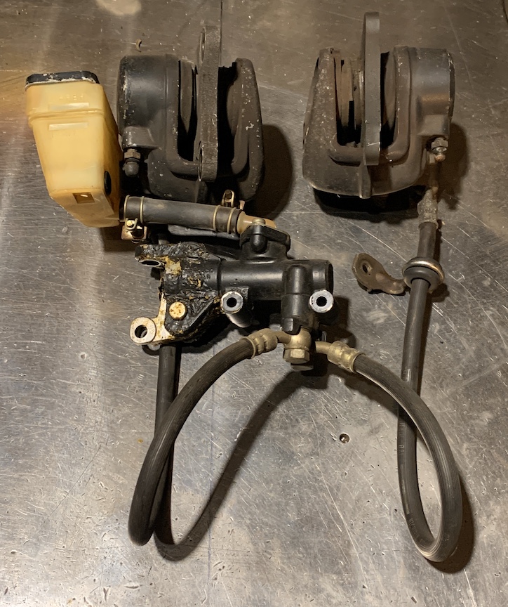

Holidays are over and time to get back on this project. More disassembly indicated more problems. I started with the brakes since corrosion and brake fluid was evident where it shouldn't be. The early Z1Rs had a cable operated front master cylinder with a 5/8 piston. Rebuild kits are available but not the master cylinder. The few I have found are corroded as mine is. Later models had the master cylinder on the handlebars.
Brakes front.jpg (282.71 KiB) Viewed 181384 times

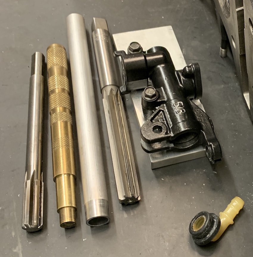

I had one option and that was to bore, sleeve and hone it, so I did. One down, one to go and it's another unusual version.
Master Cyl re-sleeve.jpg (233.77 KiB) Viewed 181384 times

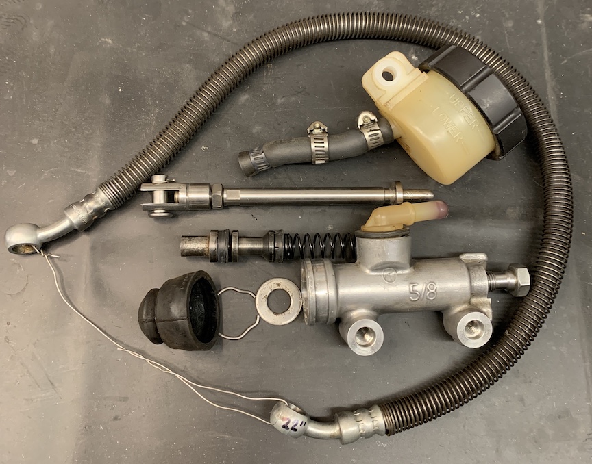

The early Z1Rs had a master cylinder with a remote reservoir. The bore is the same as the front master cylinder but the rebuild kit is different. So, the next step it to sleeve as the bore is also pitted. :P
Brakes rear.jpg (227.18 KiB) Viewed 181384 times

What material are you using for sleve?

The sleeve is aluminum 2024-T3. 6061-T6 would have been ok too. I bored and reamed the piston and then turned the od of the tubing to fit using loctite. I finished of the bore off with a 5/8 reamer.

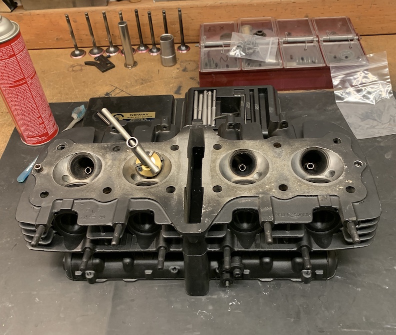

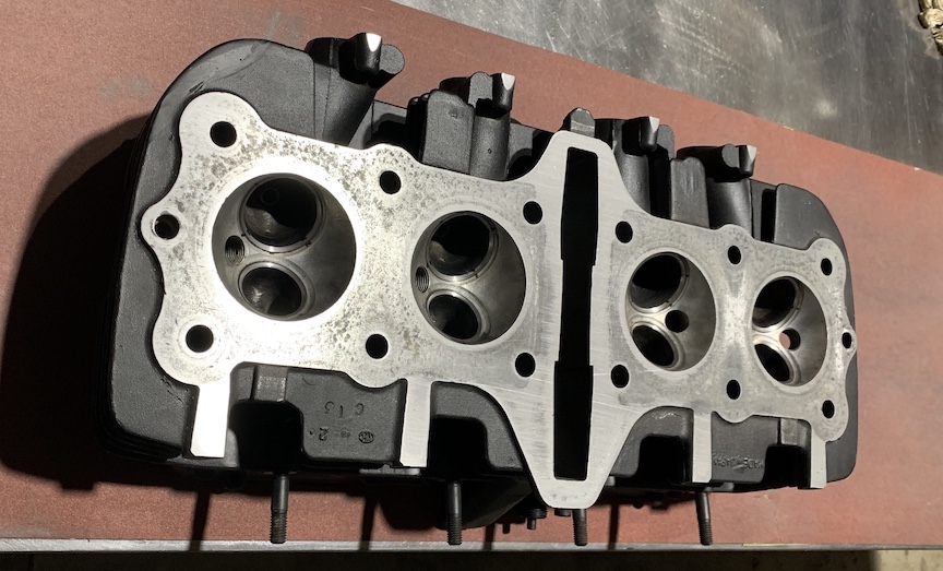

The brakes are finished so I disassembled the motor. Starting with the head, 2 of the valve shim bucket were stuck in the head. Several hours of soaking with Kroil, heating and cooling and they finally cam out without damaging the head. The surface of the head was heavily pitted and after attempts of lapping I realized the head was warped. Further inspection showed that 2 of the cylinder/head studs were cross threaded keeping the head bolt (which is a cap nut) from seating. This would not allow the head to be torqued down properly. A friend who has a head resurfacing machine finished the head by removing .005".
warped head.JPG (188.42 KiB) Viewed 180143 times
The seats were re-cut with the Neway cutter and valves refaced and lapped. This means all the valve adjusting shims have to be replaced or valve stems need ground to re-establish the correct clearance. Lapped the valves and head is finished.
Valve seat cutter.jpg (219.95 KiB) Viewed 180143 times
lapping valves.jpg (218.78 KiB) Viewed 180143 times
Re: Z1R BUILD
Postby Lotus54 » Thu Jan 18, 2024 3:29 pm
I never thought of lapping valves that way. Since none of the ‘regular’ suction cup lappers seem to hold the valves well anymore (old ones did great)- I will try it next time.

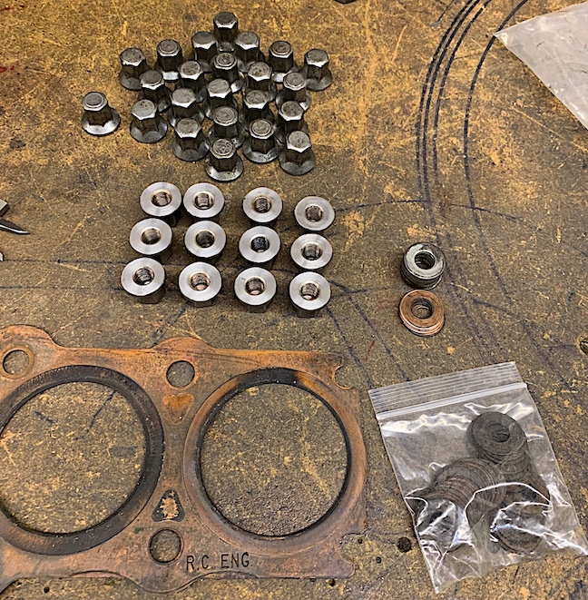

Now with new cylinder studs and threads repaired in the crankcase I chose 12 head nuts from an assortment of several. While spinning these onto the new studs I noticed a wobble in several of them. Not a good combination for torquing down the head properly. So I screwed these onto a threaded adapter in the lathe and re-cut 12 so the surface will be true to the surface of the head. The 4 outer head bolts have copper sealing washers.
HEAD BOLTS.JPG (315.06 KiB) Viewed 179777 times

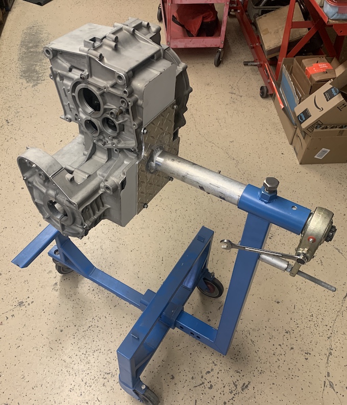

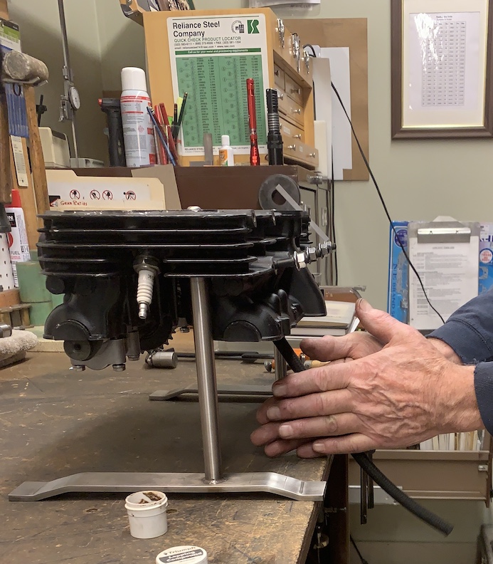

I've wanted to add this rotating attachment to this bike stand for a long time. I still need to make a crank to insert where the hand wrench is now. The engine adapter as you see it now is just for holding and rotating the motor during the painting process. I can roll the stand out into the main shop to paint then roll it back in the warm room to cure. A different adapter will be used to hold the motor for the assembly.
Engine Stand for painting.JPG (261.22 KiB) Viewed 179658 times
