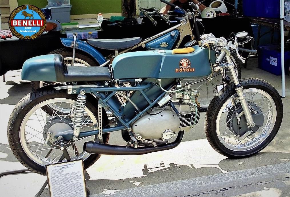

Postby Lotus54 » Mon Aug 07, 2023 7:05 am
Here is a picture of one of the racing versions. They did quite well I understand.
Posts: 640
Re: Benelli 250 SuperSport (egg)
Postby John H » Tue Aug 08, 2023 7:13 am
Is this a 250? The float is bigger than the carb! Bet it's fun to race.
Postby Lotus54 » Tue Aug 08, 2023 8:03 pm
I think that is a 250. Looks like a Zanzani bike
https://www.motobi.com/wp-content/uploa ... 5-x-57.pdf

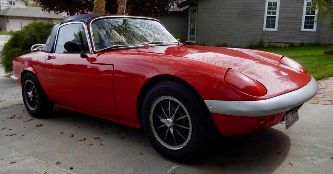

I was not planning on doing so at all. But this Lotus Elan came along…I’ve always wanted one of them. So I sold three bikes to make room and free up some cash.
Since I also have almost same year Benelli 250 (2-stroke though) as this one, I decided I could let it go. New buyer is excited about it and lives in Colorado. Sale was very smooth, no issues at all. Probably shipped off soon.
BTW, this will be my 9th Lotus- I have had a ‘new’ Elan (90s) but I didn’t like it as much as the other ones I had. This one is a 66 drophead. Paint is only fair but runs and drives well.

I was thinking you might make a classic racer with your second Supersport. 9th Elan does sound like fun though. Is this going to be a restoration project?
Postby Lotus54 » Sun Nov 05, 2023 11:42 am
I am going to drive the Elan mostly as is for awhile at least. I have a few things I am changing- the ‘Rotoflex’ rear axles I am changing to CV joint axles. Changing distributor ignition to crank sensor coil-to-plug setup (distributor is under carbs and cannot handle modern coil voltages/current), maybe electric water pump.
Paint is only fair and I know how much work repainting these are. So I plan on using it for some time at least with no body/paint. The person I bought it from is replacing all the carpet and re-varnished the dash. He bought it from the original owner last May and I think likely planned on fixing a few things and selling. I’ve known him for decades (although very rarely see him).
Eventually I may pop the body off- but not for some time (at least that is the plan).
