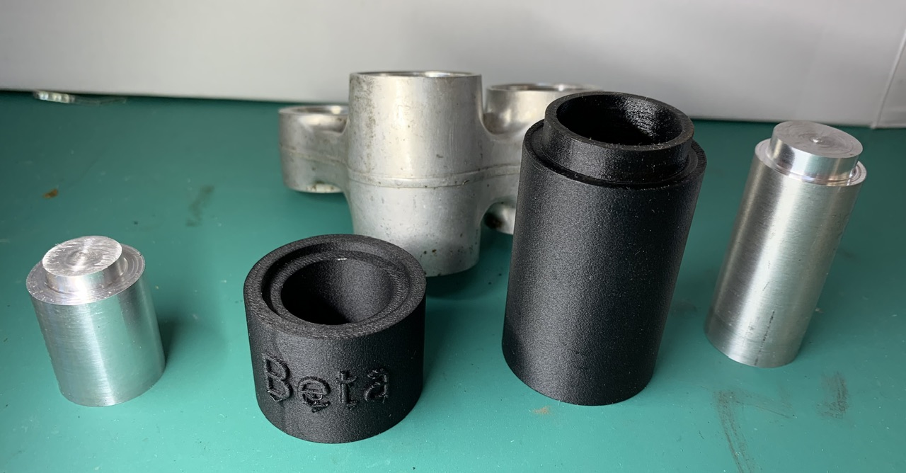

I was replacing bearings on somebody’s Beta. I’ve done this before and always looked for spacers, sockets whatever fit ok. It was always a bit of a pain getting everything lined up etc.
So preparing for this one I decided to make proper tools.
For the ‘driving’ part I had some aluminum rod- it was pretty easy to machine to that a centre portion would extend into the bearings- lining it up, and the rest would fit through the part the bearing is pressed out of and back into.
But then the part has to sit on something that will allow the bearing to come out. I chose to 3D print this and see if it would work. I’ve been learning Fusion 360 (CAD)- I designed up the part, sent it to the slicer then to the 3D printer. I had some PETG-CF (carbon fibre reinforced) that is pretty strong, I made the ‘infill’ quite dense with extra wall thickness. The part fit right over the ‘receiver’ with a lip locating it so the bearing can slide right out and the part will not move around. One of them fit around the part the other inside.
I was not certain if they would be strong enough, but they worked great. I think I could have printed all the parts and had no issue. If they were really stubborn, I imagine they may not be strong engough, but these were pretty tight an all well. The instructions say to heat the part before pressing in new bearings- they are tight.
Always fun learning new things and trying things out.
BTW, I had not tried adding text to a part- I can see I needed to make it stick out less or add support. I think next time I will make it a different colour and do it in the bottom rim. That would mean less filament changes and it should look quite good. Also identifying the tool.
