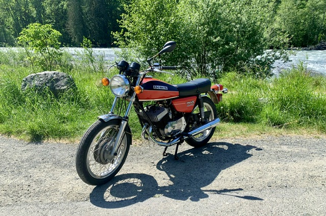

I took it for a longer ride today- ran great!
I found out why cold start was poor- the cable going to the ‘splitter’ that opens both of the starter valves had broken.
I need to get some 3mm screws to bolt down the handlebar switch, a few other little things and ready to put some miles on it to break it in.
I turned over 5,000 miles on the speedo.
I forgot to take a picture on the ride.

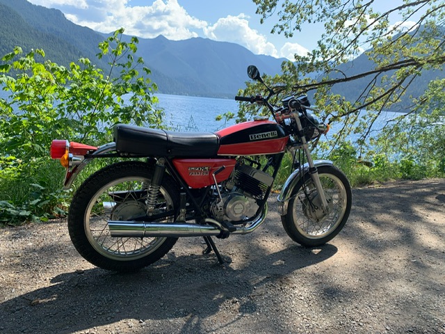

Great day for a ride up the Elwha (and other places)

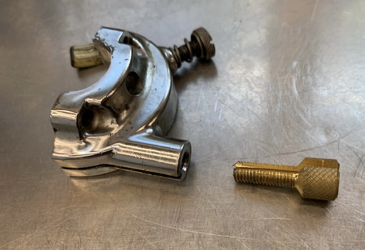

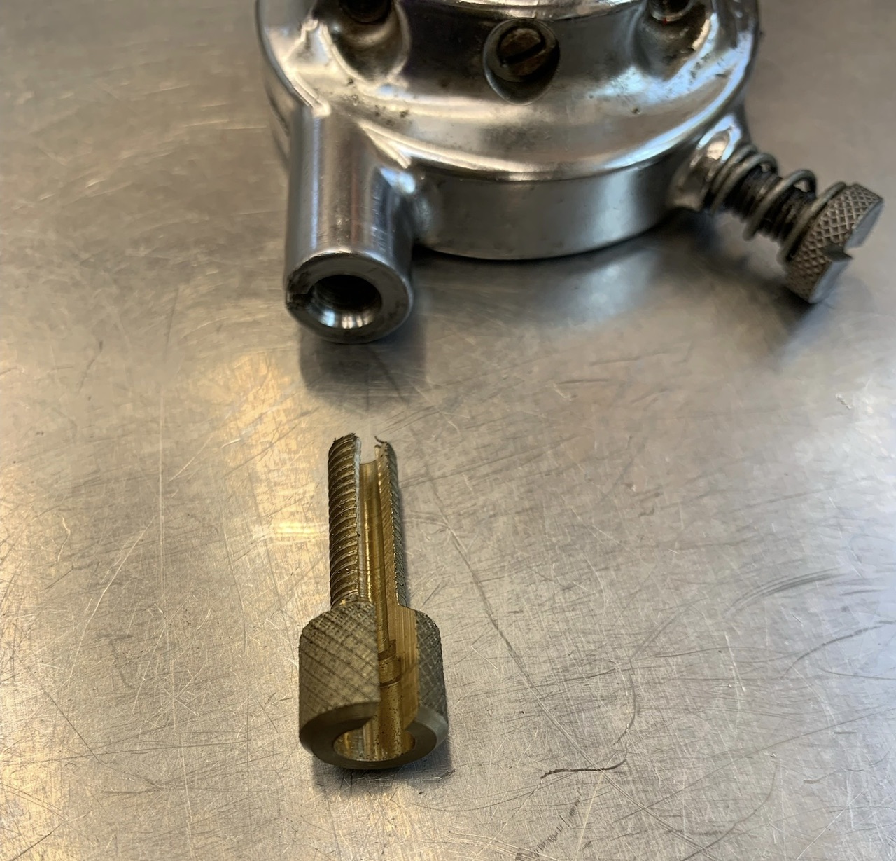

The throttle cable adjuster had broken. I’m going to replace the throttle and splitter with a two-cable setup, but in the meantime, I made a new adjuster. The knurling is not very good- but it is functional
Posts: 649
Re: Benelli 250 2C
Postby John H » Fri May 19, 2023 7:25 am
Knurling takes some practice to get a perfect pattern. What brand is the throttle?
Re: Benelli 250 2C
Postby Lotus54 » Fri May 19, 2023 8:30 pm
Tomeselli.
I’ve done a lot better knurls before, but this was a different tool, different lathe and different material.
