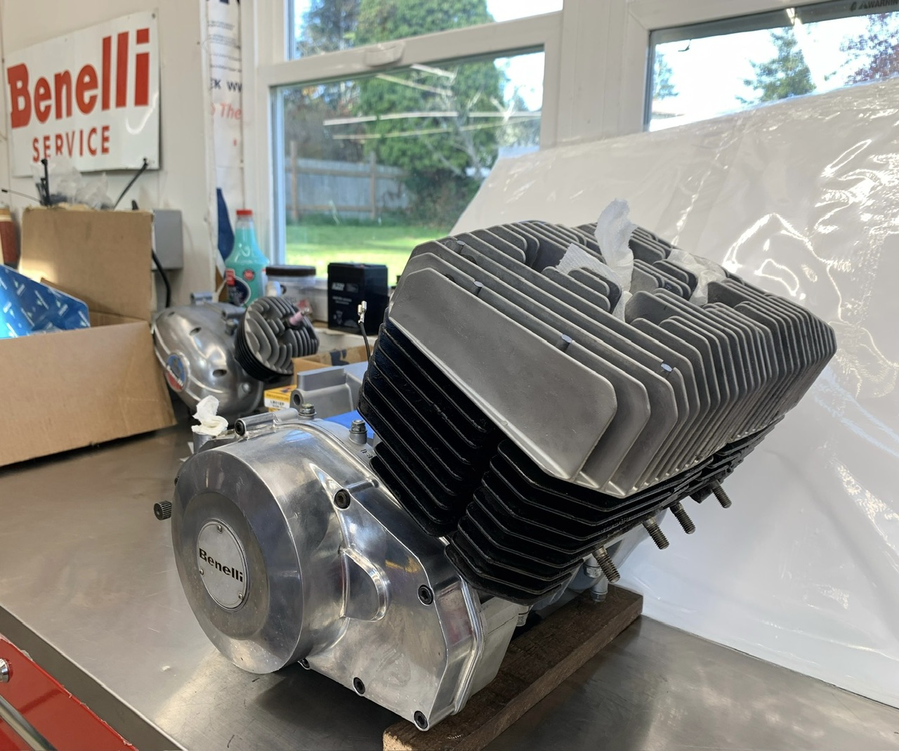

Engine is ready to install, but of course need to clean up frame and fix those mounts first. The ignition/charging went on pretty easily and it will be nice to have not battery, 12Vdc and no points.

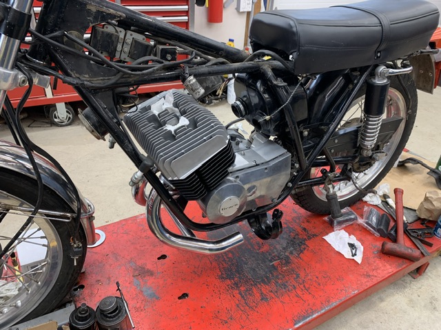

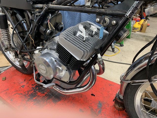

Engine is in. On to work on wiring for the mods and Vape system

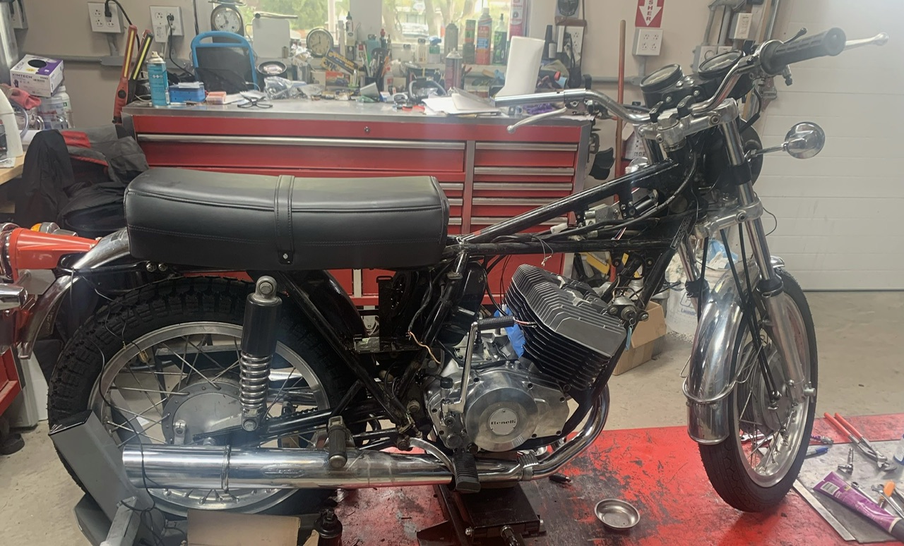

New front/rear tyres, tubes rim strips. New front brake shoes, adjusted and feels good. I did not arc the shoes in, I figured I would just ride it a little then see how they are seating.
Also new O-ring chain and one wheel bearing (rest were very good).
I will go for the electrics next, waiting on a new handlebar light/turnsignal switch setup and a 2-position keyswitch. Originally, these had the keyswitch connect the negative to the battery and earth it. I won’t have a battery, so the keyswitch will just be a ‘kill’ switch, disabling the ignition when turned off. Then I need to run new wires for the turn signals and connect all the new ignition/charging system wiring.
