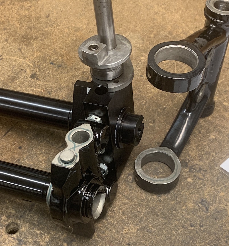

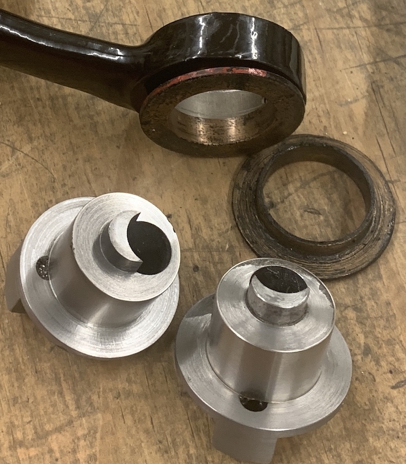

Here you can see the original stem and behind it is the modified stem and to the right is the lower link.
Girdraulic eccentric.. copy.JPG (270.65 KiB) Viewed 29288 times
The eccentric spindle is a feature that allowed for change in fork spring pressure if adding a sidecar.
Building up worn parts is part of the game. These eccentric spindles were turned down and a stainless steel sleeve was shrunk to fit then turned down to the correct diameter for the new bronze bushings that will be pressed into the lower link.

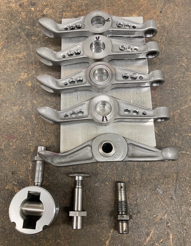

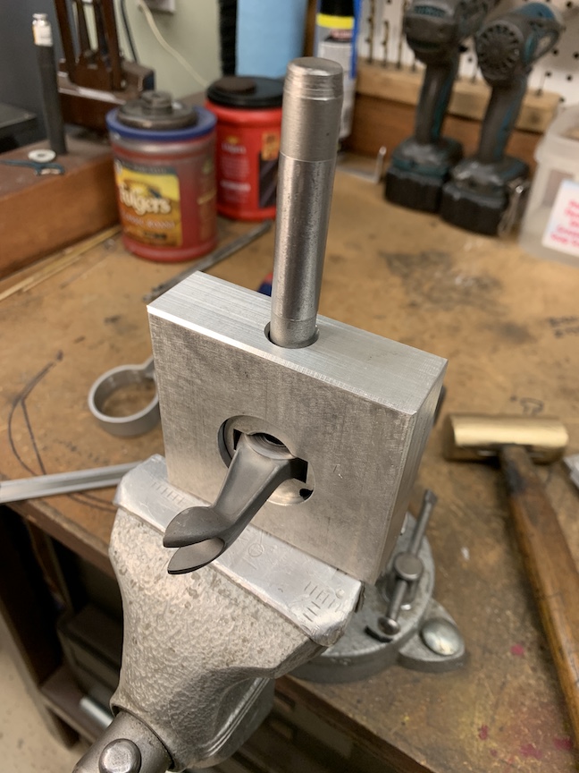

Still waiting on parts so spent some time on the valve train. The rockers are measured for ware and after finding 4 nice ones I polished them then resurfaced the the fork where it contacts the valve stem collar. Six small holes were drilled for lightening.
The hump at the center of the rocker has to be removed so the new style retainer will fit. This retainer holds the rocker bushing tight to the top of the tunnel which reduces wear and noise.
This is a tool for pressing the rocker shaft in or out the bushing.

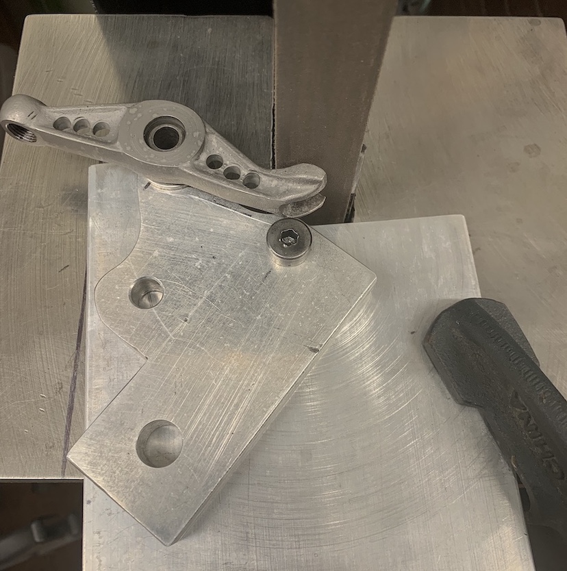

Here is the fixture for resurfacing the fork on the rocker.

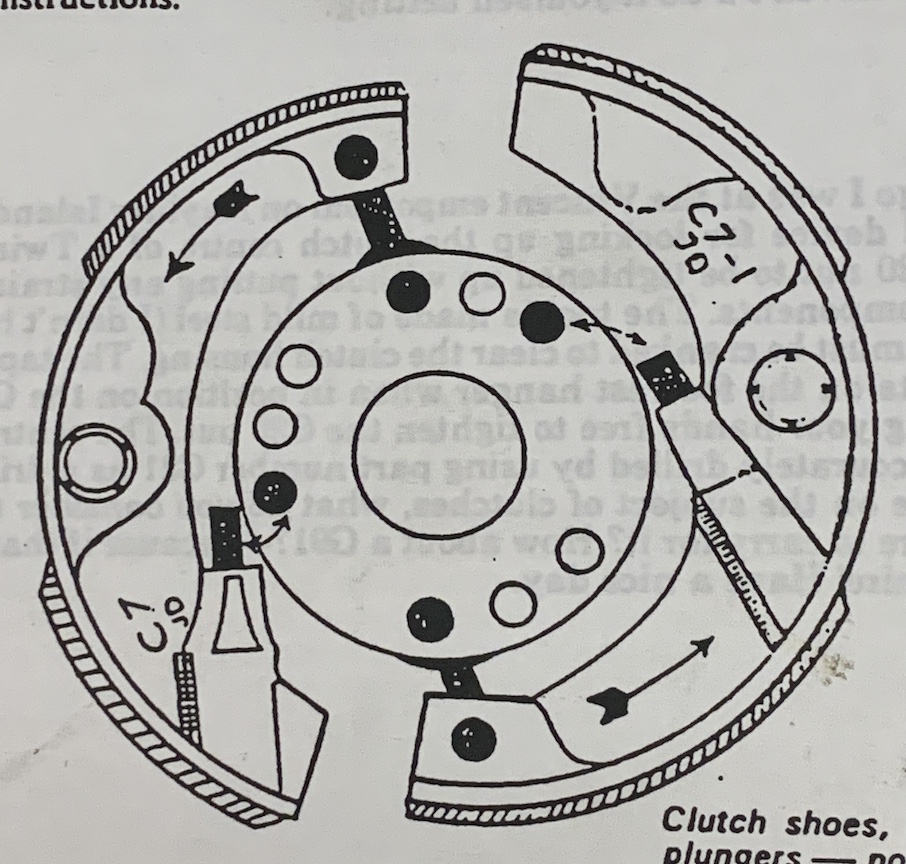

With the rockers finished, I started on the clutch since I already have all the parts needed to build it.
Several wear points need to be checked and replaced to have a smooth operating unit. Over the years there have been many articles written on how to build it, tune it and keep it functioning well. It's a dry clutch and without lubrication some parts suffer.

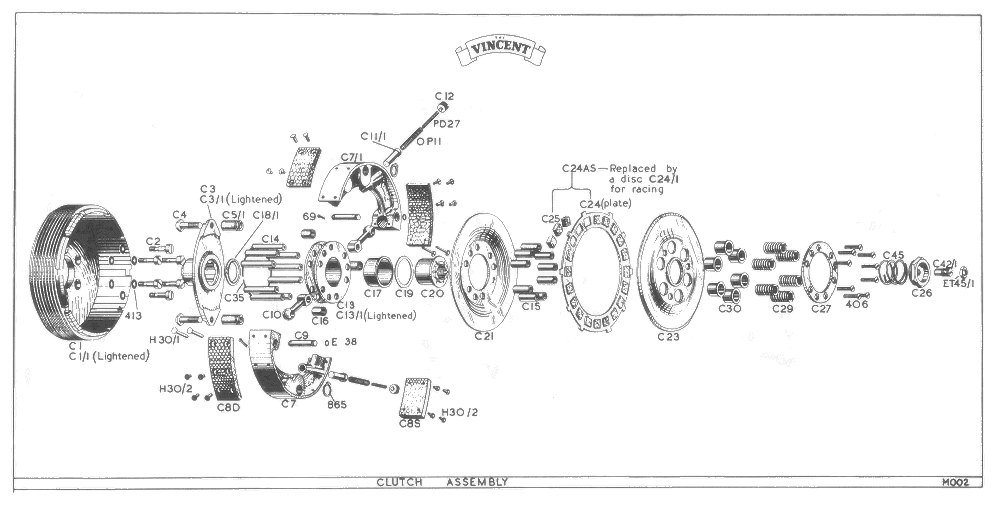

MO02 Clutch.gif (57.71 KiB) Viewed 29182 times
First thing is cleaning and inspection for worn parts. The bushings, seals and clutch shoe linings are always replaced. The clutch shoe carrier C3 which rides on the gearbox main shaft has to hold the clutch shoes in perfect alignment, if not, slipping or grabbing will occur. The 2 steel clutch plates warp easily so will need to be resurfaced. A rubber insulator is added behind the plate to stop the harmonic effect when machining the surface.
The clutch plate carrier C3 rotates on the clutch shoe carrier C13 and when engaged, forces the clutch shoes out against the drum and acts just like a simple motorcycle clutch, except when you let off the throttle, the action is reversed and the opposite brake shoe lining is forced against the drum and helps you slow down without free wheeling / coasting. A video would explain much better than I can. It actually works really well if it is set up correctly.

Postby John H » Sun Mar 20, 2022 2:39 pm
The pilot clutch disk when engaged forces the 'toe' of the clutch shoe against the spinning drum causing the shoes to turn the gearbox main shaft. When reducing engine speed, the reverse happens forcing the 'heel' of the clutch shoe against the spinning drum. That's the simple explanation. Books have been written on details how to make it work as it is all very sensitive to adjustments due to oil leaks and wear.
Clutch plan view.jpg (284.07 KiB) Viewed 29162 times

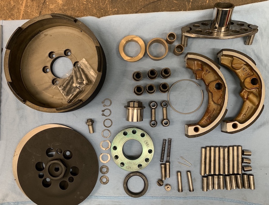

The parts are now new or cleaned and ready for assembly. 75 pieces +/-...

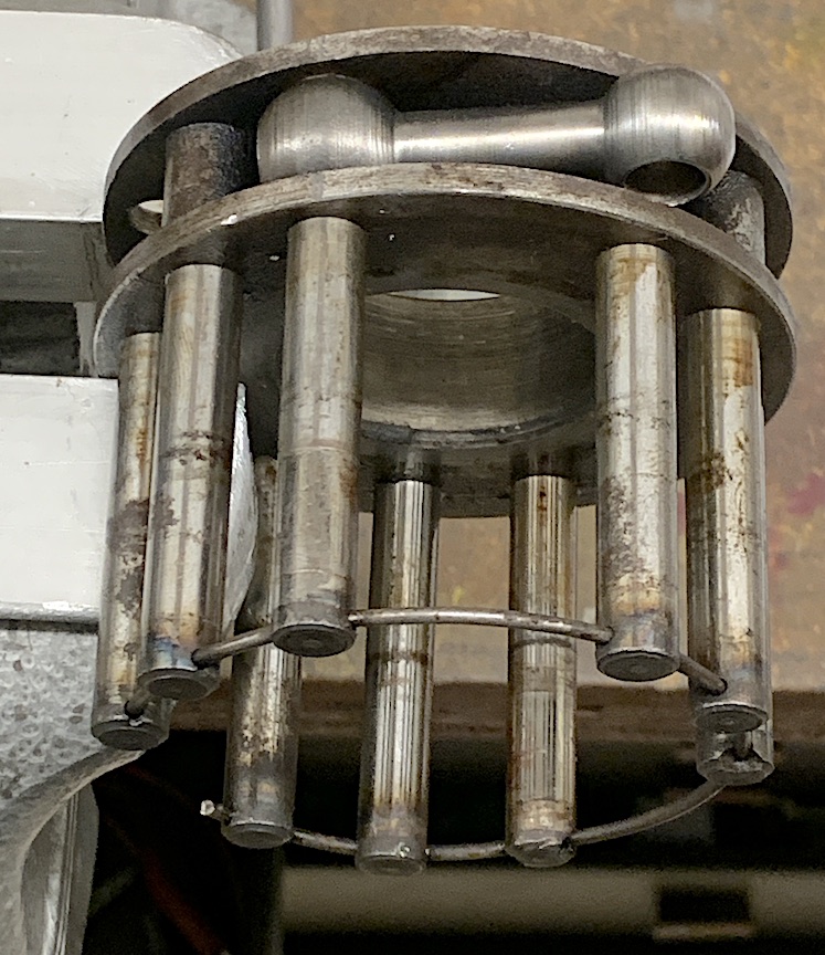

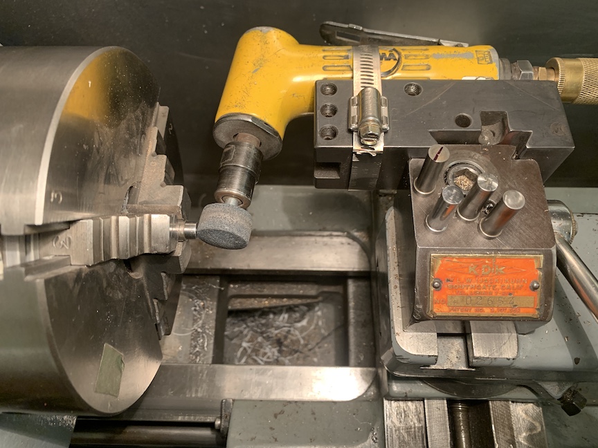

Postby John H » Thu Mar 24, 2022 8:05 am
These centralizer thimbles (C11/1) when set correctly keep the clutch shoes from dragging when the transmission is in neutral or when the clutch lever is pulled in. This setting also determines the force needed to engage the clutch for drive forward and the reverse force needed to reduce forward drive, as well as engaging the kickstart lever.
Well, what I'm trying to say is when these forces are happening, the tip of these thimbles is rubbing against one of the 9 posts on the centralizer causing an indent which then makes the whole motion of the clutch grab. So with the die grinder I have resurfaced the end just enough to remove the indent . Next is putting the shoe on a fixture and setting the spring pressure and plunger travel. Confusing? :roll:
