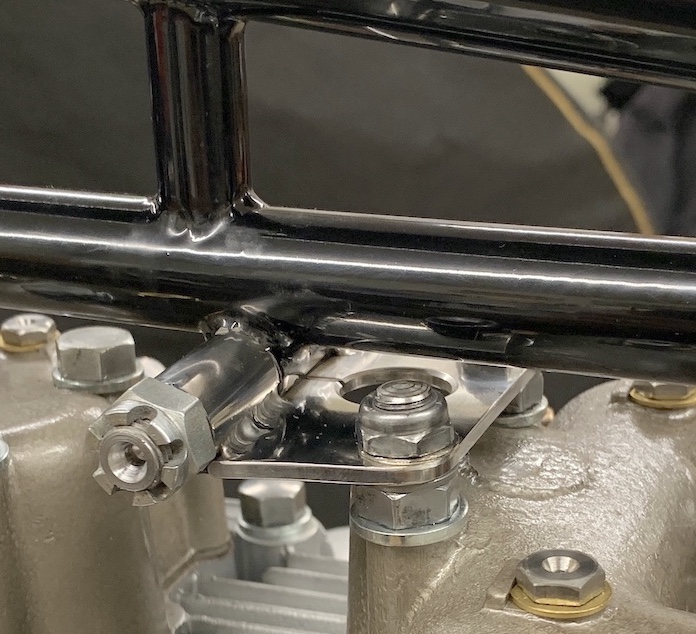

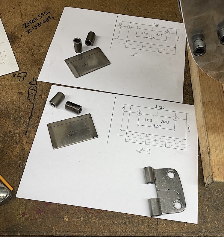

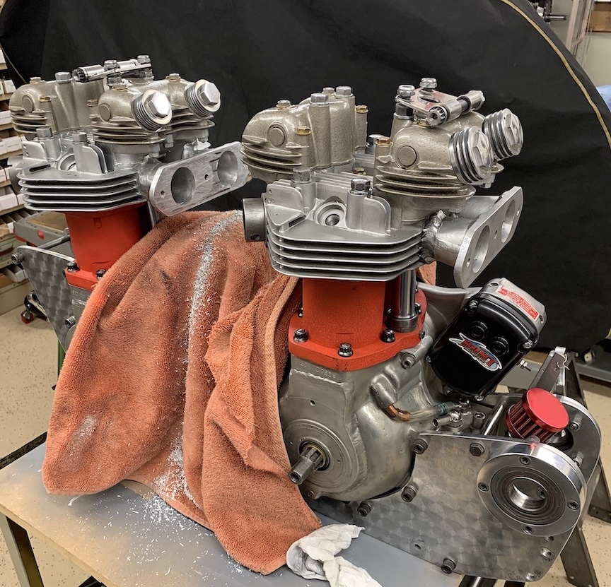

The 2 torque plates are different, in part due to wear and tear and probably different crankcases.
So each plate is fit individually. I didn't have any steel handy so made them from stainless steel.
The pieces need to be in place for welding so will move the unit out to the welding area tomorrow.

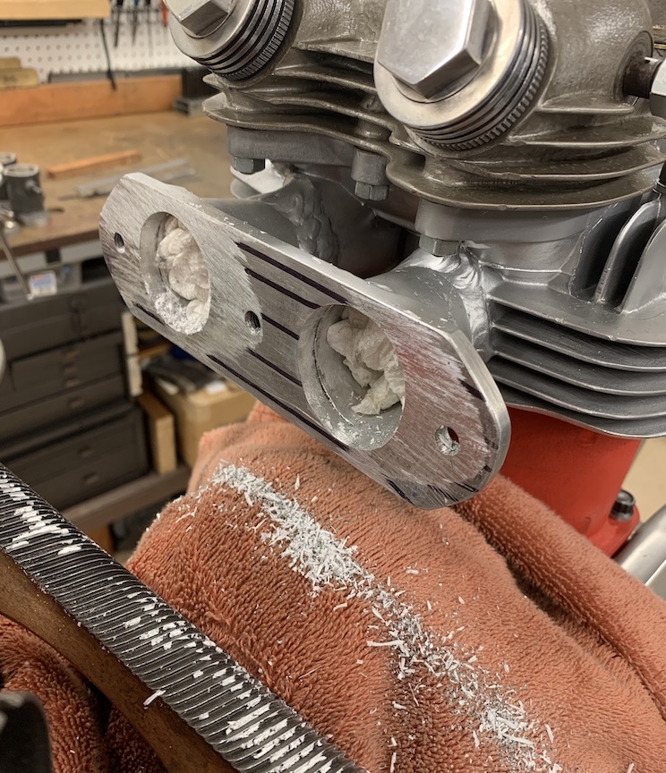

When mounting the injectors I noticed a seriously warped manifold. Now I remember there was an extra thick gasket here when I disassembled the motors. I had a choice of pulling the head and and milling the surface true or using a vixen file. Two hours later I had it filed flat.

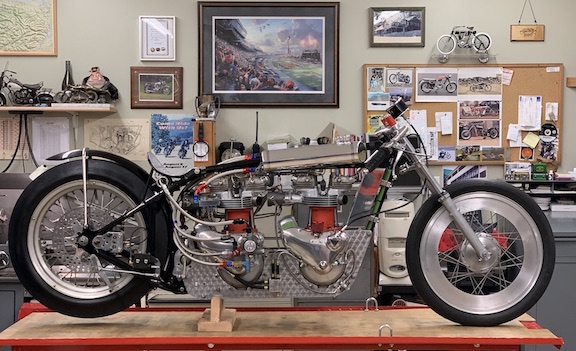

The Double, with the exception of the exhaust pipes, is finished. I haven't decided on chrome or ceramic for the finish.
On to the next project.

Looks great!

It looks great John, thanks for taking us all along on the road to recovery!
If you need a rest you can work on mine next.
