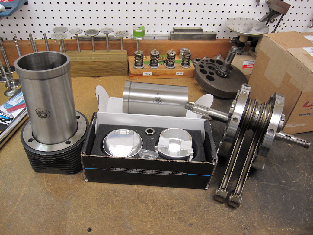

More projects than I'll ever have time to finish. Maybe that's what keeps us active. The Double was originally going to be for show but once I got into it I knew I had to hear it had to run. Will it ever see the drag strip? I don't think so. Pistons are unobtanium unless special made. Had to draw the line at some point.
For the Vincent race motor, CP charged $700 for programing and two pistons and another $300 for two additional pistons.

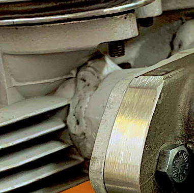

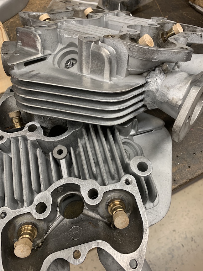

The Double got some attention today. After soda blasting the heads I noticed a crack where the intake manifold attached to the head.
The old weld was removed and the head pre-heated to 300º to cook out any oil that might contaminate the weld. It went well until a sudden puff of black smoke and what appeared to be some type of epoxy came out. More cleaning, grinding and welding. Not pretty but will have to do. The valve guides have now been sealed off in preparation for vapor blasting.

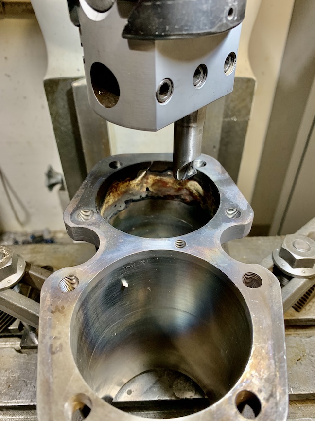

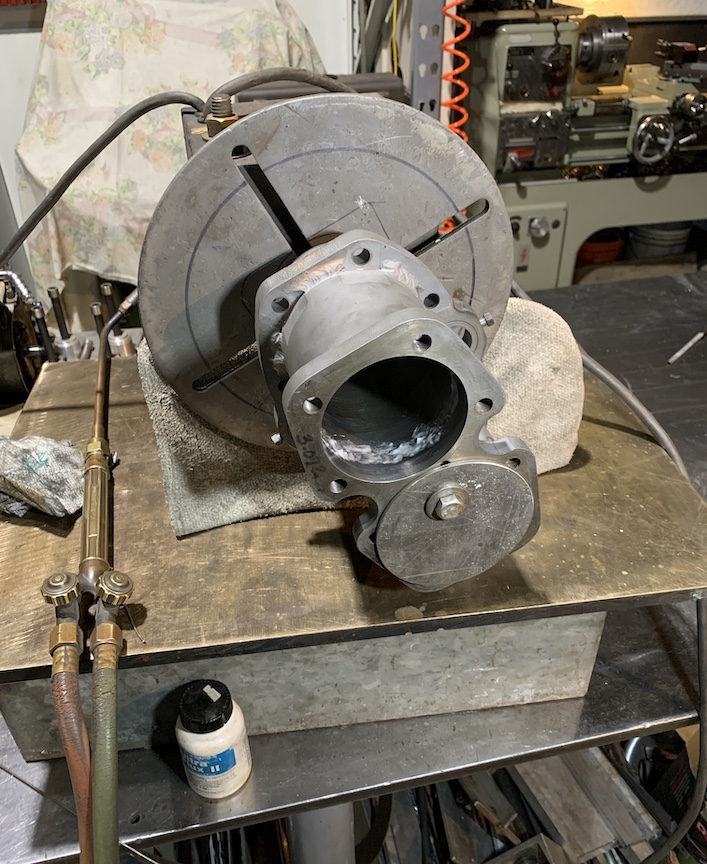

I set up the rotary welding turntable to hold the scrap cylinder and made a few test welds in preparation for repairing the extra cylinder that has grooves caused by rusty cast iron piston rings. Once I start the silver brazing I don't want to stop until the groove in the bore is filled. I can control the rotation and speed with the foot pedal which lets me concentrate on the weld. Temperature is pretty critical since the repair is close to the flange that was furnace brazed in the fabricating process. The silver I'm using melts at 1100º to 1200º so the preheating and welding should go quickly. I spread the flux paste which you can see and will leave it overnight to hopefully kill any rust deposits I may have missed. Will give it a go tomorrow.

The silver brazing went well. I did miss one small spot but overall it will clean up ok. I machined off the excess material to within .002" of the original bore, using a carbide cutter due to the crystalized flux.

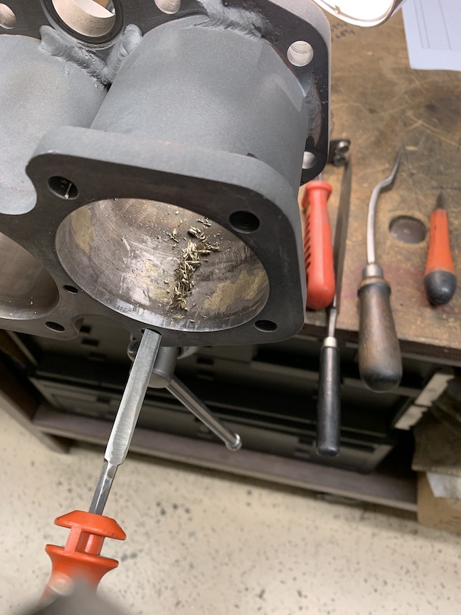

Chipped off the remains of any flux then used a bearing scraper to take the weld down to the original surface. Next will be honing the bore to the final finish. Glad this part is finished.

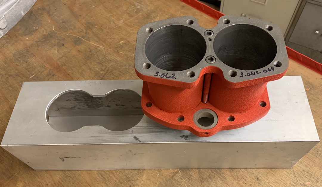

Next job will be honing the cylinders to fit the pistons. The trick will be getting the bore round again without going oversize.

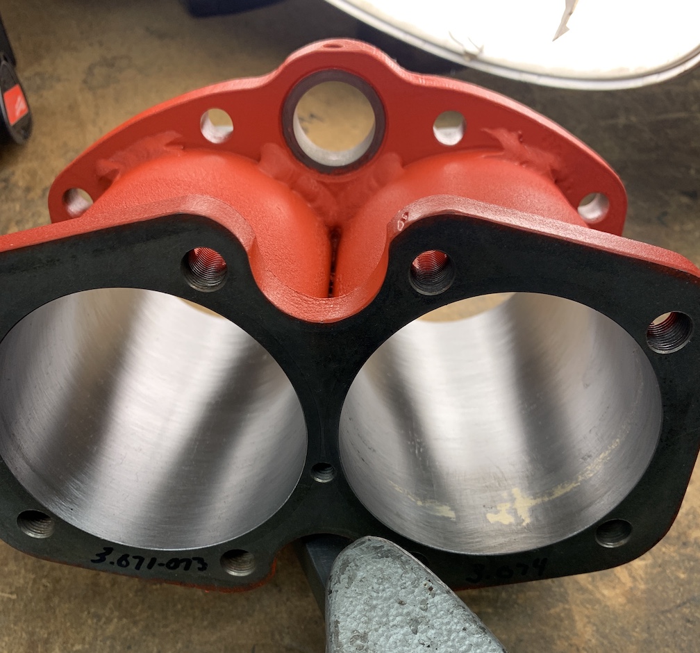

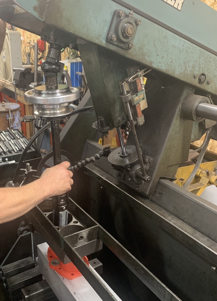

Unable to find a long 3" x 12" Sunnen mandrel that would be ideal for truing up the bore, next best is to use a vertical cylinder hone machine with an 3" x 6" extra wide stone set. This should help to get the bore round again without going oversize.
Re: Double Trouble
Postby John H » Fri Oct 01, 2021 9:17 pm
The cylinders are finally finished and turned out better than than I had hoped for. With the right tools in the right hands the bores are now straight and round.
