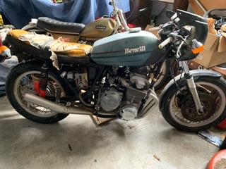

Postby Lotus54 » Fri Jan 10, 2020 6:08 pm
As you can see- it is rough. But I think it won’t be too bad to bring back to a good rider.
I already have proper 6-6 pipes, seat cover, fenders, tyres, handlebars and many others.
I have a 900 sei small fairing I plan on using (the one in the pics is up for grabs if anyone wants it).

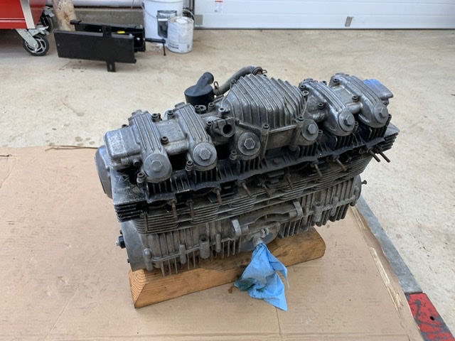

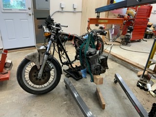

Popped the engine out today. The cherry picker/balancer made it pretty easy. I couldn’t fit the legs of the cherry picker under the lift- so had to move it back on the ground.

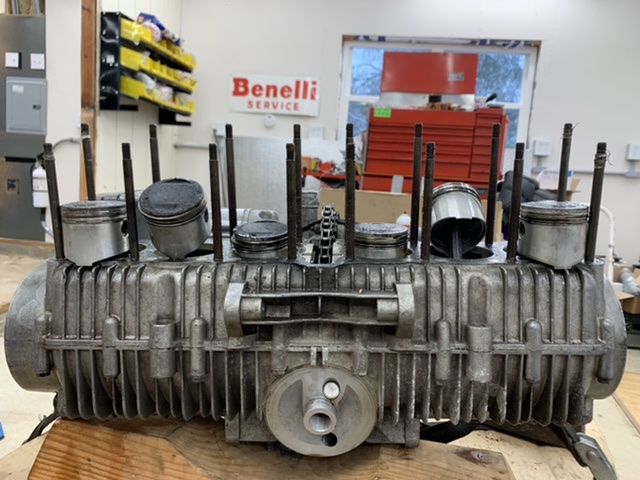

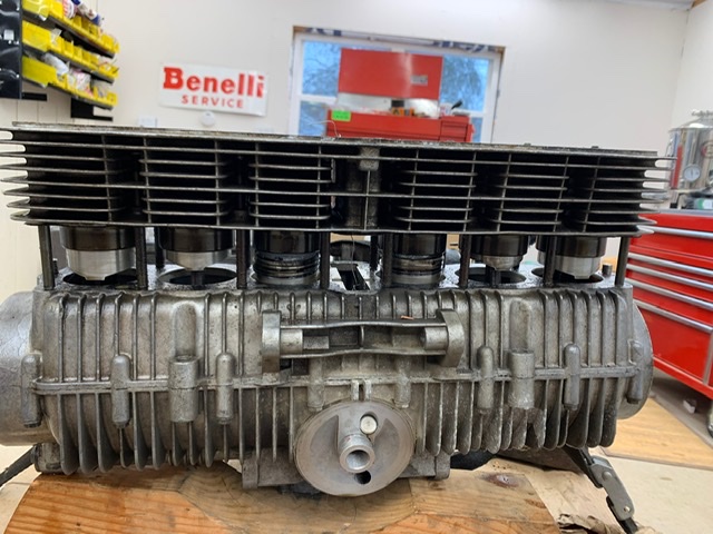

Postby Lotus54 » Mon Jan 13, 2020 6:17 pm
popped off the head and cylinder today.

Did you find any stuck rings?
Re: Benelli 750 sei
Postby Lotus54 » Mon Jan 13, 2020 7:56 pm
Yes, #6 (the one with low compression) had the top two rings stuck.
