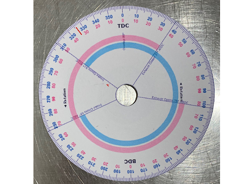

I wanted to share a cool website that lets you print your own timing wheels including positions of intake open and close, exhaust open and close, and top of lobe. Then you just paste it on an old cd smeared with a thin coat of Elmer's glue and you're good to go. https://www.blocklayer.com/degree-wheel

Hmm, maybe I will 3D print that in colour- then it could be whatever thickness wanted with centre hole size desired. Thanks

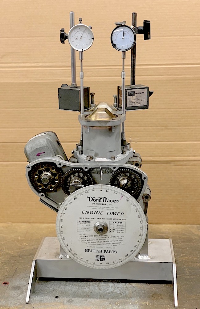

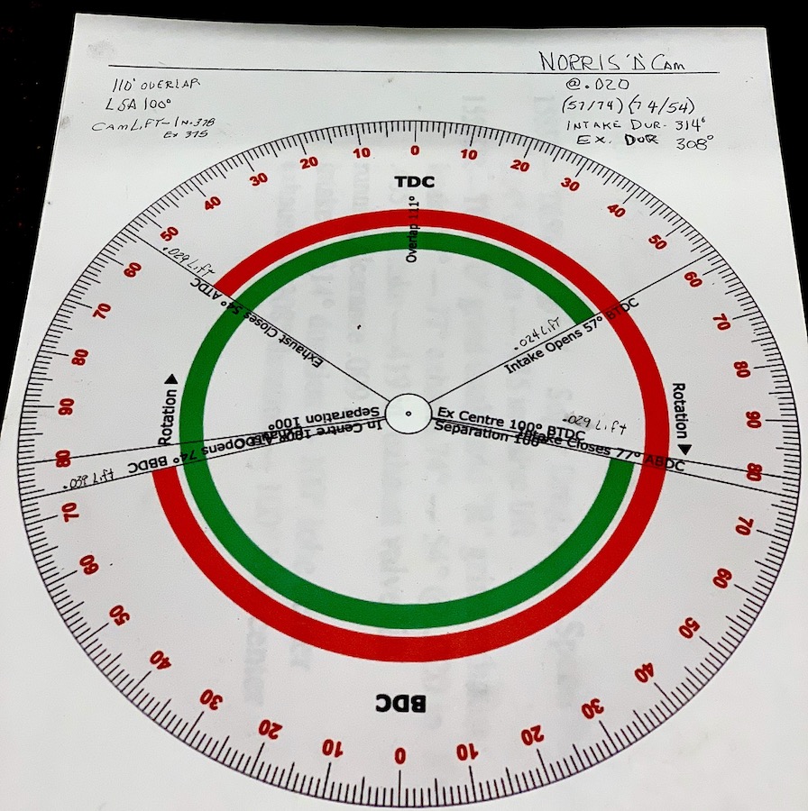

I used this program when degreeing the cams in the Triumph twin engine drag bike. Without a spec sheet for the cams which were stamped 'nitro' I was able to produce a degree wheel from the program.
