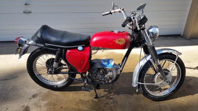

What's going on with all the projects out there? Did they get pushed back to take care of more 'important' projects.
George is finishing up his new shop, Larry C is finishing up remodeling the house and Davie has finished his new home
and sold the old one. I'm at the end of the basement project.
Work is progressing on Ron's Goldstar Clubman and with a few more hard to find parts in hand he will have a beautiful classic.
Next project will either be the BSA Goldstar Catalina or the BSA Hornet. Both are interesting bikes built for racing. The Hornet actually has a lighting kit on it that was sold by BSA to make it street legal.
So, what's going on with your project???

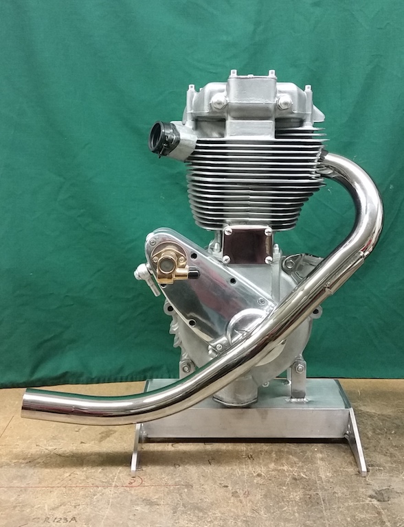

Here's Ron's engine for the Goldstar. Getting close to finishing. Still no luck finding a gearbox main shaft
so the plan is to grind it undersize and replace the output bushing to fit.

We got the gearbox shaft ground and new bushing installed in the output gear. Next will be trying to solve the eccentricity of the clutch chainwheel basket. Obviously a wobbler since 1962. This causes the primary chain to tighten/loosen every revolution. Just another little twist in restoring old bikes.
