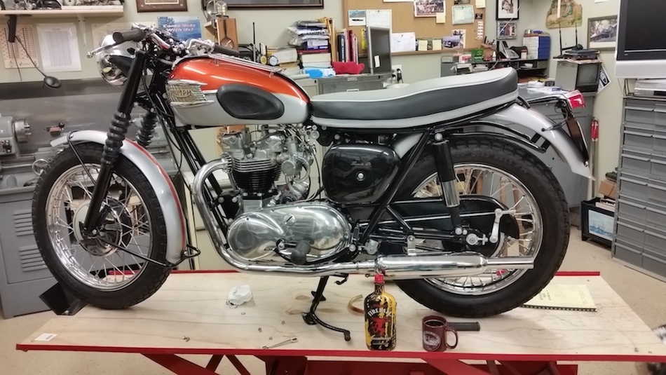

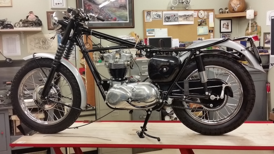

Progress has been slow lately but the Bonnie is a roller now. I'm still trouble shooting a wiring problem
(6 volt/positive ground). This was the last year for the 6v alternator/magneto setup. I'm waiting for a new rectifier and battery, then more testing.

We're on the home stretch with the Bonnie and should be ready to test it out next week. The first time I switched the headlamp on, the ammmeter needle showed a discharge but when the light was switched off the needle did not return until
I tapped the headlamp bucket. So a new gauge has been ordered.
I'm still looking for the correct 5/16 id x 9/16 od clear fuel line which is an odd size for a motorcycle but common in beer making accessories. The difference is beer tubing is not compatible with gasoline.
Re: 62 Triumph Bonneville
Postby ClineDesign » Wed Jan 02, 2019 6:18 pm
Postby John H » Sun Jan 06, 2019 6:22 pm
I found one at Motion Pro that will pass. https://www.motionpro.com/product/12-0060
Correct size though not the correct tubing, it will do for now.
