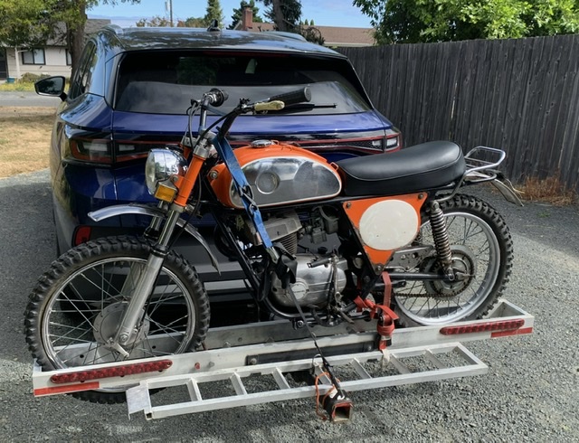

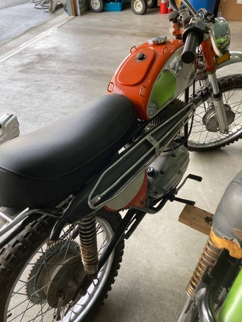

A Benelli 175 Enduro came along that was quite complete (only missing a couple items) and low price. For some reason I always wanted one of these. They were not really that great- at least not compared to the bikes I had. The OSSA Super Pioneer I have is a way better bike. But this is very light (205lbs), Marzocchi suspension, good frame design and 18” x 19” wheels. The 21” work way better in the dirt, but this is really better suited to mild dual sport type stuff anyway.

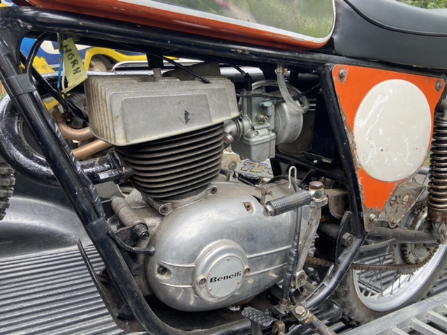

The engine is a mild tuned 175 2-stroke, 4 speed right shift. I’m sure lighting is abysmal, but no way I’ll ride it at night anyway. The fuel tank is very clean inside, it does not appear like anyone has messed around with much on the bike.
I replaced the kickstart return spring, put some fuel in a test bottle and it fired up on about the third kick. Took a little while to ‘clean it out’ so I suspect someone fogged the engine (or just dumped some oil down there). Has good compression for the low compression engine. Clutch is stuck and brake cables were not setup right so the riding and jamming the brakes didn’t free it. But I can pop the side cover off and free up.
The dual sprocket is interesting. It is setup so removing four bolts allows the big sprocket to move out of the way- or in line. Then bolt back up, add the correct amount of links and away you go. Very nice system.
I took the wheels off (rear rim is pretty rusty and front not a lot better, so will replace those) and put it out of the way. I have a bunch of other stuff to finish first, so likely won’t touch it until fall/winter.
No title and the person I bought it from got it 5 years ago and never tried to start it. So doing the ‘check couple times a day’ for a State patrol inspection appointment.

I got the bike registered (collector) no problem with the VIN sticker showing legal. Just a new person at the DOL that didn’t understand that what we call ‘dual-sport’ bikes now were often called ‘enduro’ back in the 70s. No way this is a real enduro bike. Heck, the OSSA Super Pioneer is a true enduro motorcycle, but no issues plating since it doesn’t have any name hinting on it. It does have lights/horn etc. but just barely street legal. Not that I will ever ride it very far on the street anyway.
I drained oil- it looked like it has water at some point. Who knows when or how. Clutch was stuck- I have new plates, but those looked quite good, so I vaporhoned the metal and scotchbrighted the fibre ones. Some new oil and will test soon. And change oil a couple of times.

The clutch works great now and bike runs well.
