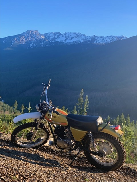

I just traded my 1974 OSSA Explorer for a 75 Super Pioneer.
I always wanted one of those and since I really was not using the Explorer, I figured I would trade it for something else I probably won’t use much . Ha
I only rode it around the yard so far, much ‘peppier’ than the Explorer- which makes sense because it was a trials bike with larger tank/seat. Felt nice, good position. I think I will ride it on stuff I take my Xtrainer on when I’m in the mood. Not all of it, the clutch is a LOT stiffer than the super light one (with Clake2) on the Beta. I could fit a hydraulic clutch setup and use a ‘One Light clutch’ - but I probably won’t go to that much trouble. (Especially since I gave away the magura slave I had).

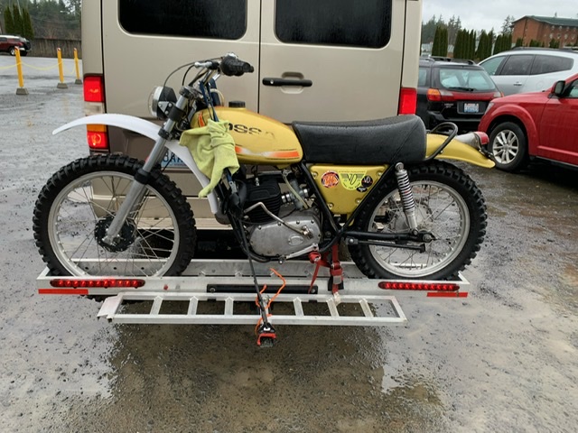

Another.
My ‘MityVac’ compression tester claimed 210 psi. I think it is optimistic, but I use the same one for trending pressures more than anything.
That said, that is right in the ‘new’ range of other modern 2-strokes for this meter.
These engines have very simple piston port (two transfers and exhaust) but were well know for superb power delivery.
Wish I could still get Curnutt shocks- those really worked great. Maybe some Works ones…

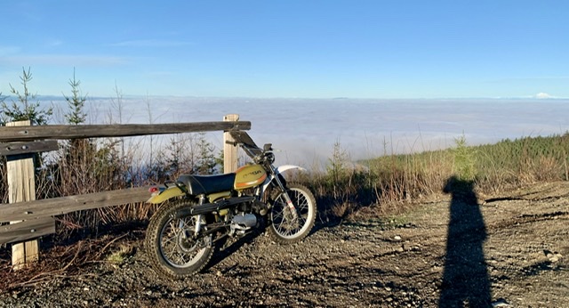

Postby Lotus54 » Thu Feb 03, 2022 2:46 pm
Nice first ride awhile back

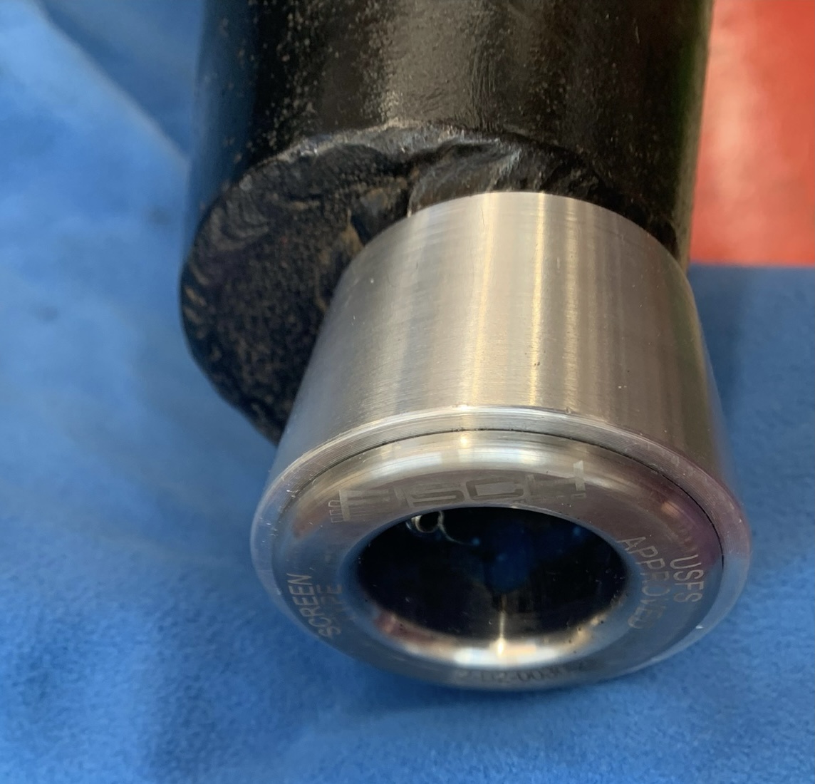

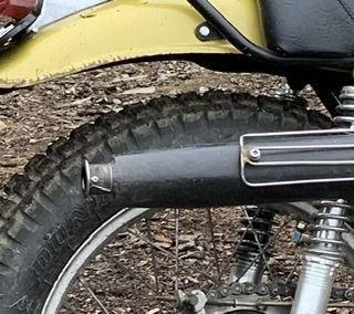

I added an updated spark arrestor on the OSSA.
Since it stuck out (the diameter) a bit I wanted to make something that would ‘smooth it out’ a bit and also a secondary retainer.
I’ve never done a taper before, but it came out fairly well and I managed to guess just about right for the angle. Heck- I even got the tapped screw hole on the bottom lined up right.
The inside is straight- snug fit over the short ‘tail’ of the stock muffler.
Oh yeah- it took me a ridiculous amount of time. It started as a solid rod and I have a pretty darn small lathe…

Looks nice. Are you replacing the original spark arrestor? Does this piece go inside the pipe?
Re: OSSA Super Pioneer
Postby Lotus54 » Wed Feb 23, 2022 10:18 pm
Originally from the factory- there was no spark arrestor. Someone had added one some time ago, but it was getting pretty tired.
So I bought this one.
It does go in aways- a ‘screen type’ which I don’t like as much. But they are effective and legal. Just have to clean them out and keep an eye on them.
Original pipe has a ‘tail’ that comes out about as far as this aluminum taper piece.
This picture shows the new arrestor before I made the tapered piece. I didn’t like out it stuck out, giving something to catch on.
