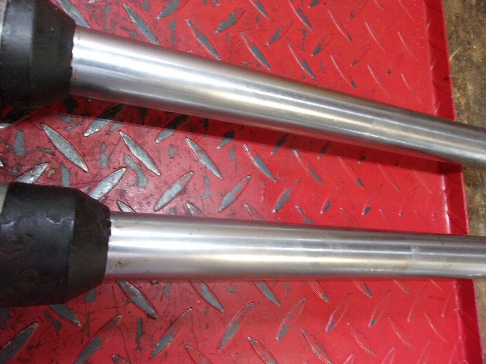

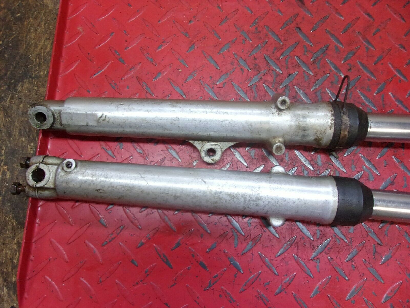

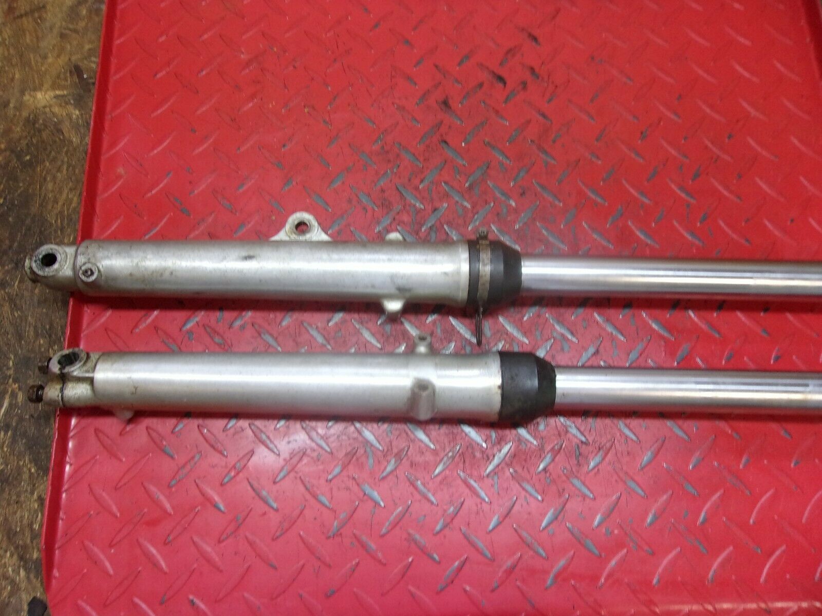

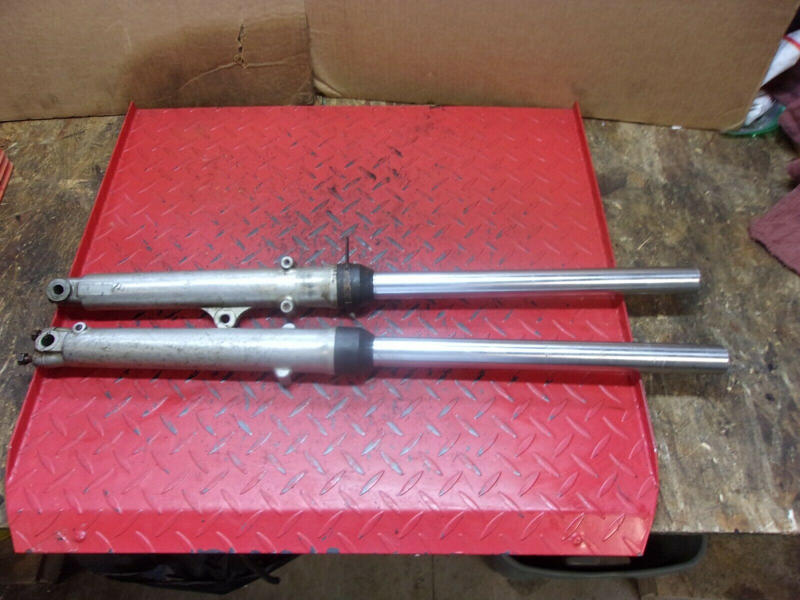

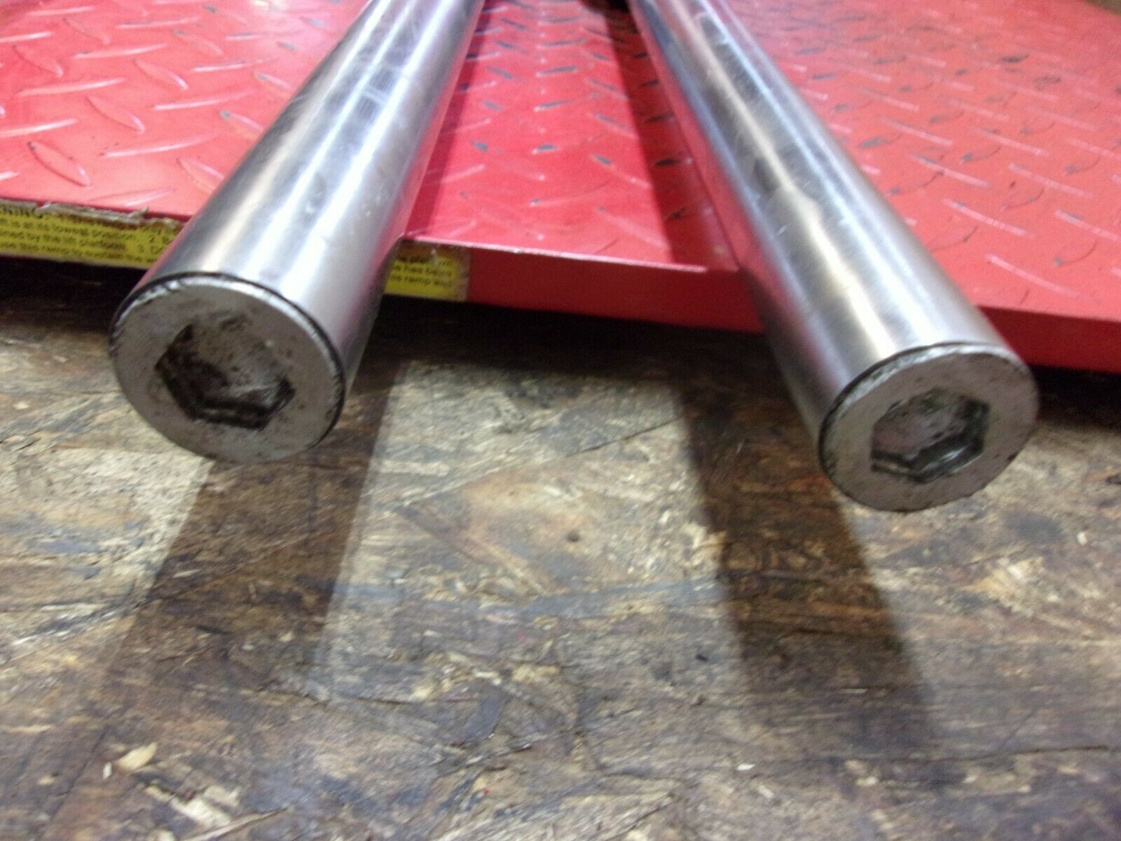

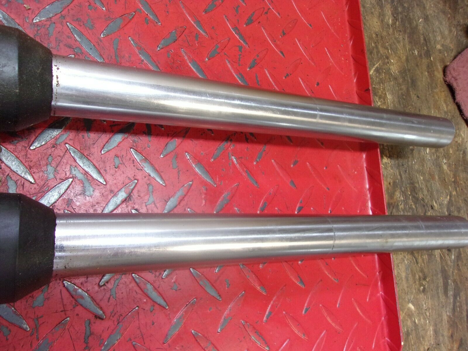

A very common upgrade to the TY175 is putting TY250 forks on. Stock 175 forks are 28mm, 250 are 35mm. Significant stiffness is gained. Maybe not a huge deal for those little grandkids, John - but my fat azz and lack of smoothness in sections won't be so kind on the skinny tubes. :mrgreen:
From what I've read, the triples are cast from the same mold - so you can simply bore out the 175 triples and it's a bolt on.
Unfortunately, they're getting a little tough to find. I started scanning eBay yesterday, and as luck would have it - a set turned up this morning. Not terrible - $150 delivered. Pics look OK (eBay photos attached), hopefully nothing too unexpected upon arrival.

You are a little off on your fork sizes, Ty175's have 30mm forks and TY250's have 34mm forks and the TY350 mono has 36mm forks

Thanks for the correction, Steve.

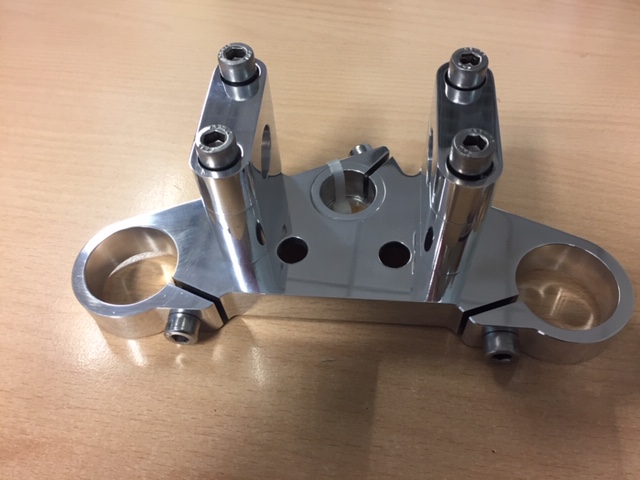

Related to forks - are you running a modified stock top yolk/clamp or did you go with aftermarket? There's a guy in the FB TY group that gets great reviews - Bryan Dix. He's a fair bit less expensive than others I've seen. A pic of his is below.

I'm getting a TY250 billet top like shown above and will use the stock lower, bored out. The aftermarket tops are flat, which lends to better steering geometry since the bars are in a more modern placement being up over the tubes. The guy who makes the one pictured in my last post will make the clamps to support standard or fat bars (I'm getting fat), and offers them in your choice of height between 30-45mm in 5mm increments. I've not decided on height yet.
