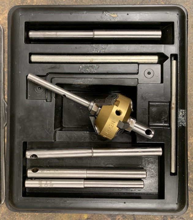

I have a Neway small engine seat cutter set for 30º and 45º available if it will help you out.
The range is from .625 to 1.00" The smallest pilot is .214".
NEWAY MINI.JPG (189.68 KiB) Viewed 30883 times

I just got a set of those (plus the intake is too large for that).

I guy can never have too many tools, right? If you ever get into any 'big valves' I have the large Neway set that goes up to 2.25". It includes the valve facing tool.

Thanks on the larger valve tools- really, really appreciate the offers.

I got all the valves done. The Neway setup worked a treat.
