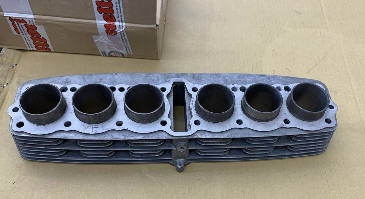

I’m waiting on some parts I ordered, so I think I will start putting the bottom end together. I’ll start with pistons in the cylinder, then offer it up to the case- inserting the crank and hooking up rods. Then gearbox. That is a fairly easy way to deal with all the rings for 6 pistons. They are small and the cylinder has a taper- so just hand pressure should be fine. I scored a special deal on a new cylinder, also new pistons/rings. The original cylinder is certainly usable, but the price was good enough that I bought it. Never hurts to have spare stuff- maybe to trade for other things if nothing else.

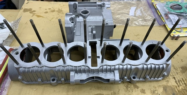

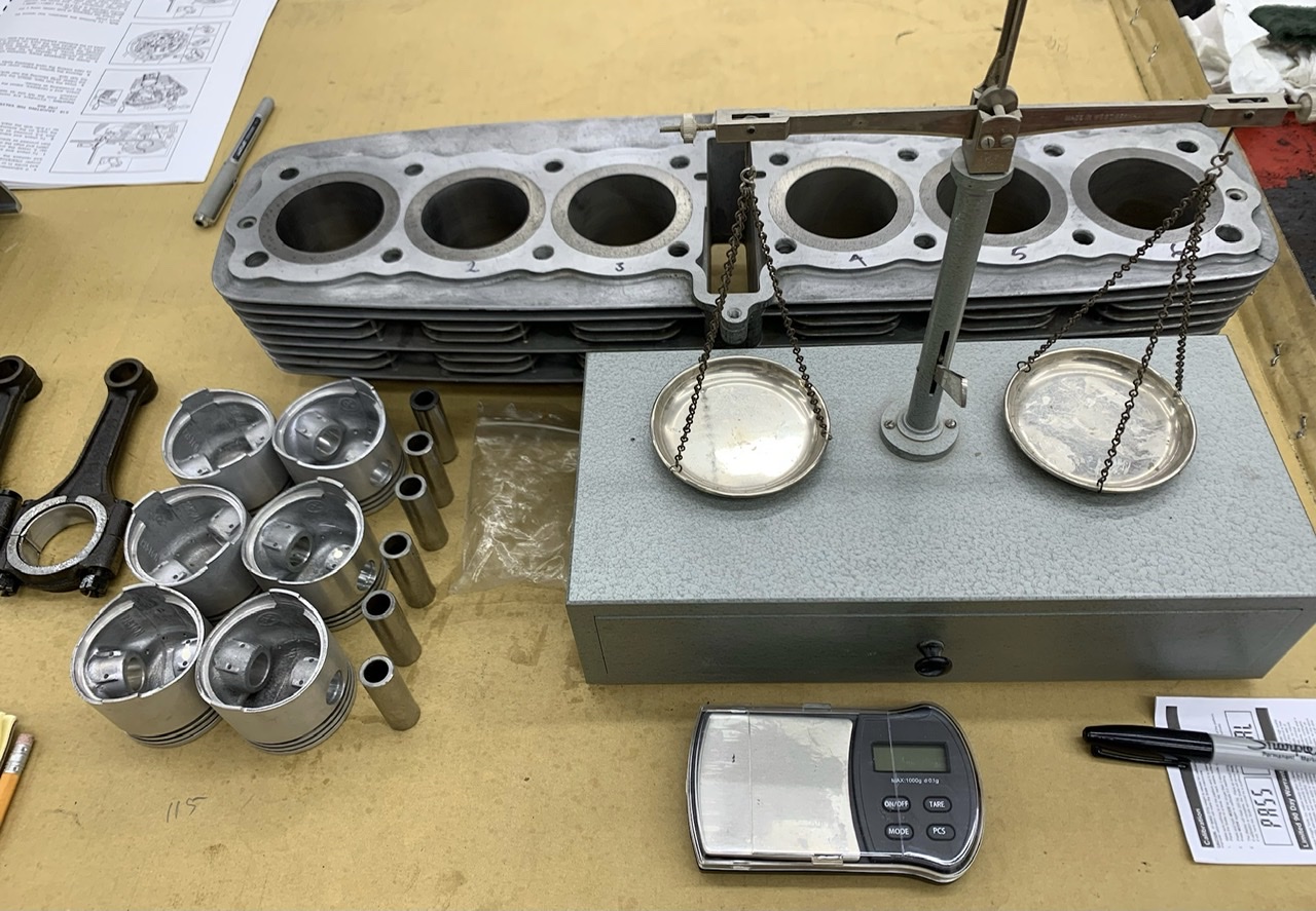

I’ve started working on the Sei engine.

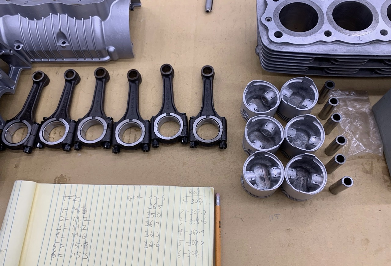

Cleaned up cylinder, threads on case studs, weighed pistons and checked ring end gaps.
Pistons are within 1/2 Pennyweight (12 grains or .77 grams). I need to check pins. With pistons this small (114 grams) I suspect if I get them as close as I can it will make a difference in smoothness.

Postby Lotus54 » Sun Mar 21, 2021 8:18 pm
Doing some weight checking- try to get them as even as possible.
The old scale is from the Dental Lab, weights are in Troy Pennyweight...
Posts: 649
Re: Benelli 750 sei
Postby John H » Mon Mar 22, 2021 7:58 am
Looks like jewelry Mark. Beautiful.

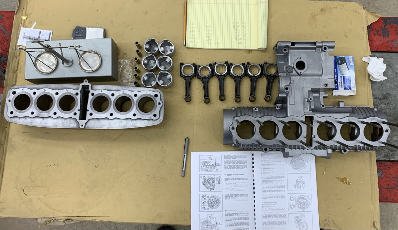

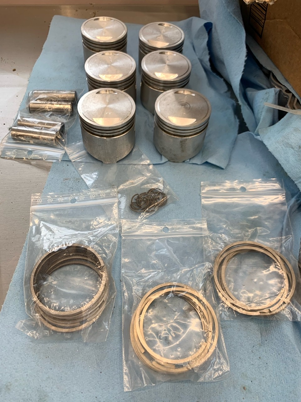

Postby Lotus54 » Mon Mar 22, 2021 6:54 pm
Pistons/pins/rings/rods all matched and together.

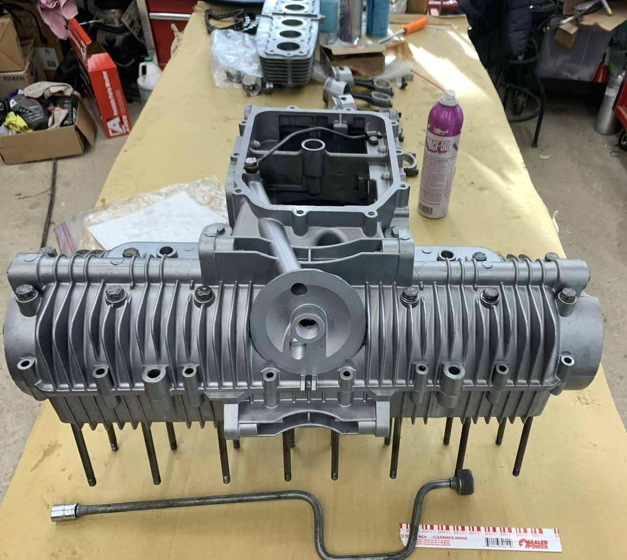

Installed main bearings, popped the crank in and bottom case, measured all the main clearances. All great.
Then take it back apart, get ready to install pistons in the cylinder- then cylinder to top case. Drop crank it and connect all the rods (I measured one set to make sure I didn’t get the wrong one, but I’ll measure each one).
Then gearbox etc.

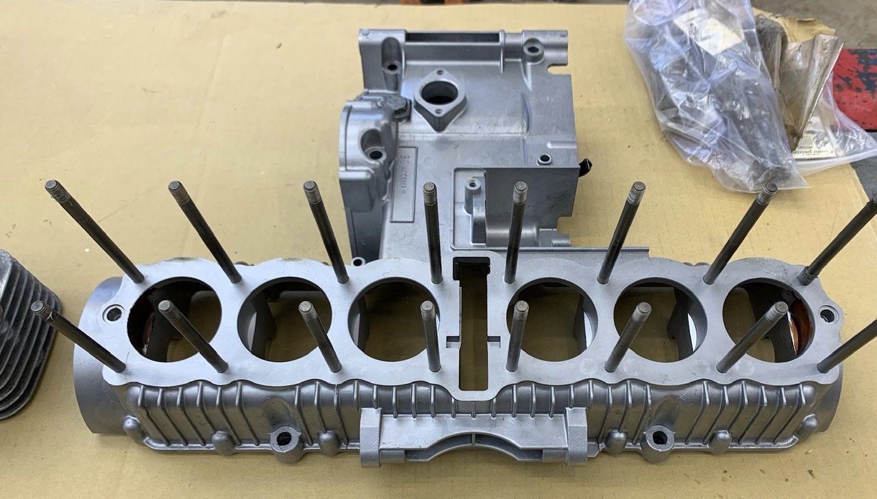

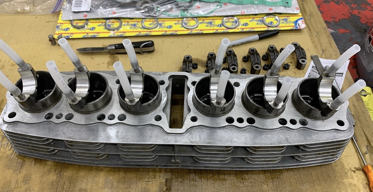

Postby Lotus54 » Wed Mar 24, 2021 8:09 pm
Pistons in the cylinder.
Getting ready to pop the cylinder on the top case- but of course found I must not have ordered the two ‘O’ rings that go on the oil feed pins between case and cylinder. I’ll look again and make sure, but also asking around for dimensions of the ‘O’rings. I have the old ones, but it would sure be nice to know for certain the size. A leak there would be no fun and cause issues.
Oh well, I knew there would be something I forgot to get!
Posts: 649

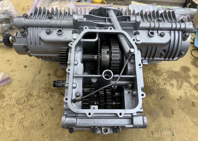

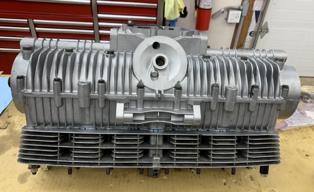

Postby Lotus54 » Sat Mar 27, 2021 8:27 pm

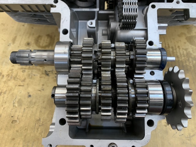

I installed gearbox etc, bolted down bottom half of case.
Still more to do (waiting on some head parts too)- but coming along really well.
All new bearings- including many that were just fine. I don’t want to have to do it again to save a few bucks on bearings.
The gearbox ones are quite good sized.
Those shaft bearings are pinned on the other side.
New primary chain and cam chain. Still need to fully seat the primary shaft.
