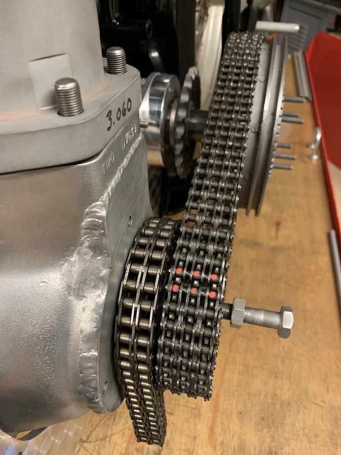

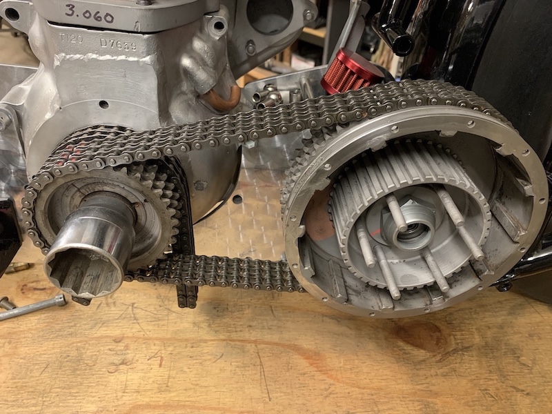

Postby John H » Sat Sep 26, 2020 7:52 pm
Thanks to Jay the photo issue has been resolved.
The drive line special sprocket is finished. It took extra heat and pressure to get both sprockets lined up perfectly.
IMG_3078 copy.JPG (214.93 KiB) Viewed 26124 times
The next step will be adding a 1-1/2" socket to the crankshaft for a remote starter. It will be the same starter I built for the Vincent land speed bike.

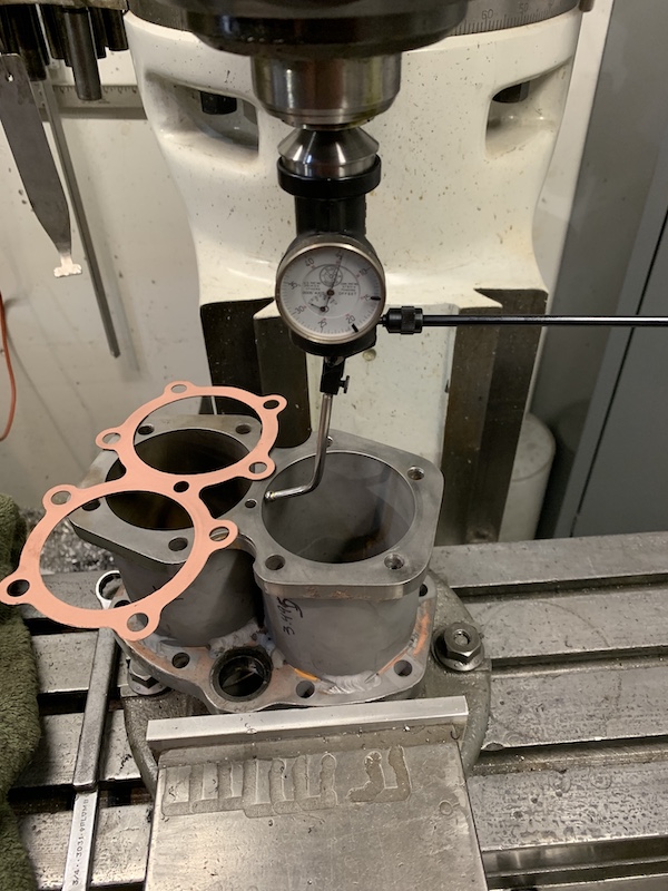

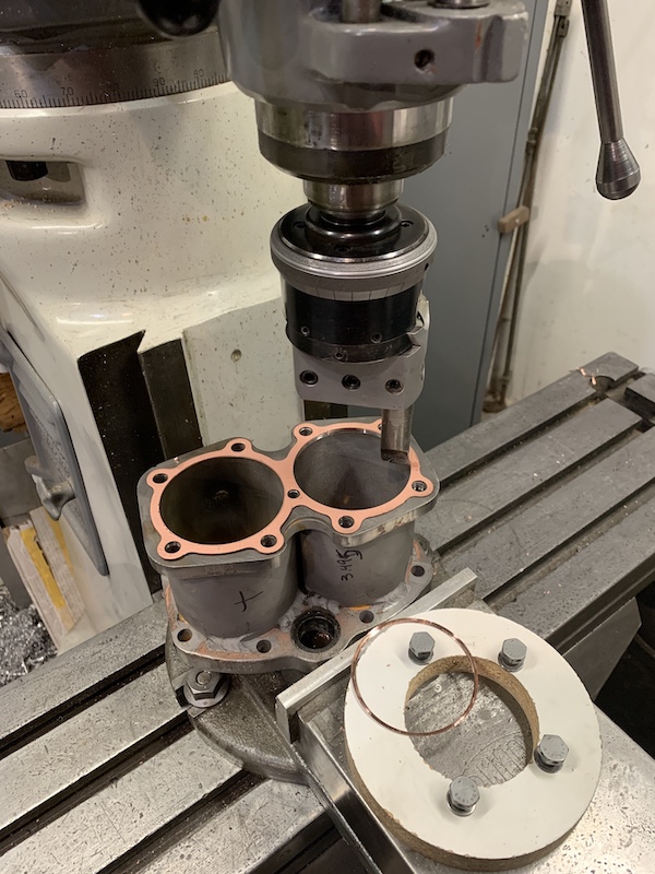

Postby John H » Thu Oct 01, 2020 8:44 pm
Copper head gaskets for the Routt 800cc cylinders are unobtanium. They were made to bolt up to mid 60s 9 bolt heads so I made a fixture using the damaged cylinder and a piece of formica covered wood to hold the gasket in place while opening up the bore.
The copper gaskets are annealed and very soft so not that easy to cut.
IMG_3047 copy.JPG (189.89 KiB) Viewed 26089 times
IMG_3051 copy.JPG (199.54 KiB) Viewed 26089 times
