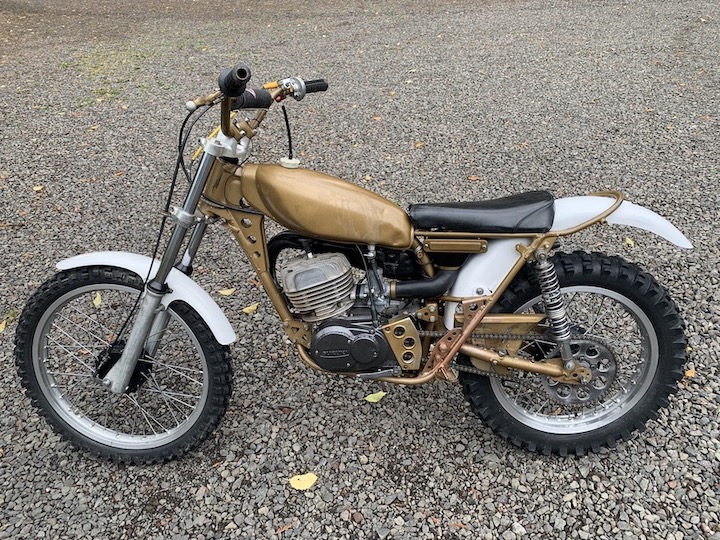

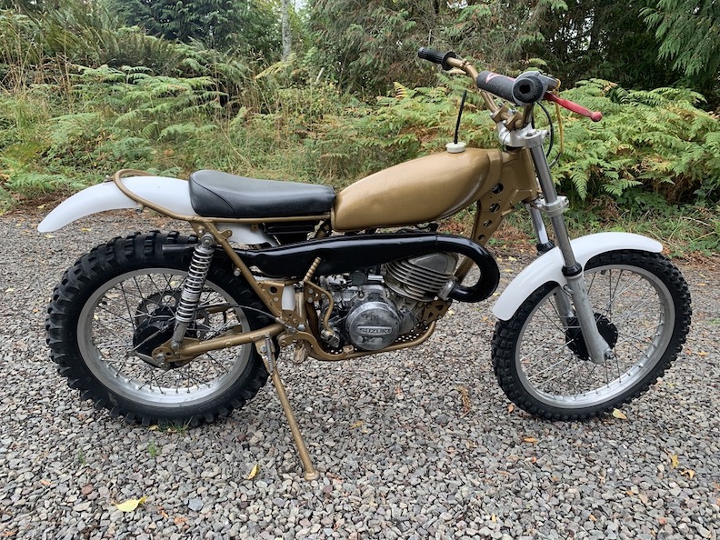

Postby John H » Wed Oct 11, 2023 8:28 pm
The 2 TYs are running great and hopefully will be running great when the grandsons visit next time.
I have been ignoring this RL250 that came with the blue ty purchase. I was surprised with some fresh gas it started right up and sounds pretty good. Reading some reviews online it seems they were not highly valued for serious riders. Complaints included: too much horsepower, gearing not good, forks at wrong angle and frame was subject to cracking. Apparently this bike hadn't been treated to badly as everything is pretty straight except for a few dents in the tank.It's definitely more comfortable for a taller guy than the TY so I'll keep it as the 12 year old grandson is already 5'-8".
