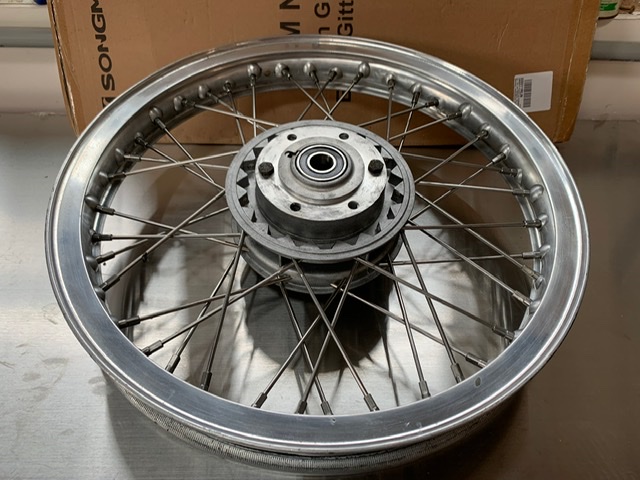

Postby Lotus54 » Tue Apr 28, 2020 8:51 pm
Front wheel is done (now clean and finish polish)
I’m trueing the spare rear now- just got in the spokes for the original rear and the 4-shoe drum wheel I’m putting on my 250 SS.

Postby Lotus54 » Sat May 16, 2020 8:27 am
I have the original rear wheel apart and the hub 1st go through vaporhone. Looks good, but I’ll do one more time.
The sprocket carrier is separate on this bike, so I will vaporhone it and of course replace all bearings. The wheel has 2 double row ball bearings, sprocket carrier another 2 single row.
I’ve been putting off cleaning/polishing the original rear rim- lots of work and messy. But I would like to get it done soon and get it laced back up with my ‘jig’. I want to start on the 4-shoe drum setup for the 250- but want to get this done first so I don’t have TOO much stuff going on at once.
