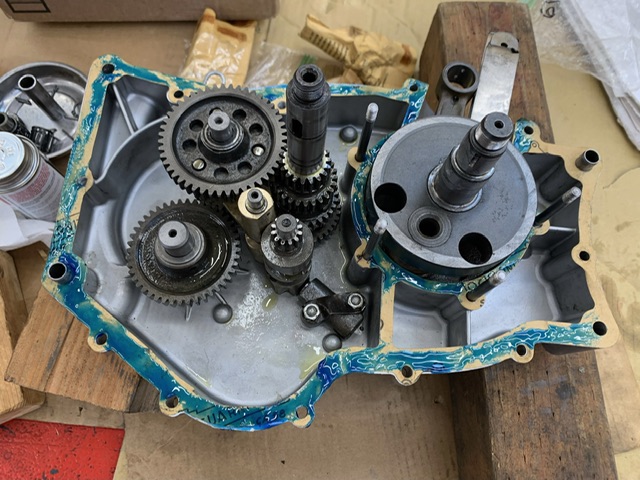

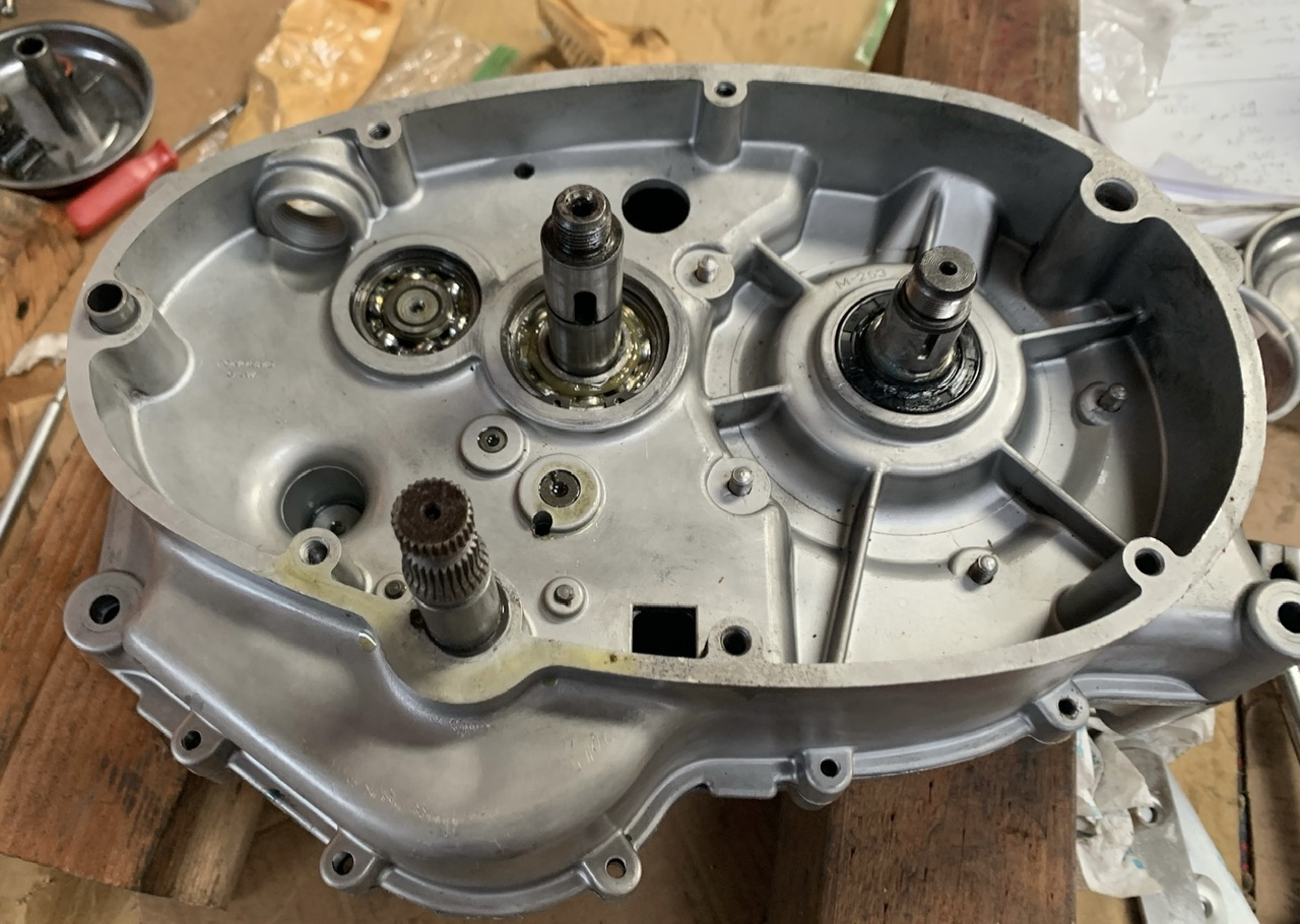

Postby Lotus54 » Fri Jan 20, 2023 5:15 pm

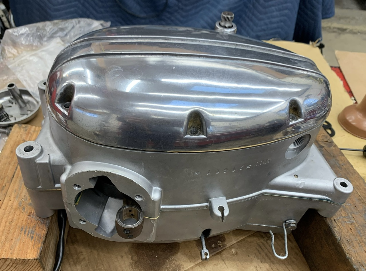

I have the cases together. One picture shows the middle of applying some Hylomar, I finished, smoothed and thinned- so just a smear. Especially wanted to make sure crank area was well sealed.
I did goof up and forgot to put a circlip in the proper order on the shifter. But only took a few extra minutes. It keep the shift shaft from pushing into the case.
The only thing I’ve had problems finding is the wrist pin bearing and pin. I think I have one that will work coming- but will have to wait to make sure. Might have to take a couple mm off the pin lenght.

I'm still very impressed with the mass in those cases. Much like the Aermacchi cases.

The 125 has the same cases (with slightly smaller cylinder stud spacing etc).
Pretty robust for not very high output engine.

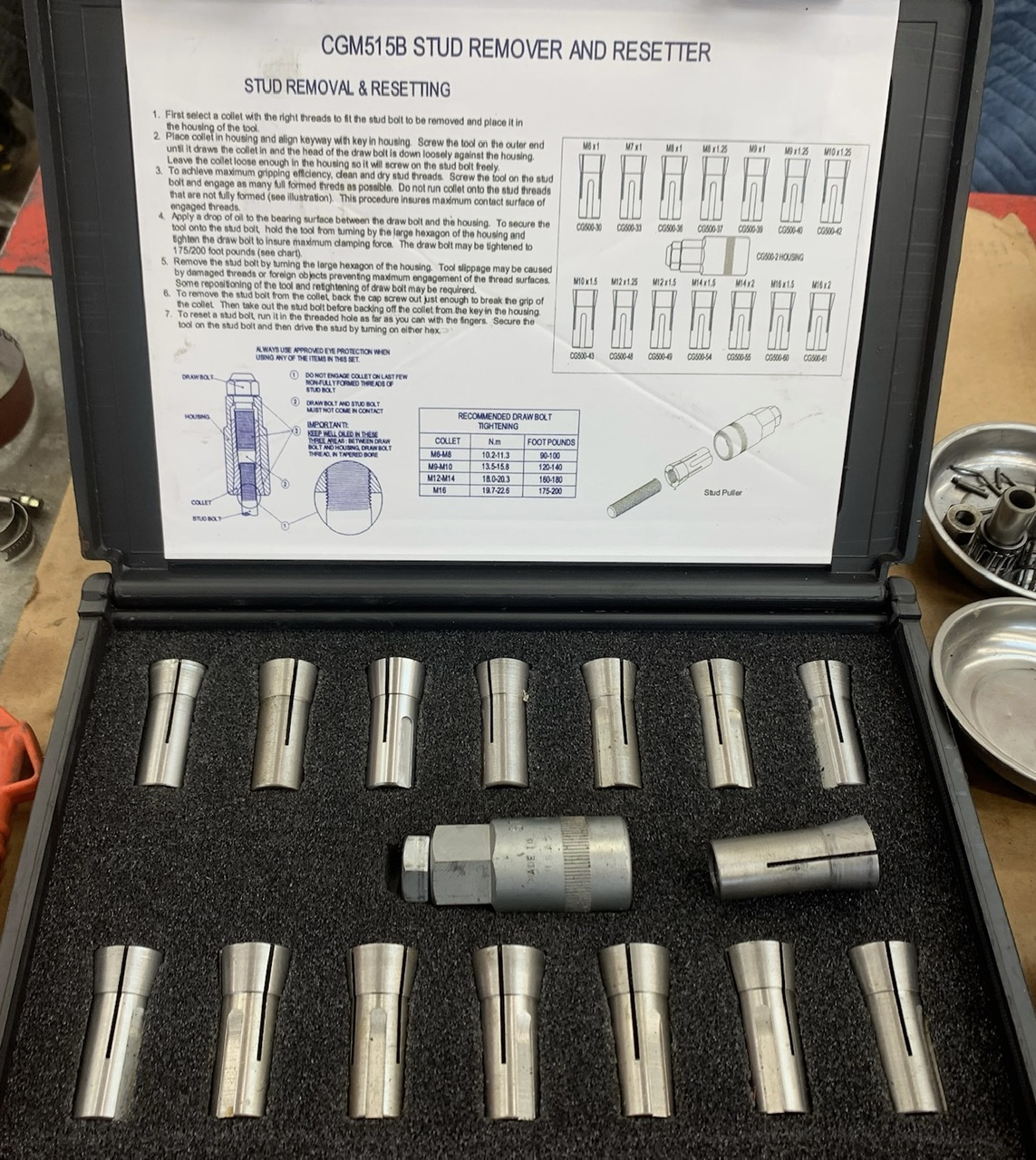

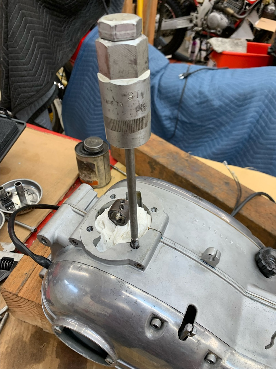

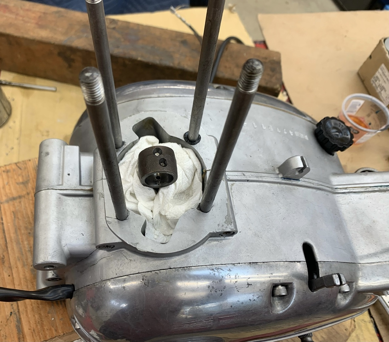

I cleaned out the holes and installed studs. (Then got sidetracked into working on wiper for vaporhoner).
I used the Snap-on stud tool I got unused but second hand. A friend that does a LOT of OSSAs said these are the best.
It works really well.
Posts: 649
Re: 72 Benelli 175 Enduro
Postby John H » Sun Jan 29, 2023 11:43 am
Nice set. I assume they are metric threads, right?
Postby Lotus54 » Sun Jan 29, 2023 6:05 pm
John H wrote:Nice set. I assume they are metric threads, right?
Yes, Metric.
I damaged one original ‘die’ on a particularly stubborn stud. But I cleaned the taper back up on my little lathe successfully. I did get a replacement, but still using original one.
The ‘head’ will work with ‘standard’ thread, but of course need to buy appropriate ‘dies’ (or whatever they call them).

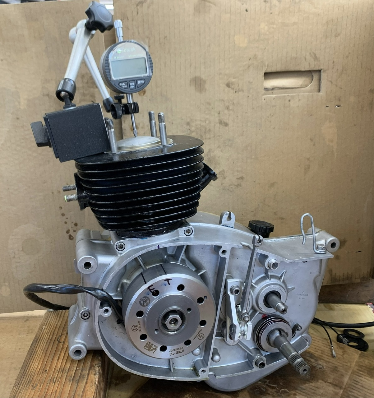

Postby Lotus54 » Wed Feb 01, 2023 12:24 pm
I fit piston/rings/cylinder.
I fit an aftermarket ignition/charging, so have to set timing. They give it in degrees or mm on the flywheel. Of course, the flywheel is a different size. I didn’t think to measure the rod length when apart- with that it is seconds with an online calculator.
I could fit my cam timing wheel- but that would sure take longer than a few seconds.
I suspect this engine is not very touchy on timing, it is fairly modest in output. But it would be nice to know and a lot easier to setup on the bench.
Guess it is time to fit the wheel. (I did transfer from the other flywheel by eye, and likely that is close enough).
