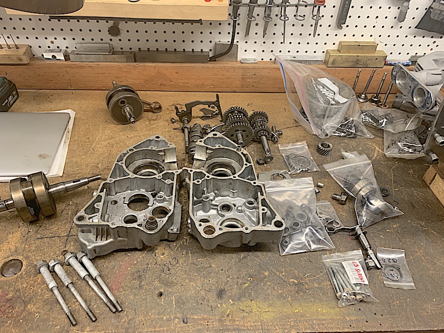

The flywheel just removed weighs 6.4# also and yes it did have red loctite on it. Some scoring on the shaft but not as bad as I expected.
Mark, my welder is a Miller Syncrowave 250. Bought it new many years ago and it has never failed with hundreds of hours on it. I did a root pass, peened it and did a final pass.

Bill's ty looks to be in good shape and with all the trick part arriving it will be a sweet ride.
All bearings and seals will be replaced as well as the piston and rod kit.
With the new clutch basket I think a new clutch pack would a good move.
This would be a good time to get the cases / covers vapor blasted.

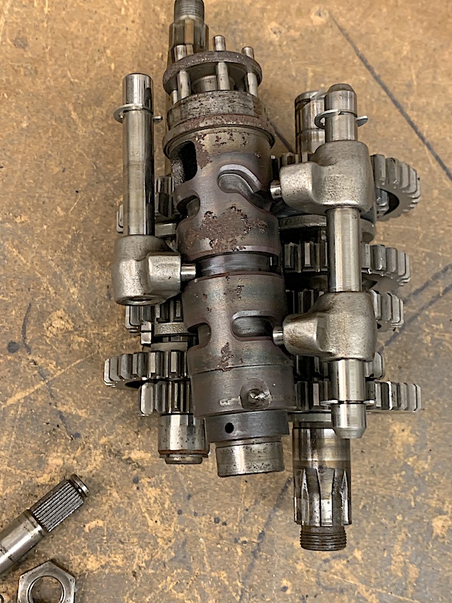

I either need to modify my fixture for separating the crank or just build a new one. Considering the possibility of all 4 of these cranks needing new rod kits, I think I'll just make a new one. There was some surface rust in the gearbox but none on the finished surfaces so it cleaned up ok. I did polish all the shaft locations that ride on non roller bearing surfaces. It may smooth the gear change slightly. The head bolts and studs were cleaned and ospho'd to stop future corrosion.

Postby Da Nag » Sun Jun 27, 2021 7:08 pm
Given that spare motor has a shot gearbox, maybe we should fetch this. Might be nice to have a spare...

Postby John H » Sun Jun 27, 2021 10:19 pm
The spare motor needs everything, so that's a start. Too bad it isn't a complete gearbox with forks, drum and selector. There's another seller on ebay that has the other parts needed. I can't post the link here for some reason.
