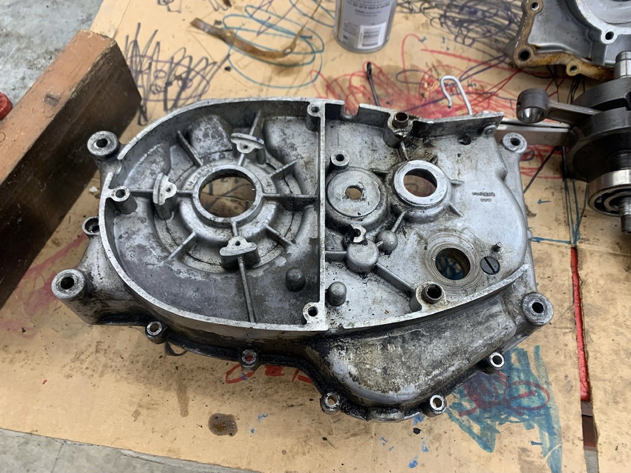

Postby Lotus54 » Sun Dec 25, 2022 1:11 pm
I have taken the 175 engine apart. The countershaft sprocket was a bugger. I did finally get it off, the woodruff key was sheared. I do not know if when pulling it, or it already had sheared. The shaft is tapered also.
I am sourcing bearings etc. The gearbox oil had water in it- and I didn’t trust the bearings without inspecting. Some where not great, so I will just replace them all.

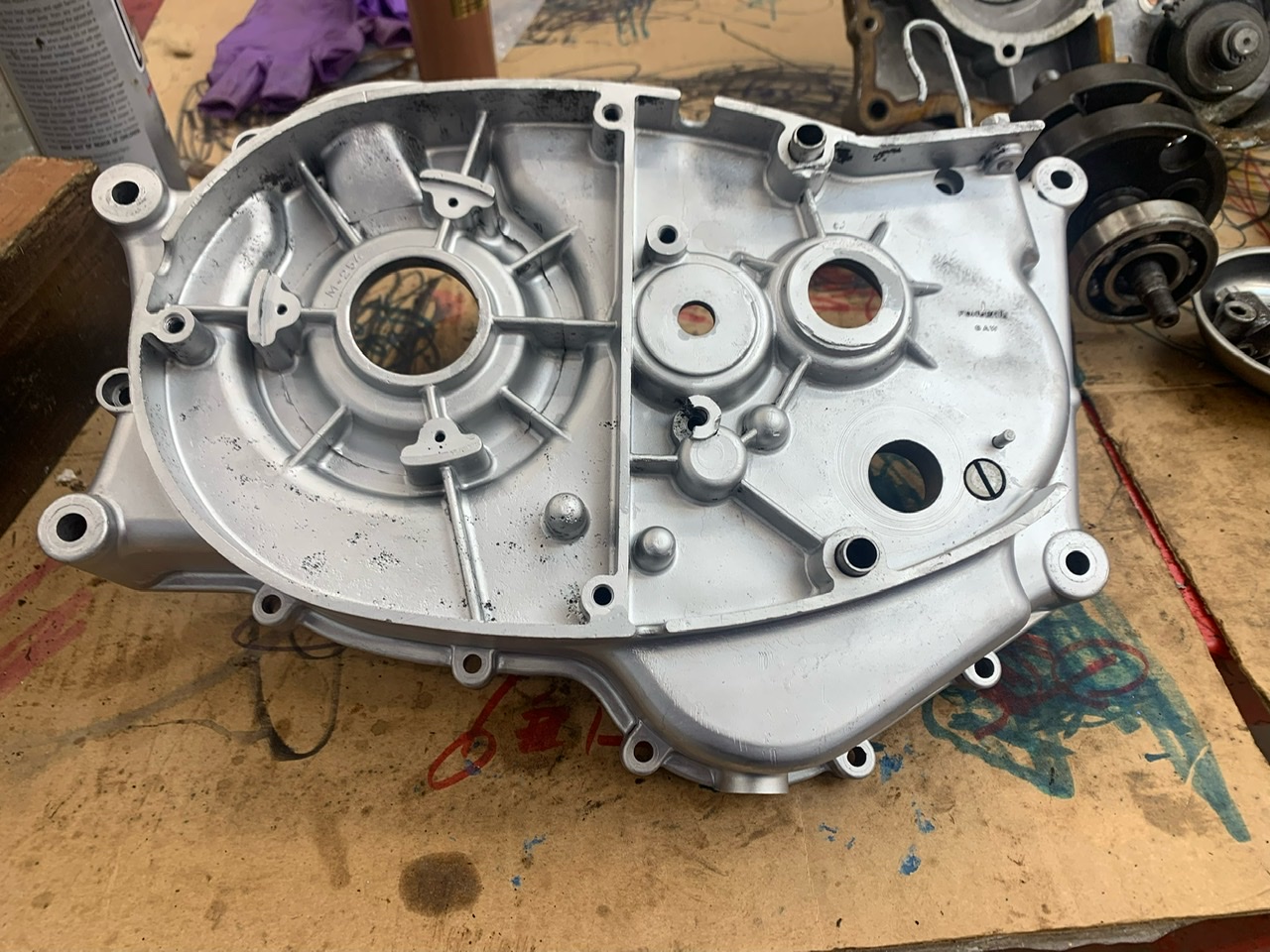

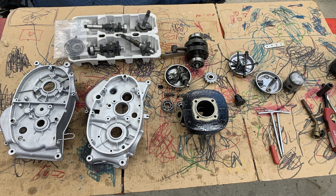

Postby Lotus54 » Mon Dec 26, 2022 10:44 am
Initial cleanup and measuring bearings.

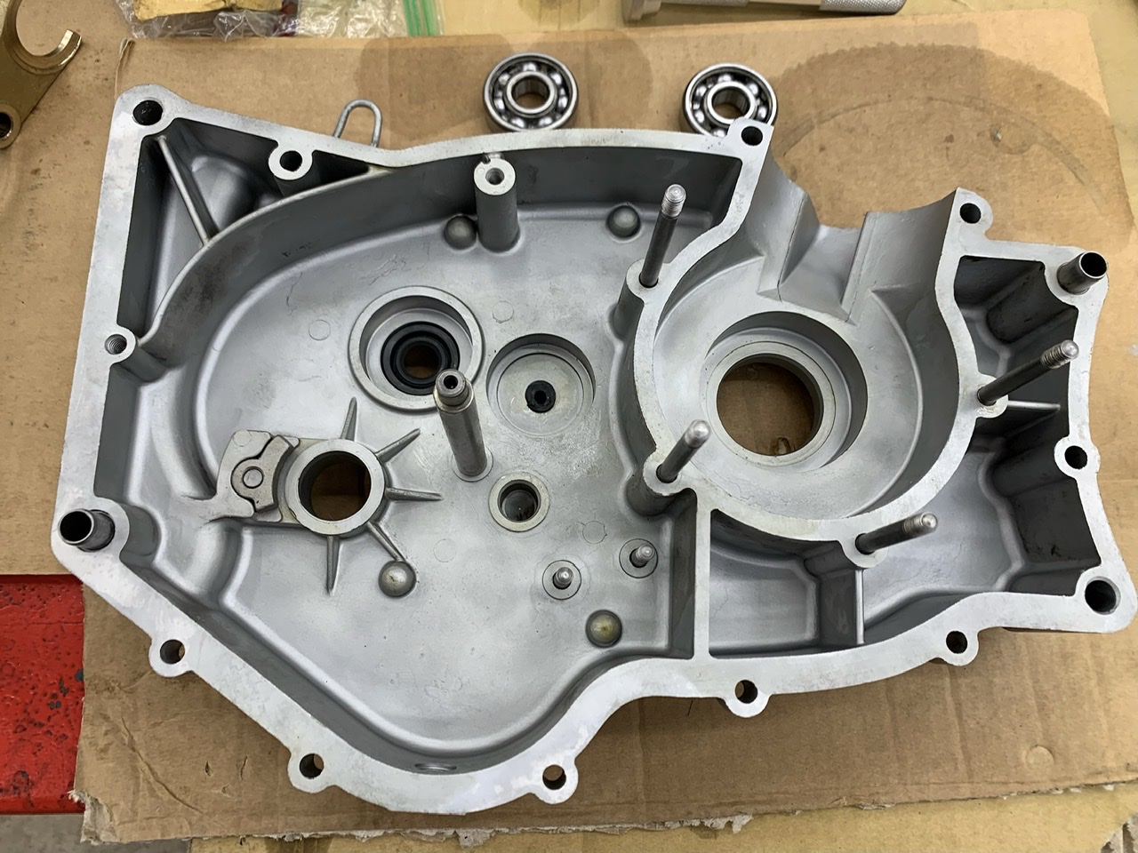

Postby Lotus54 » Sun Jan 08, 2023 12:02 pm
I started to put the engine back together.
But when cleaning some parts I had not done yet- I found the kickstart shaft had some bad splines. I didn’t notice it before. It worked fine, but seems silly to not replace when it is all apart and a NOS part is $17.
So I have as much as I can do until I get that new shaft and install. Then I can put in the crank bearings, bearings on other case side and pop them together.

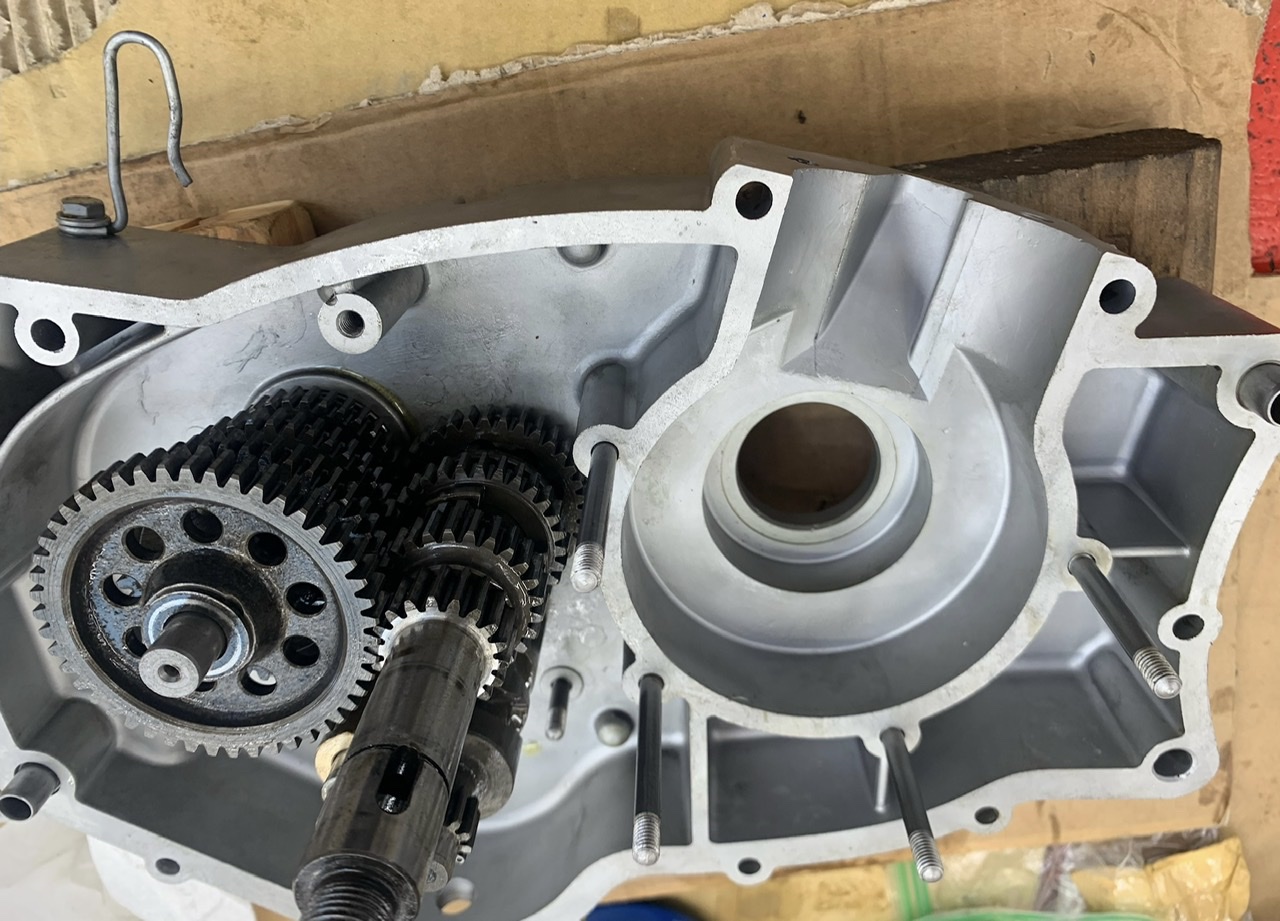

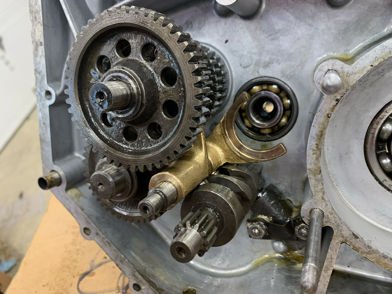

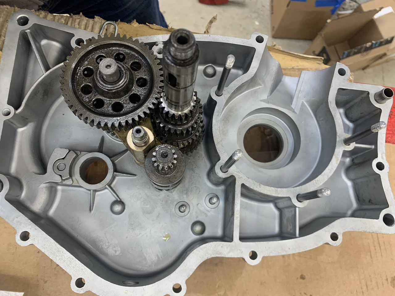

Postby Lotus54 » Tue Jan 10, 2023 7:36 am
The shifter desmodronic drum is actuated differently than others I have seen. You can see the small gear on the end with two marks on it. That matches up to the shift shaft (that the lever goes on and has interesting return springs setup). It has to be ‘timed’ since the shifter gear is only a part of a circle. They have a inspection hole in the case to make sure it is right when the cases are together.
It works well, but the others I’ve worked on have the drum go through the case and the shift lever setup attached on the outer case someplace. Right hand shift with ‘1’ up of course.
