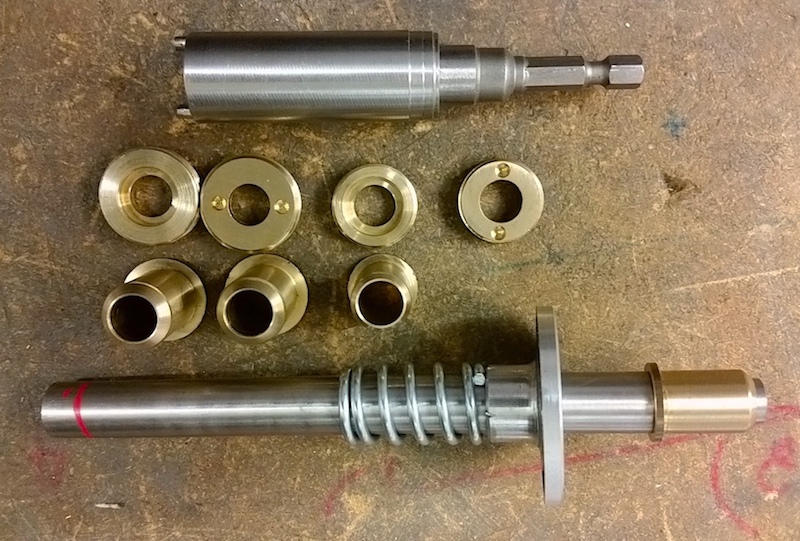

The heads are heated to 300º+ while the valve guides are left in the freezer overnight.
The brass lower guide is on the driver. A modified upper guide will get pushed in place just
before the lower guide is driven in place. A small valve seal is inserted in the retaining collar then

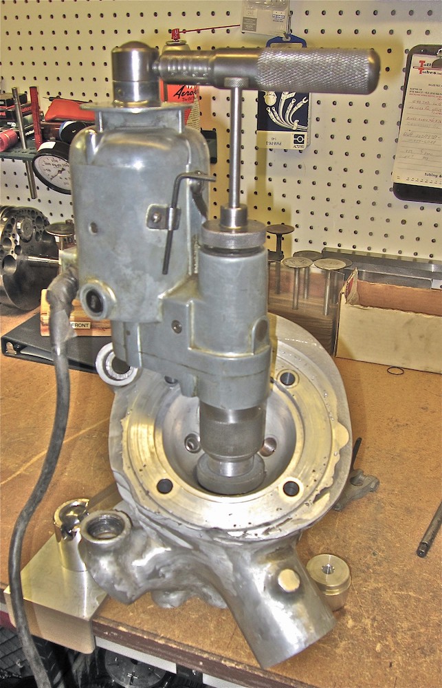

Next will be reaming the lower guide, piloting it off a special upper guide so when all is done,
the bores of upper and lower guides are perfectly aligned with each other.
Then it will be time to grind the valve seat concentric with the new guides.

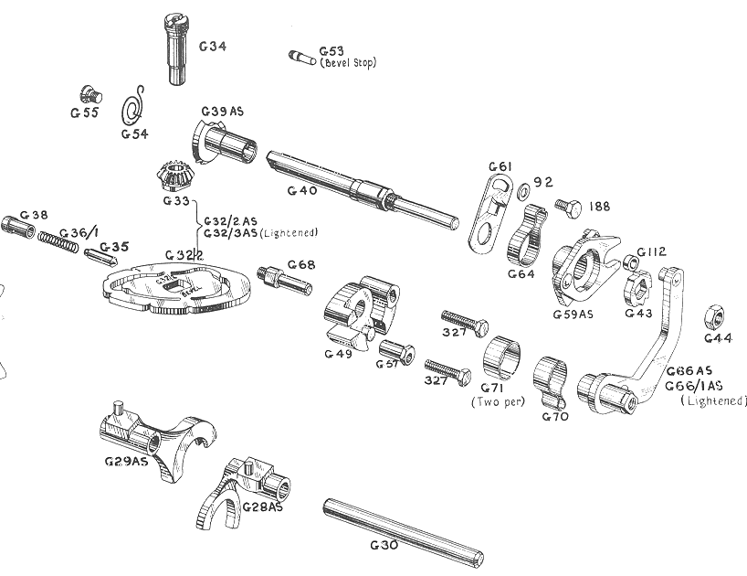

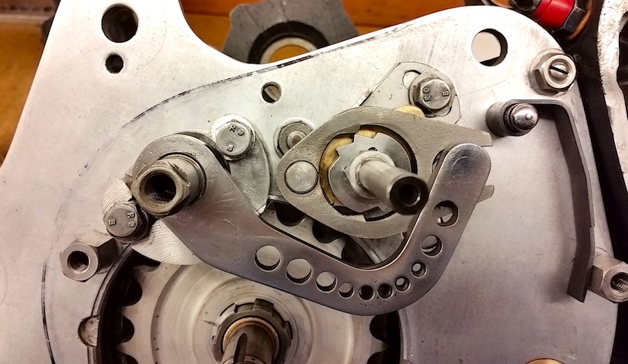

The gearbox is buttoned up with new bearings, bushings and two new shafts damaged by rust. Several mods have been done to improve the gear selection. The gears are heavy and tend to over travel when shifting. Some parts have been lightened as well as some centralizing springs have been doubled up. Next is tuning up the gear selector mechanism.

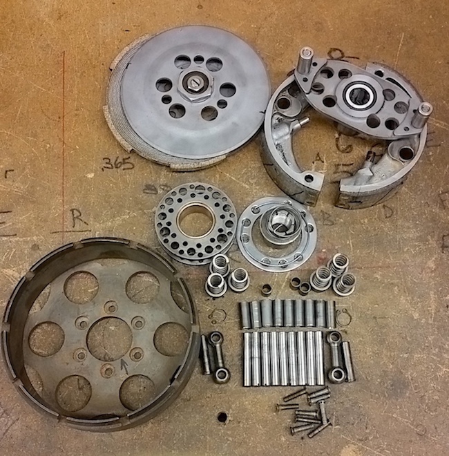

Postby John H » Tue Apr 23, 2019 9:34 pm

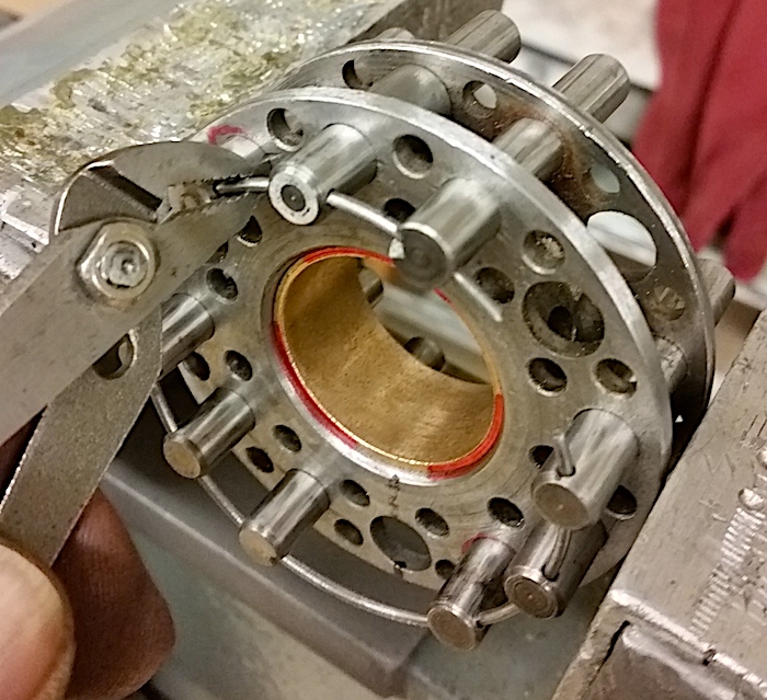

There's around 90 pieces in a Vin clutch. They either work swell or horrible, no in between. When working right, it will operate with one finger. The single disk is operated by the clutch lever and when engaged forces the shoes against the drum. The higher the rpm, the shoe is centrifically forced against the drum harder. On decileration the other end of the shoe is forced against the drum to help slow the bike down. I've replaced the material on the shoes and resurfaced the disk as well as the drum. New bronze bushings have been installed.
The fine tuning comes by shimming the end float of the shoe carrier as well as the spring compression disk. With the springs set, the compression is 330#. This causes excessive wear to the clutch rod. This is the time to add a dab of Stellite hard facing to the clutch actuation arm and also temper the ends of the clutch rod.
That's it for now.

Postby John H » Fri Apr 26, 2019 6:45 am
Well, after two days of frustration trying to get the pressure plate to lift off equally unsuccessfully.
As it turns out, the bearing surface of the C20 retaining nut is not concentric with the main shaft causing
the clutch plate carrier to wobble. Hopefully a new retaining nut will be accurately machined.

Postby John H » Sun Apr 28, 2019 3:26 pm

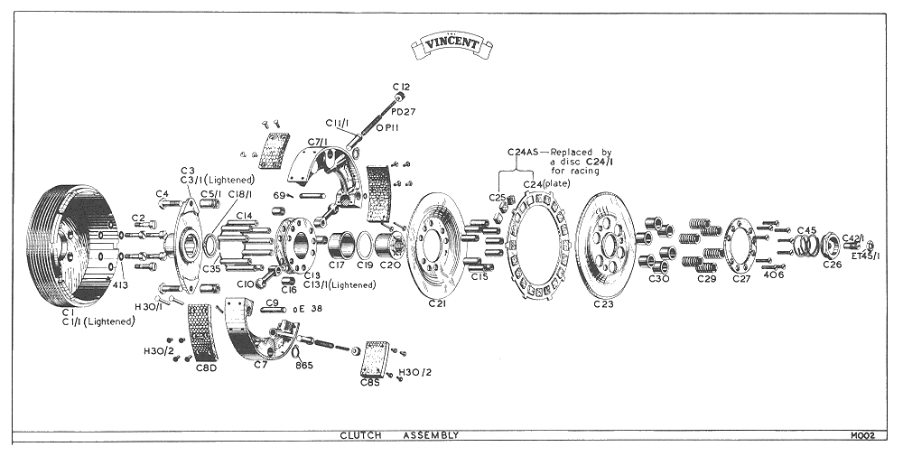

My last post can be better understood with a drawing of the clutch. The revolving clutch parts spin on the C20 retaining nut.
If the nut isn't machined true, this causes the clutch parts to wobble and that makes it difficult to engage the gears.

Postby ATinkerer » Sun Apr 28, 2019 4:57 pm
Looks like just about everything depends on that retaining nut/sleeve to maintain concentricity of the assembly with the transmission input shaft. Can understand why that would make it hard to shift. Made the clutch grab/release also?

Postby John H » Sun Apr 28, 2019 8:02 pm
The wobble causes grab/chatter and never fully releases and that makes the clunk when trying to get 1st gear.
