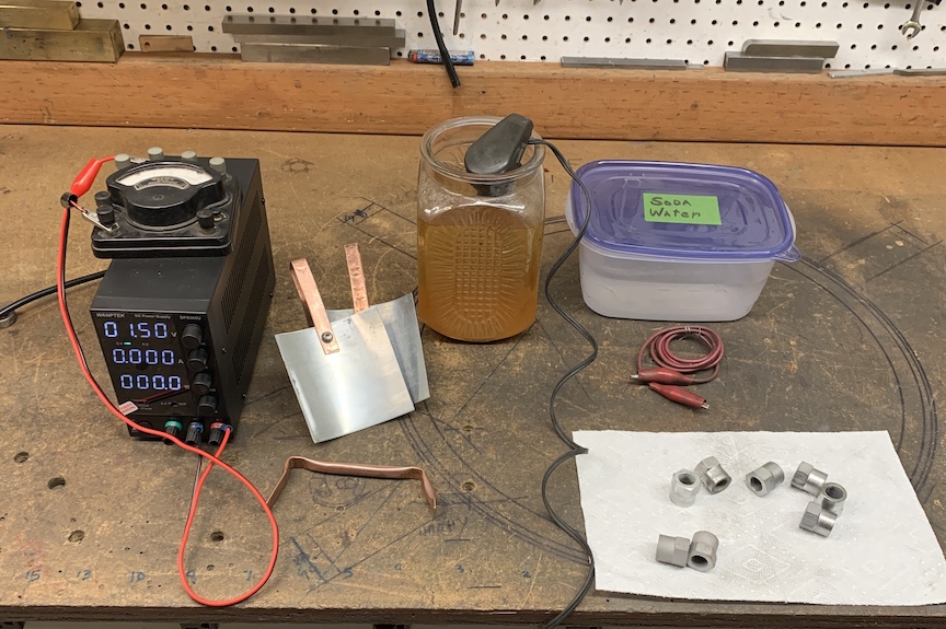

I would like to get the cad plating done in the Seattle area. Art Brass Plating does it as well as chrome plating. Last parts I had plated were in LA. I'm interested in your cad power supply if you find it. I've tried a Caswell kit on a few parts but wasn't happy with the results.

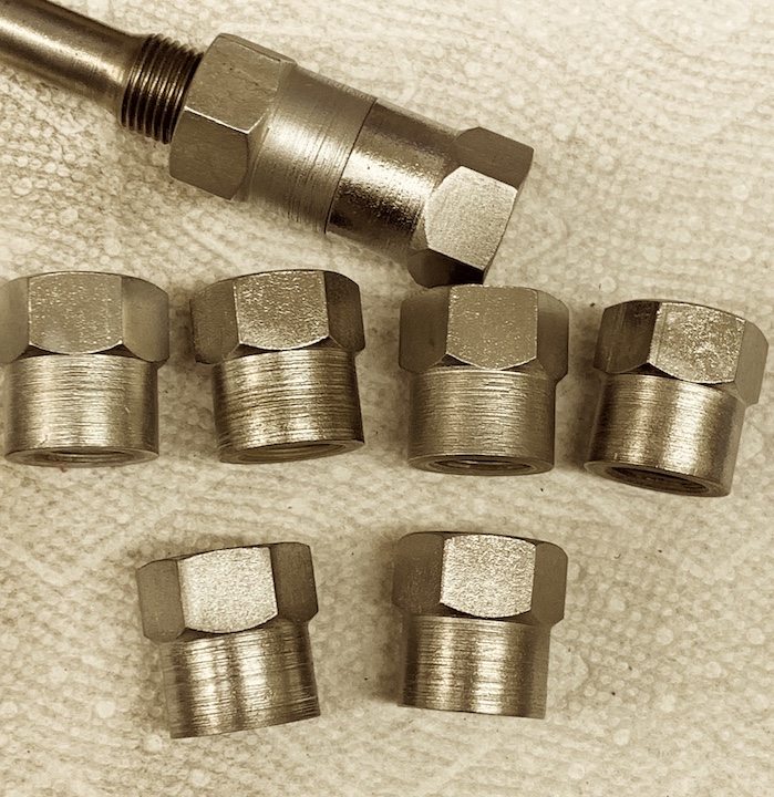

I did get a few more fasteners cleaned up for the cad plating. Also made a few special nuts and extra thick head bracket washers.
I upgraded my Caswell cad plating kit with an adjustable voltage power source which allows for setting the voltage based on amount of surface area. This will be an improvement over the 6 volt battery used in the past.

I have what appears to be the same adjustable DC power supply. Very handy for testing and verifying wiring harness for bikes that have no battery. So far it appears to be working well and no issues.
I like the adjustable current also.

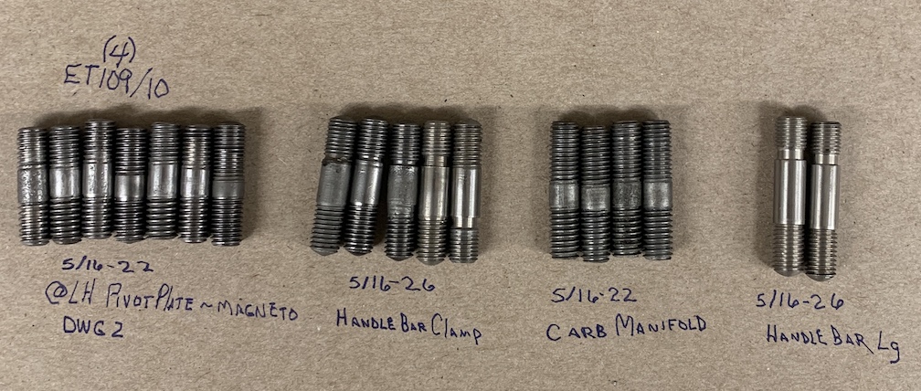

Interesting that they used not only differing lengths, but slightly different thread pitch on similar studs.
I thought I recalled Whitworth used a slightly different angle for the thread cut too? (Over SAE ‘standard’) Maybe I’m remembering incorrectly.

The coarse thread usually is usually anchored in place. Gives a better bite in aluminum. The finer thread is better for holding tightness of the parts.

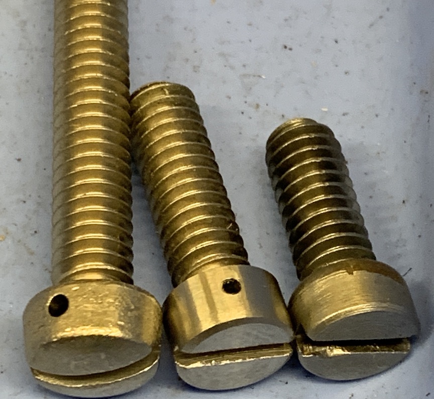

I now have a complete set of ss screws for the covers. I have several boxes of fillister head screws in an assortment of sizes so decided to modify them to like the standard cheese head screws originally used. Heads had to be turned down some and the top faced flat. My assortment of taps and dies are getting tired so have ordered some replacements. The screw on the right is an original steel screw.

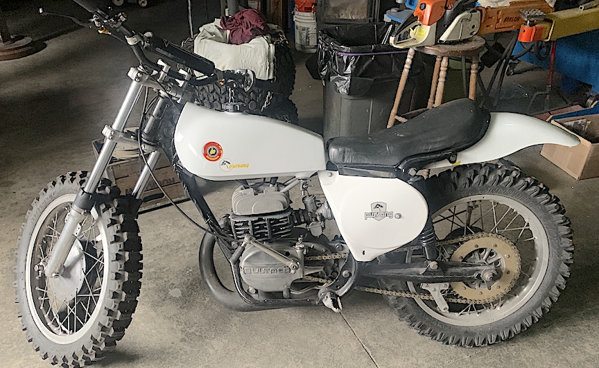

Postby John H » Tue Apr 25, 2023 9:11 pm
My first bike was a Rickman Bultaco Metisse. Then a new Pursang in 72 as well as a 360 El Bandido. Since then I've always had a Bultaco. A few years ago I traded my old lathe for a Mk10/192 250cc Pursang. The Mk10/193 is very similar except it's a 370cc. Both cool bikes and will get restored at the same time.
MK10 193 Pursang.JPG (269.2 KiB) Viewed 69190 times
Re: Shadow Build
Postby Lotus54 » Wed Apr 26, 2023 11:15 am
Looks very nice. Is that a rear wheel on the front?
I got another OSSA, an Explorer- he traded me for a Phantom frame I had. I don’t need it (by any means) and I think I will just get it operating and sell/trade.
Darn Spanish bikes anyway. Ha!
Posts: 649
Re: Shadow Build
Postby John H » Wed Apr 26, 2023 8:11 pm
It's the correct wheel, not sure what the plan was with the big knobby.
