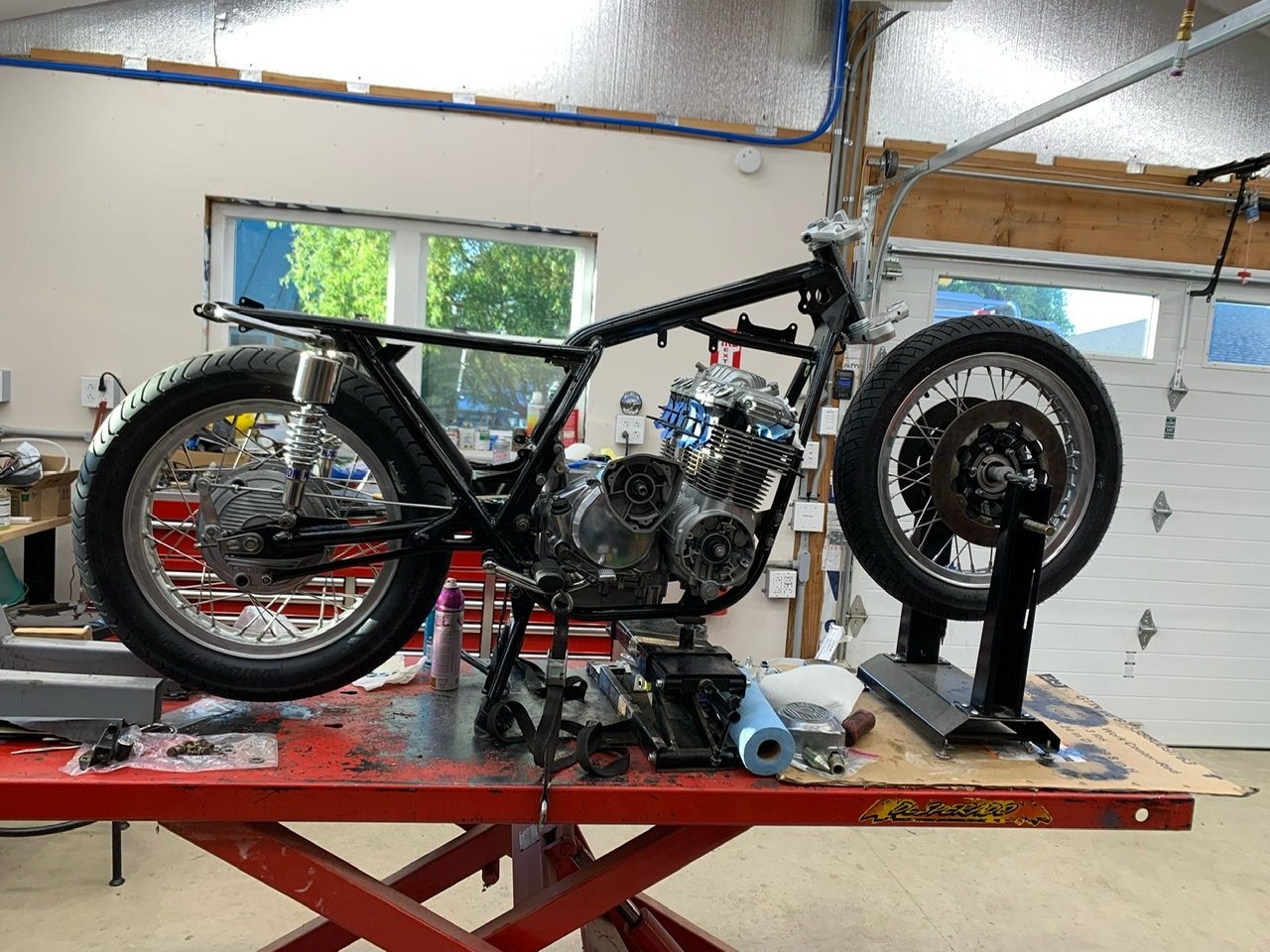

Postby Lotus54 » Wed Jul 21, 2021 1:19 pm
I thouhgt it looked funny with balance stand/wheel in front

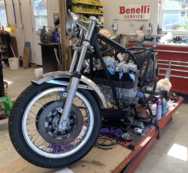

Postby Lotus54 » Sat Jul 24, 2021 8:53 pm
Forks and front wheel on.
I have to adjust the front fender (they changed the mount a bit over the years).
Posts: 640
Re: Benelli 750 sei
Postby John H » Sat Jul 24, 2021 9:50 pm
Ah, that looks more like it. A real roller now. Did you decide how to finish the brake disks?

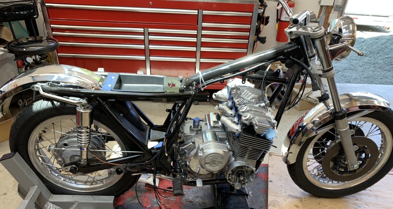

Postby Lotus54 » Mon Jul 26, 2021 2:35 pm
It actually rolled it on it’s own wheels!
Ok- maybe 30cm, but rolled.
I believe I found a US source for the big connectors in the headlamp- I’m replacing those and making a new harness inside the headlamp (main harness is new).
I’ll try to match colours to new harness- and make a decent diagram in colour too.
I’m doing the carbs now. Good thing I have extras, the ones that came off are stuck (soaking) and I didn’t like the looks of some other parts.
But I have one good set (I think) and working them over.
I was considering mounting the new exhausts- but I’m sure they would just get in my way. So I’ll finish some other things first.

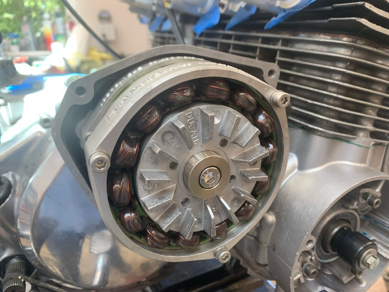

New ‘Enduralast’ higher output alternator installed too.

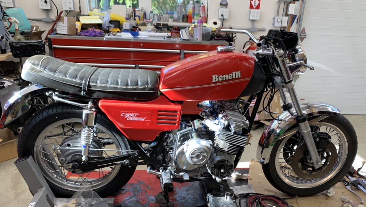

Postby Lotus54 » Thu Jul 29, 2021 6:13 pm
I’ve been moving along. Sometimes I have to wait for paint to dry (and mount) or clean it up first or…
But more and more.
Chain is on (I got an O-ring)
Footpeg mounts all painted and new rubbers
Correct screws for clutch side done and tightened
Kickstart installed
Master cylinder rebuilt and on (had to use the mini-lathe to make a special tool)
Brake hoses all on
New calipers mounted
O-rings installed for valve adjustment caps and those tightened
Taillamp mounted in chrome gizmo is uses and will mount soon
All the new wiring connectors are in- so next big job is figuring it all out- and modifying for the new alternator
Those side panels are extras and so is the tank. I’ll be painting the originals.
I vaporhoned the exhaust collar which was painted black. Sure looks neat natural!
