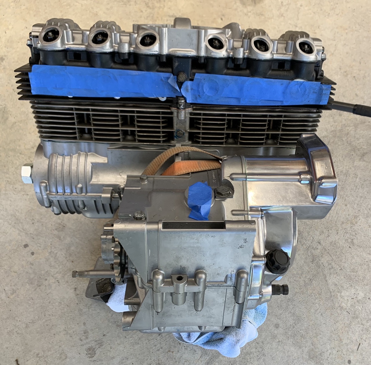

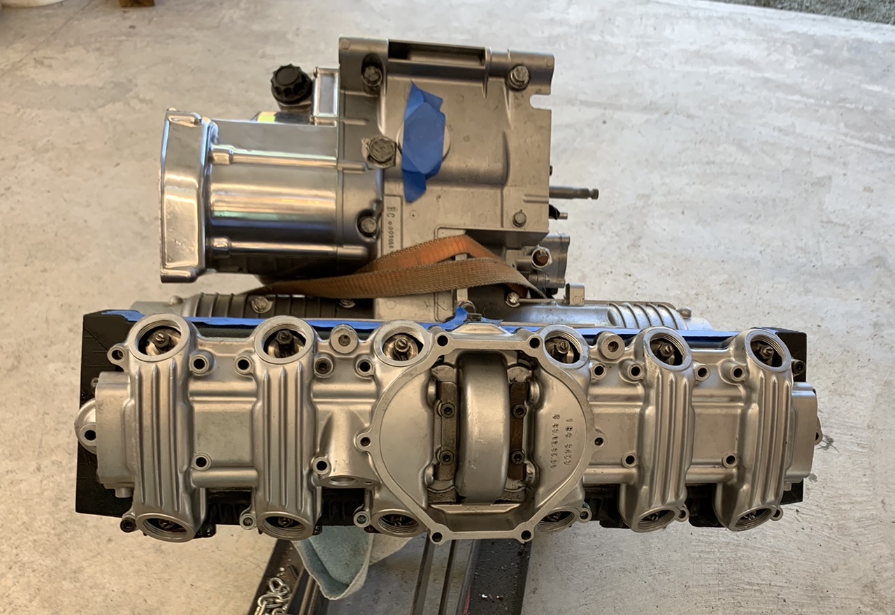

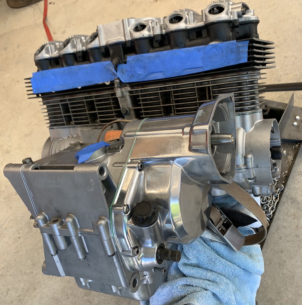

Postby Lotus54 » Mon Jul 05, 2021 8:45 pm
Engine almost all done. I somehow forgot to clean up the rest of the valve cover bolts- so need to do that, torque it all down and adjust valves. Then pop in the new studs.
I have two coats of new paint on the frame, a couple more and I can fit engine.
Posts: 648
Re: Benelli 750 sei
Postby John H » Tue Jul 06, 2021 7:08 am
What a beautiful engine Mark. I would be tempted to make it a display for a while. Bet you can't wait to hear it run.

Postby Da Nag » Tue Jul 06, 2021 12:09 pm
No kidding...that thing is sexy just sitting there!
Can't wait to hear it growl.

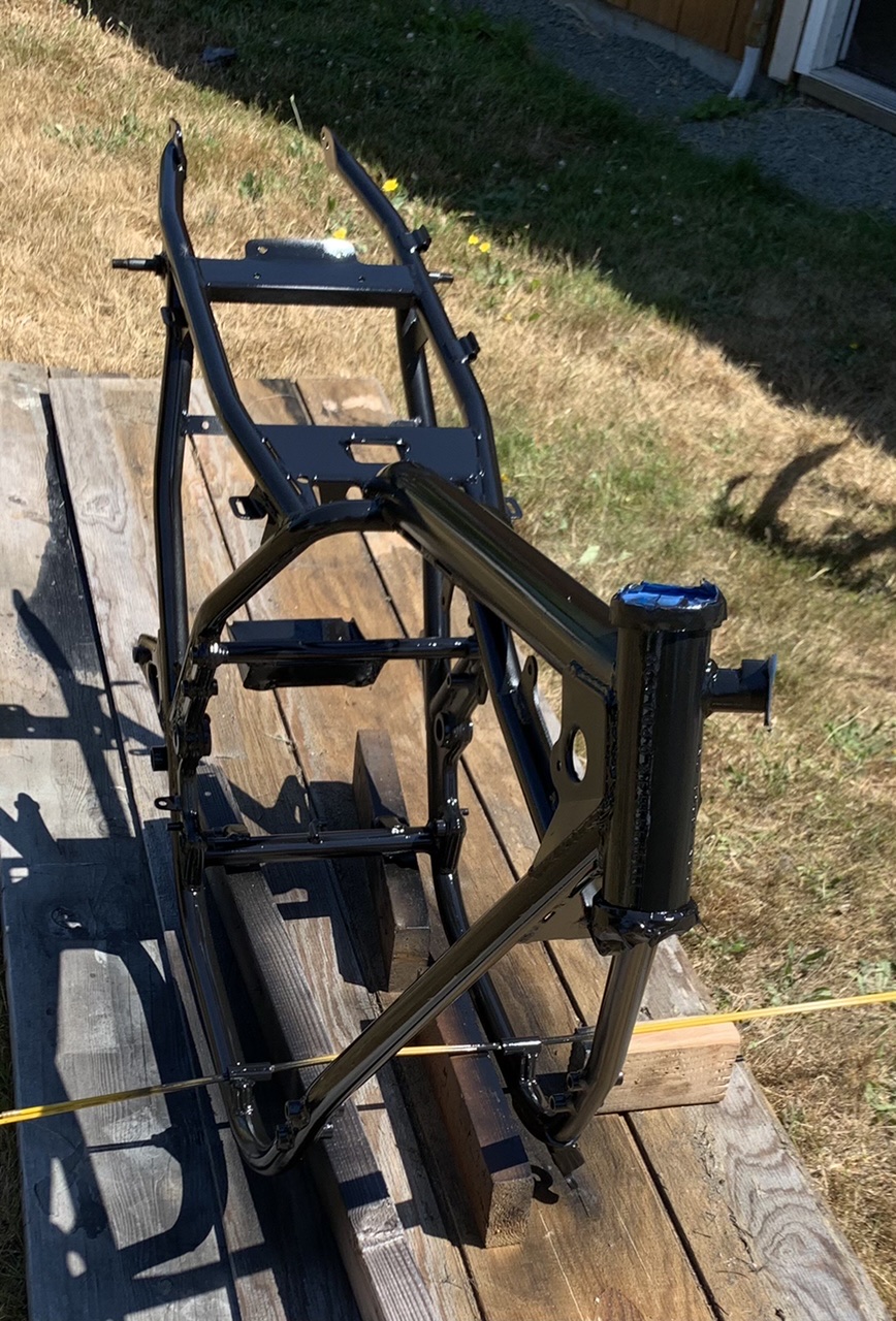

Postby Lotus54 » Thu Jul 08, 2021 2:06 pm
Final coat (for top/sides).
Tyre is in the sun warming up- so I can mount it on the rear wheel.
I’ll put frame over engine after it has cured a few days.

Postby John H » Thu Jul 08, 2021 6:25 pm
Frame looks nice. How do you put the motor in the frame? From the side or by laying them on the side? You mention 'frame over the engine'. Let me know if you need an extra pair of hands.
