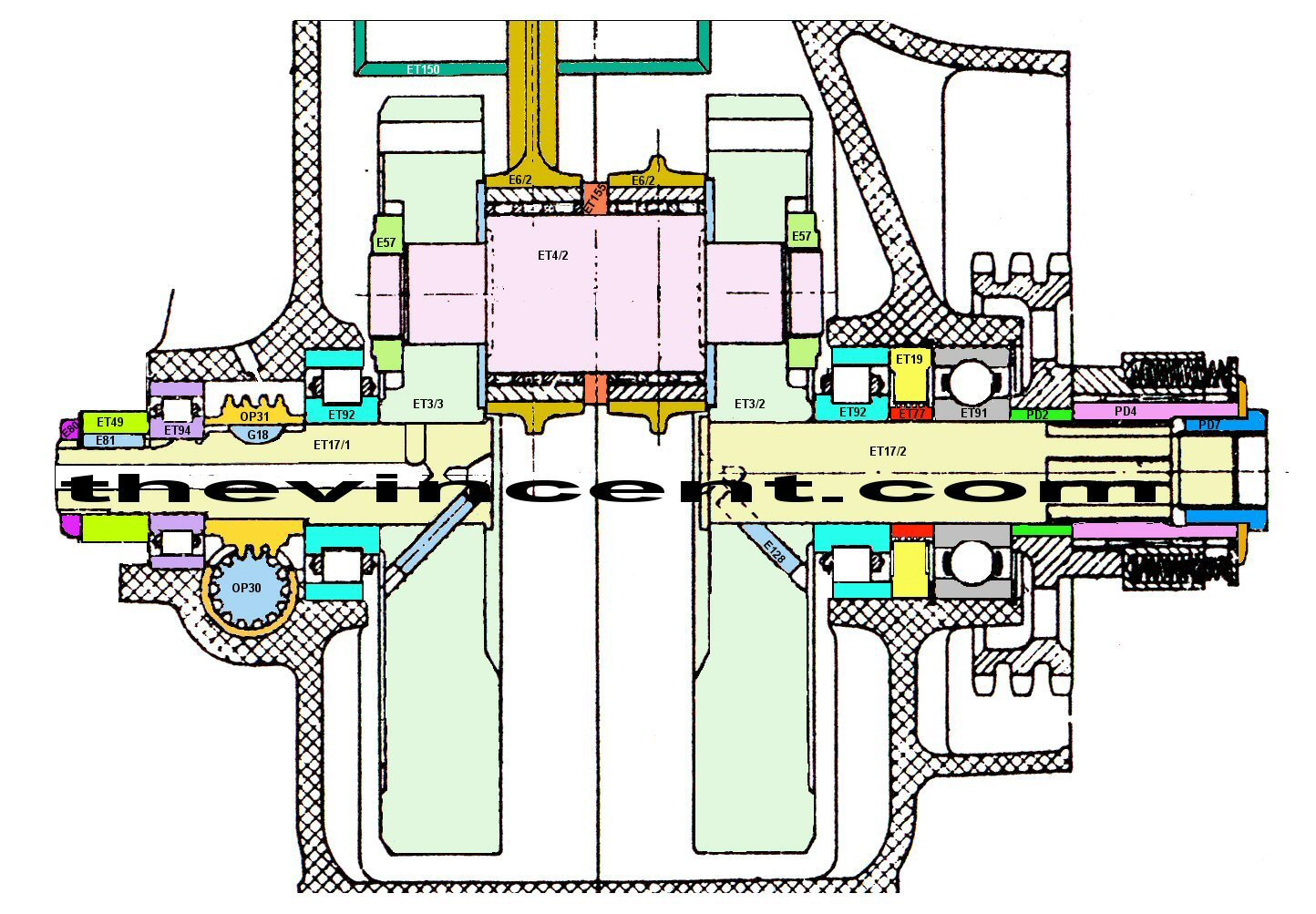

Postby John H » Fri Aug 12, 2022 10:29 pm

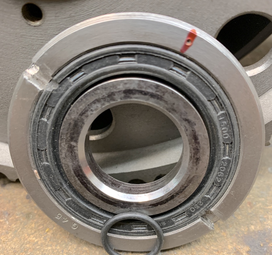

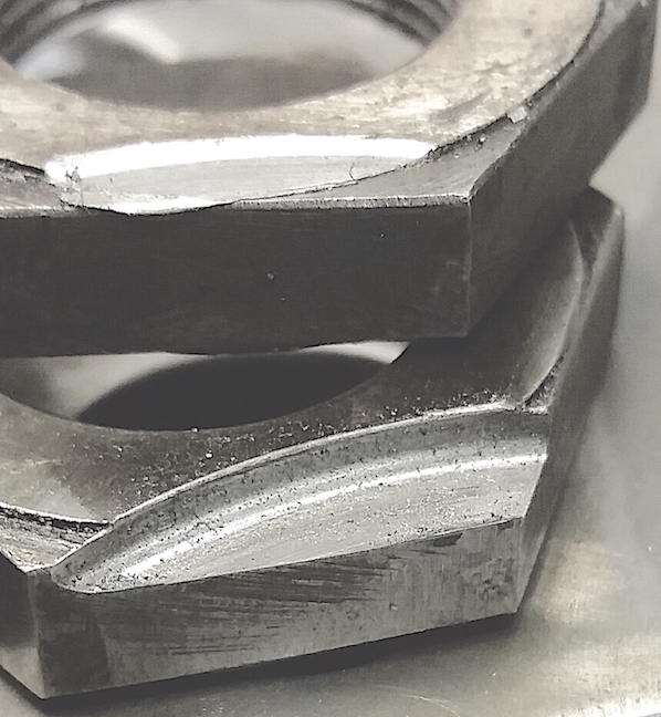

You can see from the crankshaft drawing, both E192 (light blue) roller bearings have a narrowed outer race to clear the nuts on the flywheels. These races are well known to work loose then rub on the flywheel nuts.
A modification I do is to add three 10-24 flat head screws outside the race so part of the screw head overlaps the race.
Nut damage.jpg (283.06 KiB) Viewed 37832 times

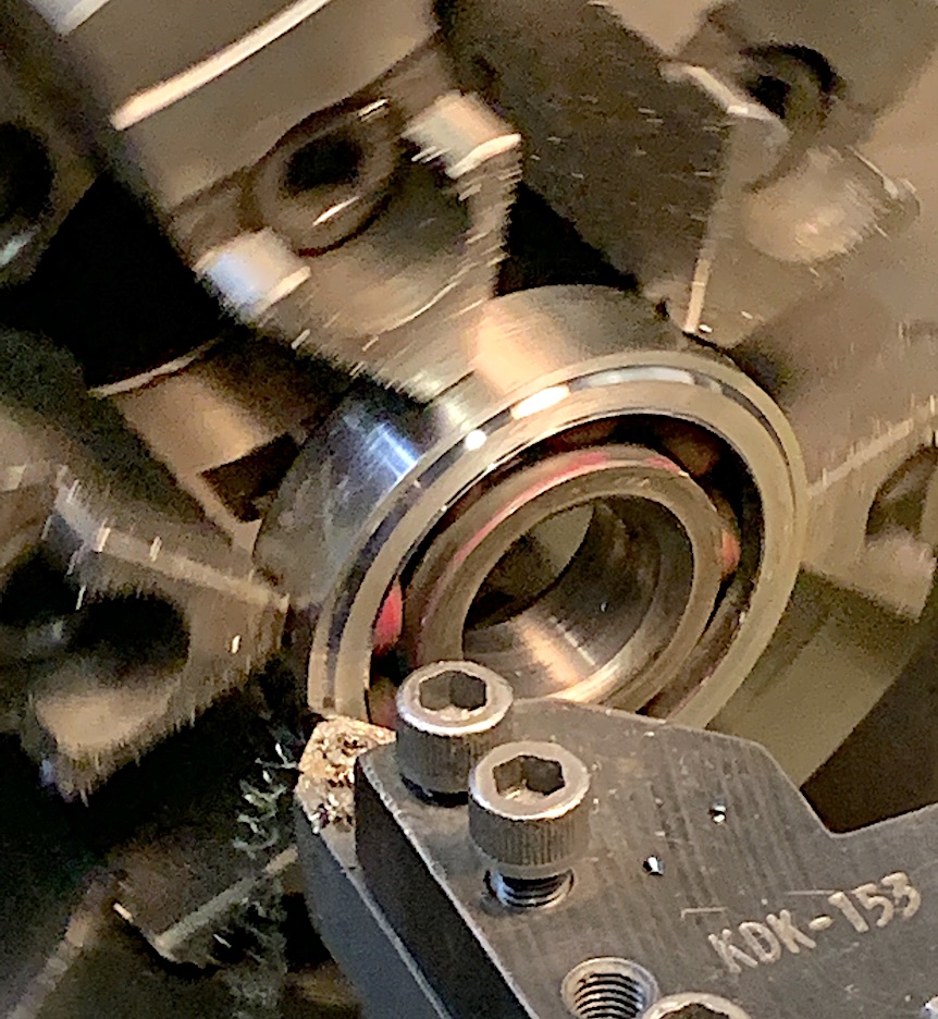

I have turned the outer race of my setup bearings to the same dimension as the E192 race.

Postby John H » Thu Aug 18, 2022 9:39 pm

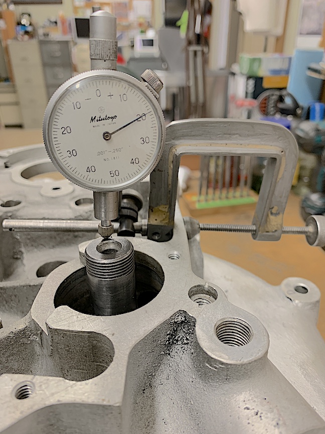

Back to centering the rods in the bores, I have a total of .019" end play. Luckily, all shimming will be done on the drive side main shaft leaving .003/.004 for expansion / contraction of crank cases. With this all set, it's time to check the alignment of the engine sprocket with the clutch sprocket. The gearbox is getting a new main shaft and the clutch sprocket has new bushings so there is a chance some shim or machining will be required.
Crank shimming.JPG (216.07 KiB) Viewed 37790 times

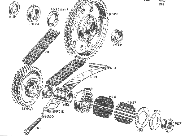

MO14 Primary Drive copy.gif (54.51 KiB) Viewed 37790 times
Re: Shadow Build
Postby John H » Sun Aug 21, 2022 7:41 pm
Aligning the primary sprockets isn't super critical but it is important that the clutch drum sprocket is alligned correctly since the middle row of the triple row chain is what drives the generator sprocket.

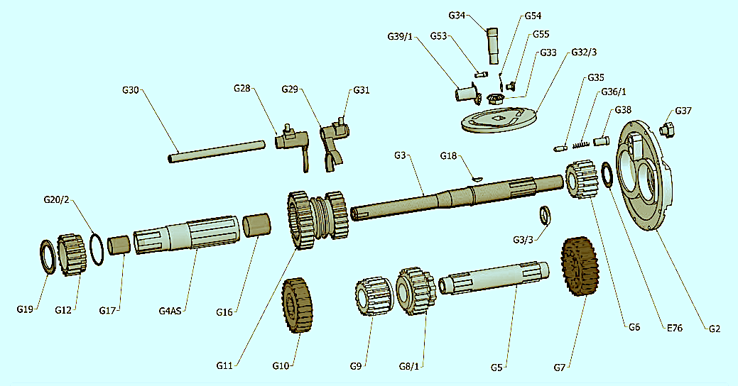

Along with making sure all the gears are meshing full depth it is important that there is a small .005" gap between the G6 gear on the main shaft and one end of the G4AS output shaft as this is the only way oil can migrate to the bushings inside the output shaft. Too much gap and excess oil leaks out between the inner main shaft and the outer output shaft. There is a mod for that I will go into later. Spacers G19, G20/2 and E76 are made in different thickness to help fine tune it all.
Gearbox DWG copy.png (270.73 KiB) Viewed 37767 times

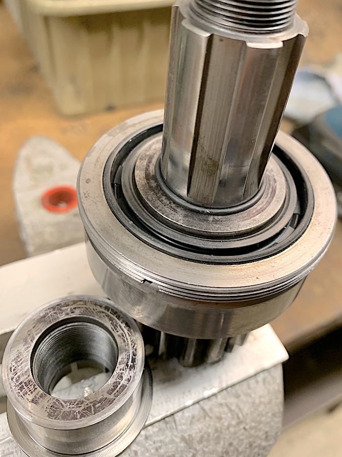

After having second thoughts on using the old G3 main shaft with worn splines I ordered a new one. This along with a new clutch shoe carrier should improve the clutch operation even more.
IMG_6009 2.JPG (248.91 KiB) Viewed 37719 times
Now it's time for the o-ring mod that helps keep oil from the gearbox getting into the clutch. A problem that has plagued old bikes for years. The o-ring will be crushed in the beveIed cut in the spacer. I will still smear a thin film of Yamabond on the splines for additional sealing.
