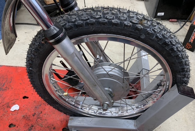

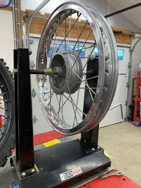

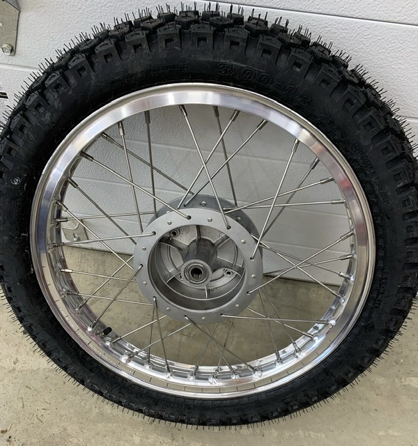

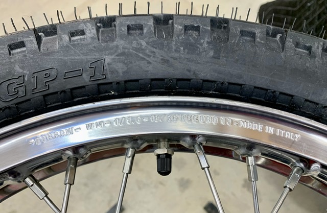

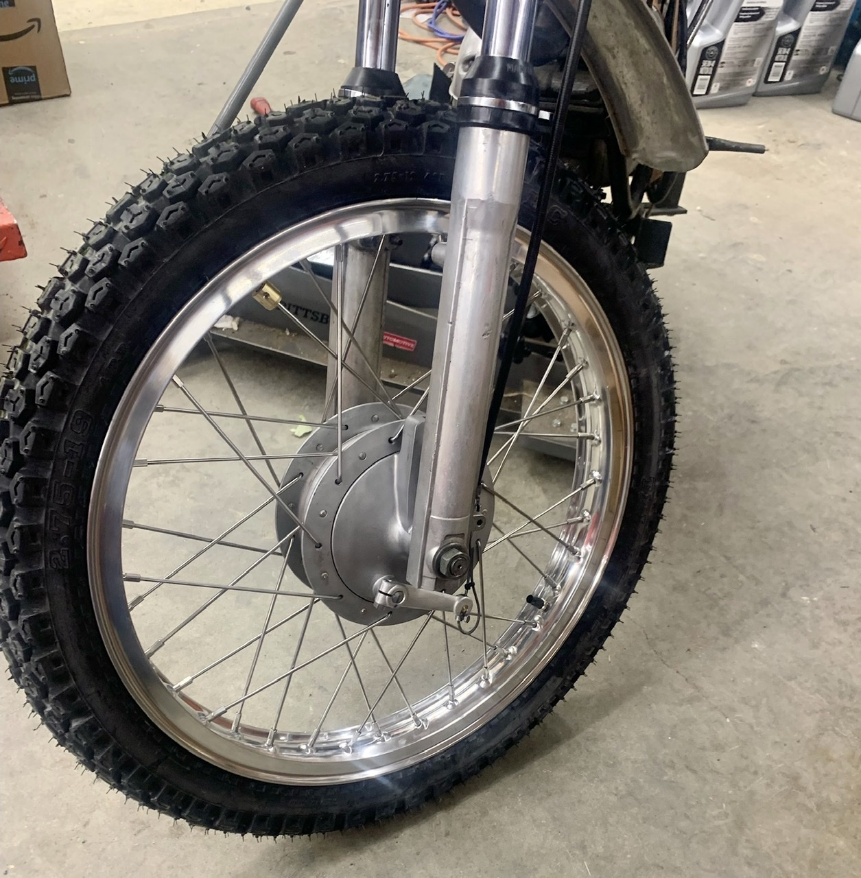

I got the hubs back with new Borrani rims, stainless spokes and nipples and loose laced. I tightened and trued them, popped on the new tyes.
Front and rear tyres are mounted, still balancing front.

Postby John H » Sat Nov 05, 2022 9:57 pm
Beautiful! Record Borranis too!

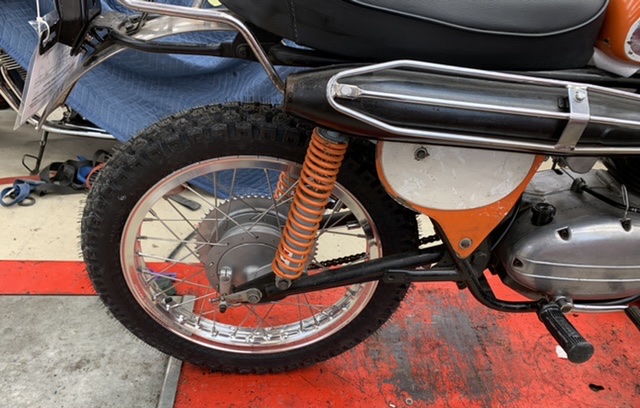

Postby Lotus54 » Mon Nov 07, 2022 5:46 pm

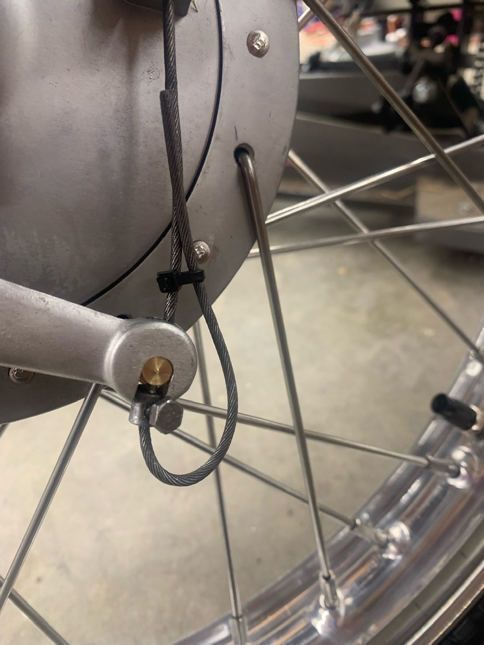

Vaporhoned the brake backing plate and made a little brass piece to seat the cable. Of course I forgot to take off the little ‘end’ when I parted it on the lathe. Oh well.
Looks nice! Of course, now the wheels are worth more than the bike.

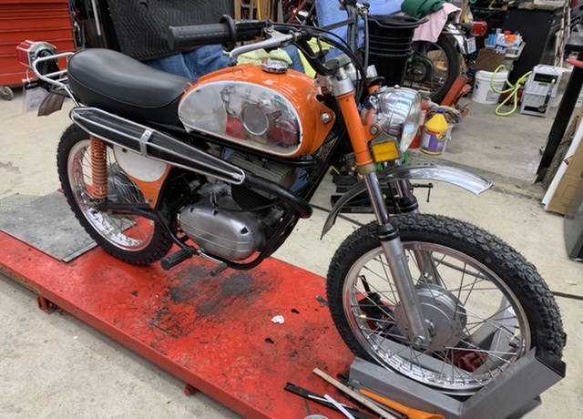

Postby Lotus54 » Fri Nov 11, 2022 6:10 pm
Rode it down the street- found a few more things to address (of course).

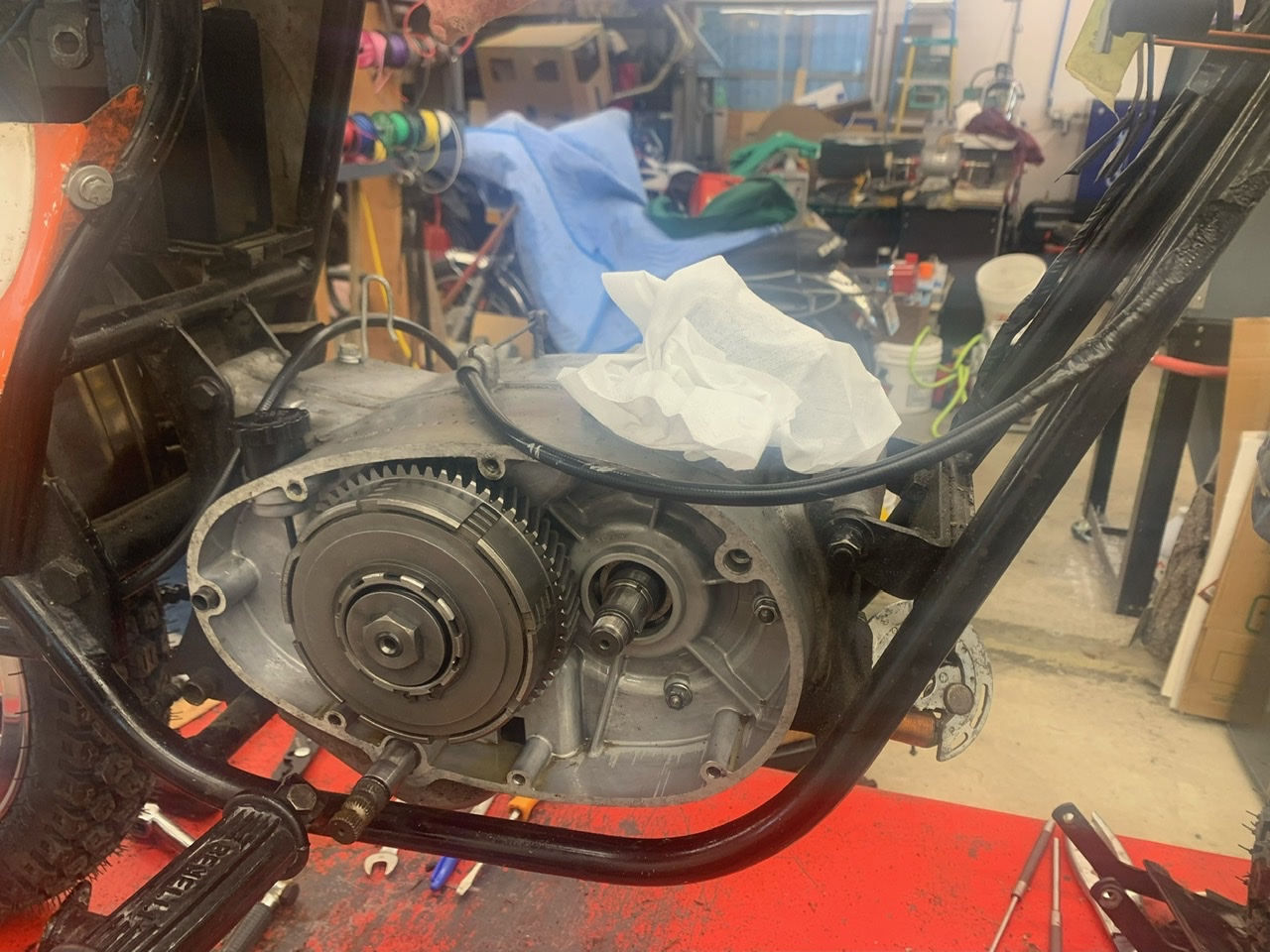

Postby Lotus54 » Sun Nov 13, 2022 5:59 pm
Yes, it is a sickness. (John will understand).
It started running poorly, and I was very suspect of the old crank seals. Since I was part way there anyway- I checked ‘dry’ side, then ‘wet’ side. I didn’t like either. And the exhaust port had a lot of carbon- so I pulled the head. Piston/head looked way too clean- decided to just pull cylinder and make sure how things look.
The cylinder studs need to come off to pull cylinder while in frame. First one came right out- second was stubborn and my stud puller taper was a little messed up. So start to setup lathe to clean up the taper- well the gibs were off and had to take things apart, clean and adjust (due anyway). It is a tiny lathe and needs all the help it can get.
Cleaned up taper and and heated stud- then it came out (an hour later of course).
Vaporhoned cylinder- looks pretty good, piston/rings looks like new. I think maybe some moisture was in it when it sat though.
I’m in the process of cleaning everything, replace crank seals etc.
Oh yeah, the carb needle is toast too. Haha (All good, I wanted to see condition anyway)

Postby John H » Sun Nov 13, 2022 9:24 pm
Does the clutch use the same oil as the gearbox? Just looking at the hole behind the clutch.
Yep, they run better with new crank seals.
