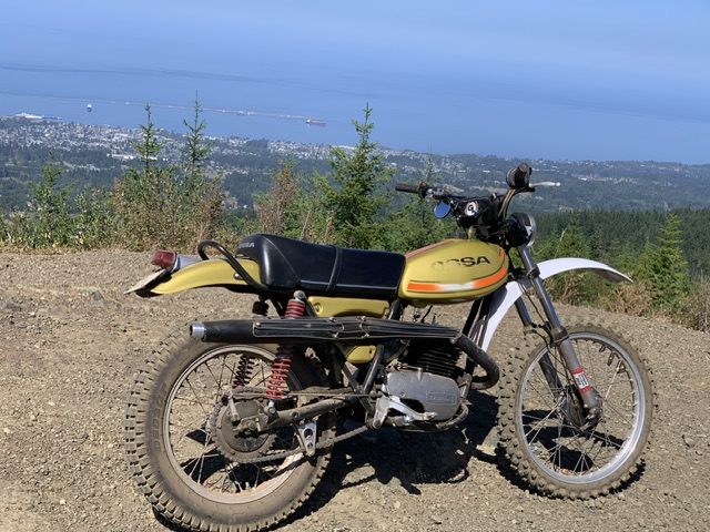

I took the Super Pioneer out today.
Went up Mt Angeles rd and up on the overpass, up the old burn and onto Foothills. I rode a bunch of the new trails since I’ve been there last. The Trials area is a clear cut- so we all lost much interest.
All easy trails but still fun. Went to the new parking area, then up one of the new routes and back over the Mt Angeles rd.
Great ride (now I have to figure why the lights quit working- likely a broken wire, bad connection or switch.

Definitely looks like a fun ride. What is the difference between the Pioneer and the Super Pioneer?
Re: OSSA Super Pioneer
Postby Lotus54 » Sat Aug 19, 2023 9:52 pm
The Super is MUCH lighter.
Differences as far as I know;
Phantom type frame
New porting
Better forks
Phantom seat (much better).
It weighs 205 lbs and snappier than the regular Pioneers. Still a lot of low end power but they handle better.

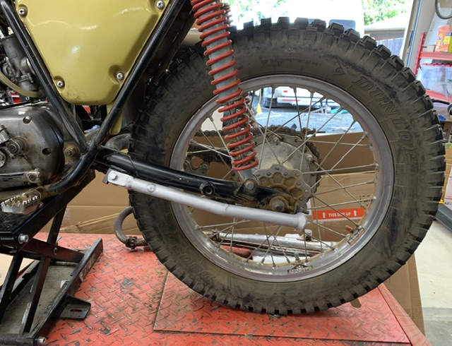

The sidestand on the SP was too short (and bent), heavy (steel) and the foot was big enough to catch on things.
So I made up an aluminum one. Half the weight, proper height and tucks away nicely. Not as strong, but should be adequate.
I made the pivot out of a solid square of 6061, then some same tube I had- foot was rod I cut and turned to fit. The spring pin I turned from a solid rod also.
Yeah, spent too much time, but I like the way it turned out.
