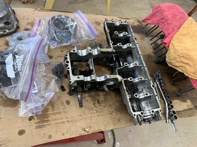

Postby Lotus54 » Tue Feb 04, 2020 9:19 pm
The shaft for the estart and morse chain is out in pic.
It is coming along pretty well. I still have some things to finish on the garage, but I’ve been taking the engine apart to verify what I will need to get it back up to snuff. I’m gong to do more than I originally planned, but may was well do it when it is apart.

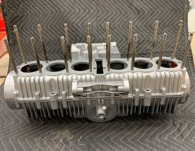

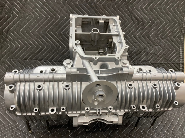

Postby Lotus54 » Mon Feb 10, 2020 11:01 am
I took my cases to be vapor honed- they came out great!

Postby John H » Mon Feb 10, 2020 11:35 pm
Is the blaster local? Soda blast just doesn't look that great. My unit was originally a vapor blast unit for dentist labs. It was
converted to dry by the mfg so no going back.
Re: Benelli 750 sei
Postby Lotus54 » Tue Feb 11, 2020 7:36 am
The person is in Shelton.
I have a small unit, but not big enough for those long cases. I can do smaller stuff (or will be when I get it set up- I’m doing the air lines in garage now).
