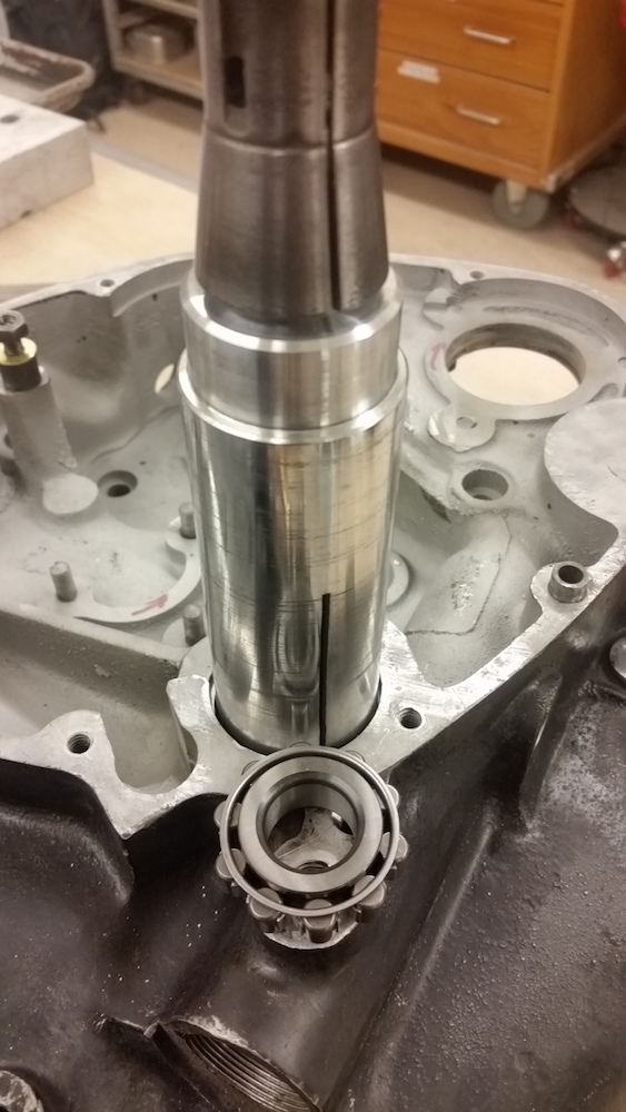

Postby John H » Tue Mar 05, 2019 9:02 pm
All the bearings and races are installed in the cases. One race went in tight so I had to make a bore lap to hone
out the race by .0015 thou. Back in the day, these engines were assembled by a craftsman who had access
to graded bearings that used the DOT method. Dot 0 being the least clearance and 0000 being the most clearance. After the race was installed the builder would choose which DOT was correct. Since certain bearings aren't available anymore honing is required. Just another time consuming step.

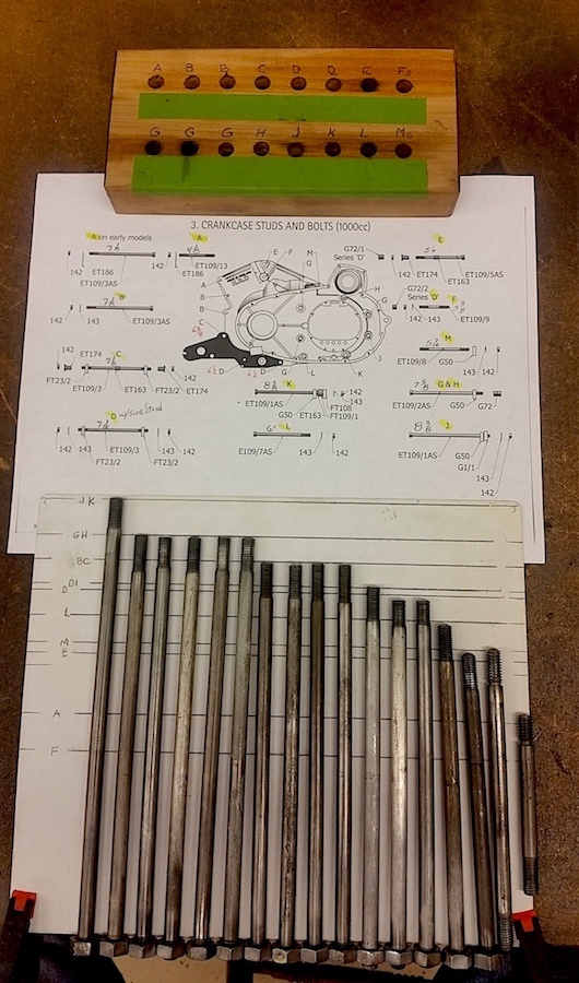

Postby John H » Wed Mar 13, 2019 10:23 pm
After several months of cleaning, repairing or replacing parts it's time to start assembling them. Hopefully won't have too many left over. How many bike engines have 17 bolts holding the cases together.

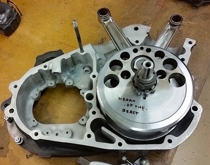

Postby John H » Mon Mar 18, 2019 9:34 pm
The heart of the beast is in place. Next will be the timing chest with cams, lifters and the decompression mechanism.

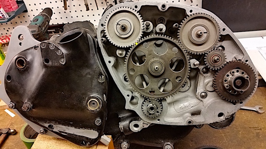

Re: Some Vincent projects for John
Postby John H » Wed Mar 20, 2019 9:24 pm
Setting gear lash is tedious. It starts by installing the cams (upper two gears) then the big idler which is on a bolted on spindle. The lash between each gear is set at .003". Next is the small crankcase breather gear that also meshes with the magneto gear. This gear comes in different sizes from -.006" to +.006" to get the correct mesh.
Last is the half-time pinion gear on the crankshaft which also comes in different sizes from -.010 to +.010". in .002 increments. Of course then they all have to be timed correctly for the engine to run. The final setting is to choose one of the five key slots in the half-time pinion gear that advances or retards the camshaft timing. Advance for low end power, retard for top end power.
