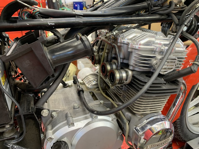

The bike sat quite a long time. I’m not sure when fuel was in it, or how long ago. When I first put some in, one carb overflowed- a tap on the bowl stopped it.
But the plugs also are very black and tend to foul.
So I popped the carbs off- cleaned out bowls (just a little bit of stuff in there, pretty clean) and jets. Then dropped the needles a notch.
I have not tried it yet- but will see if that gets mixture better. It would run great until the plugs got too much deposits.
