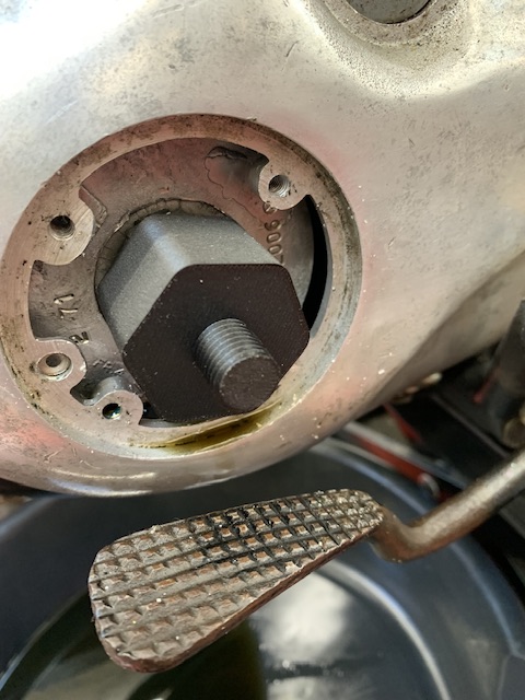

I got the points plate and advance mechanism removed. The replacement rotor/magnet is a taper fit also, so needs to be installed with proper timing. (Or pretty close, I think some adjustment on the plate it possible).

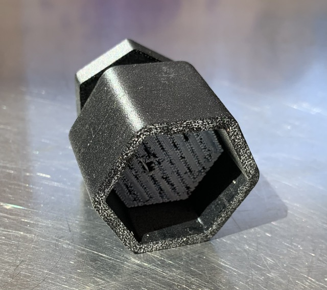

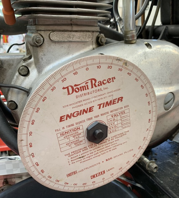

Trying to figure a way to mount a degree wheel was interesting. If primary case was off it would be pretty easy to use the rotor mounting nut. But I don’t want to remove all that just to set timing. So I designed a nut that would be a tight fit over the big rotor nut- then have a threaded part sticking out. The degree wheel will slip over that and another nut on the outside.
I am 3D printing it right now in PETG CF. I think it will be strong enough to turn it as long as sparking plug is out and I do not tighten the degree wheel holding nut down too much. Time will tell.
I will take some pictures of the part in place, since it likely doesn’t make a lot of sense.

This is first one- I made it a bit longer for second to make easier to put a wrench on. First try printing open wrench flexed too much- so I will make an enclosed one I think.
