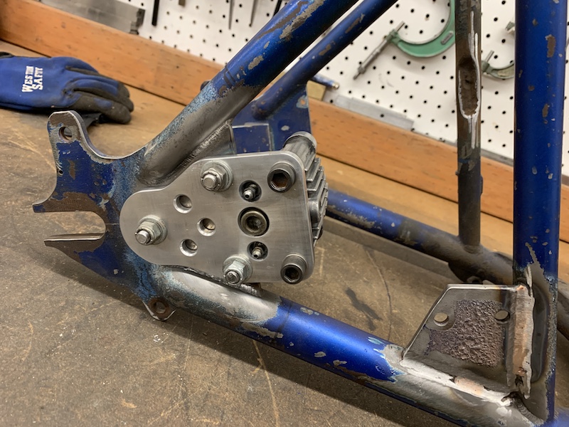

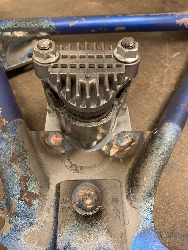

The frame is modified and the bracket is finished. Well, there's a problem now. The slick is 6" wide and doesn't want to clear the caliper. This frame was made back in the day when a 4" slick was the only tire available. Luckily I have a NOS Avon 400-18 still wrapped in paper from the 60s. It has a few aging cracks but perfect for this project. It's off to the powder coater.
Still searching for a Hurst Airheart pill box master cylinder to finish up the brakes.

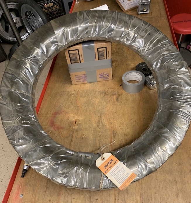

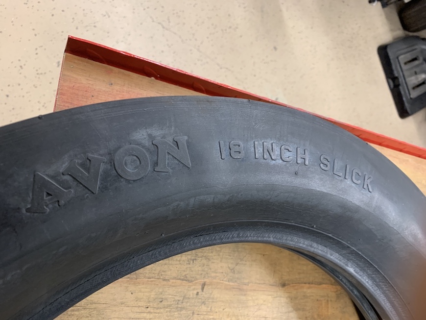

I dismounted the old road race slick from the rear wheel and brought out the rare NOS Avon drag slick which is close to 50 years old. It has a few cracks and is a bit hard but can't expect to ever find another one so will carefully mount it and hope for the best. If it becomes a struggle I may take it to a bike shop to get the job done.

I got some ‘cast off’ tyre warmers from a track person upgrading. Warming the tyre up well with it makes a big difference (lots of Rugyde too).

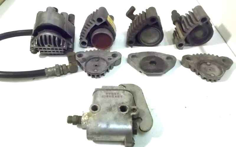

$650.00 is a bit out of my price range. Larry thinks he may have scored a master cylinder which is all I need, will know soon.

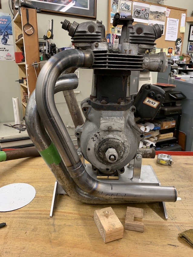

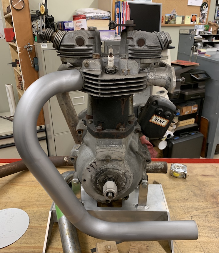

Today I made up a exhaust pipe to replace the missing one. I bought Hooker U-bends and disappointed in the quality as the bend was not a true circle like they use to be. This makes it difficult to blend a straight piece to the bent piece.
It's not nice enough for chrome plating so will blast the other 3 pipe and either wrap them with heat tape or put hi-temp paint on them.

Mark, thanks for the tire warmer offer. As for now I have a inflated tube in the tire and am rubbing it down with Black Again, a preservative used by antique car collectors.

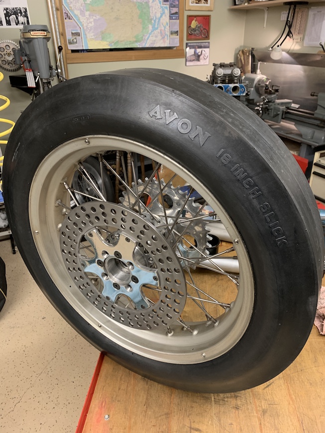

After busted knuckles and some swearing the slick is mounted.
It looks much better than the old road racing tire.
